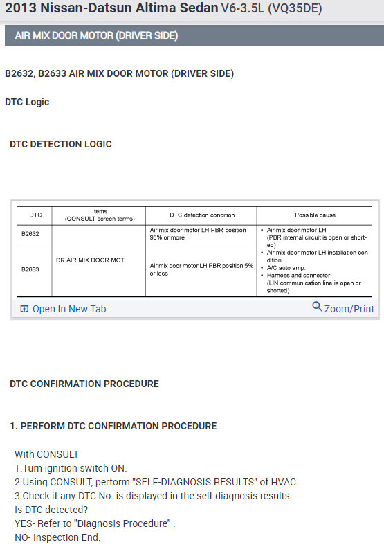

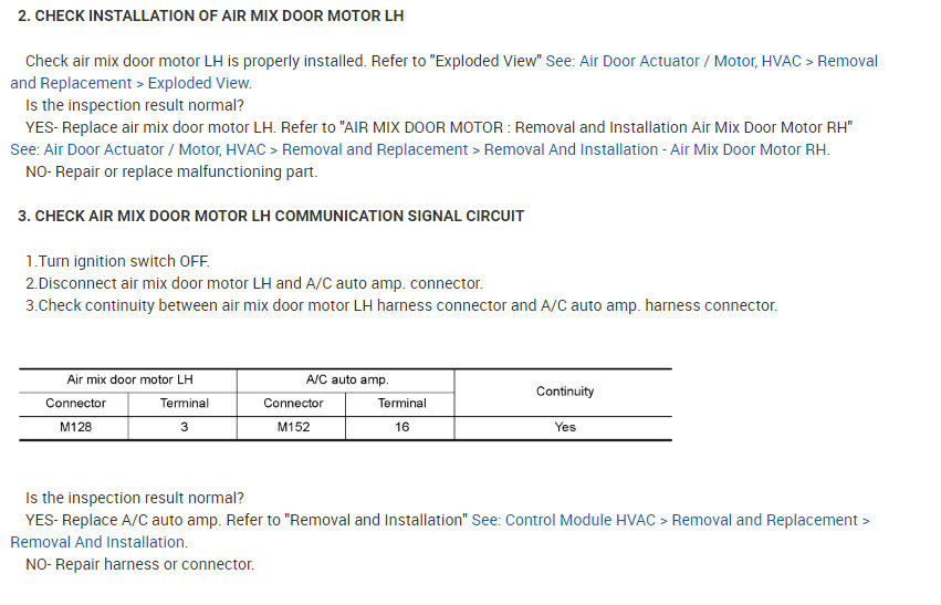

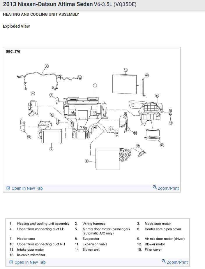

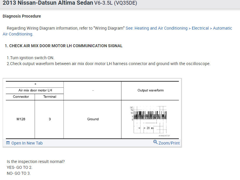

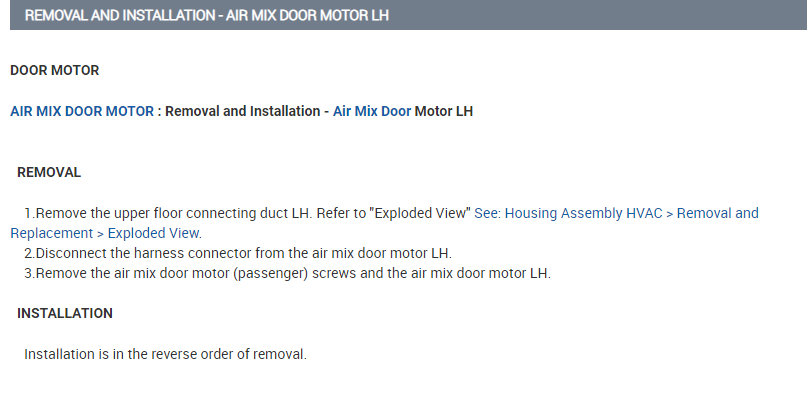

If your car has dual zone climate control, it does sounds like a possible faulty blend door actuator.
I have attached the testing procedure for the driver side blend door actuator/motor, also the replacement instruction.
