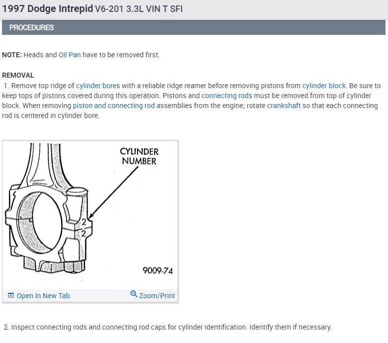

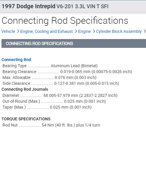

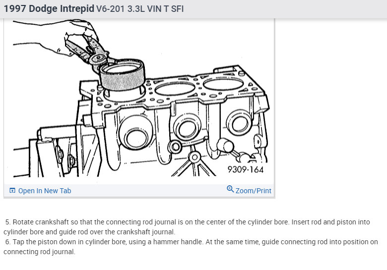

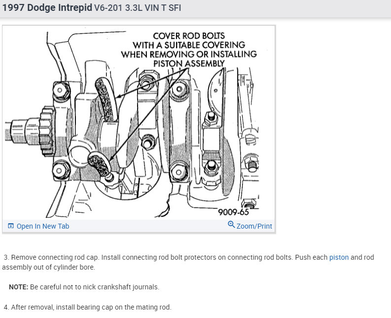

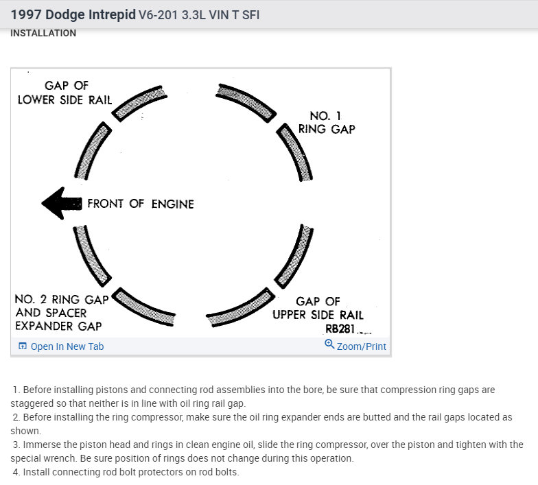

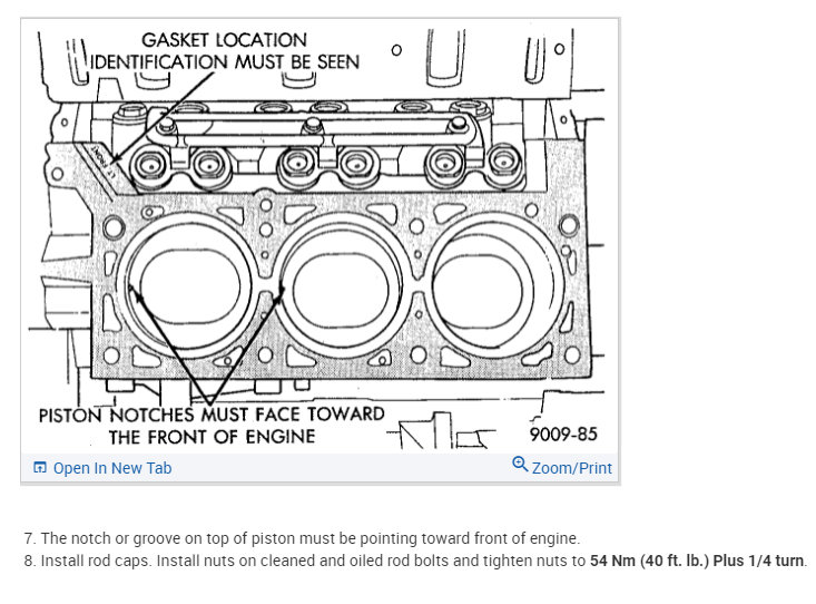

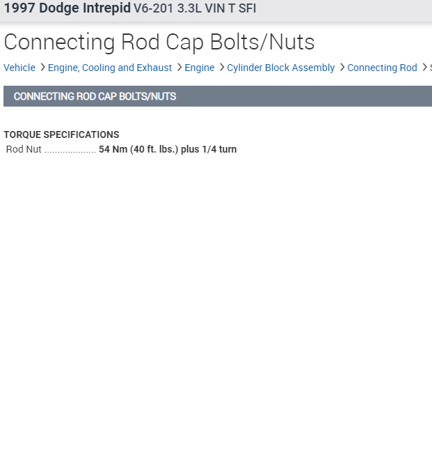

What are the torque specs on the car listed above? (Connecting rods)
Jan 25, 2022 at 9:30 AM
SQM
Experienced Mechanic
6,383 POSTS

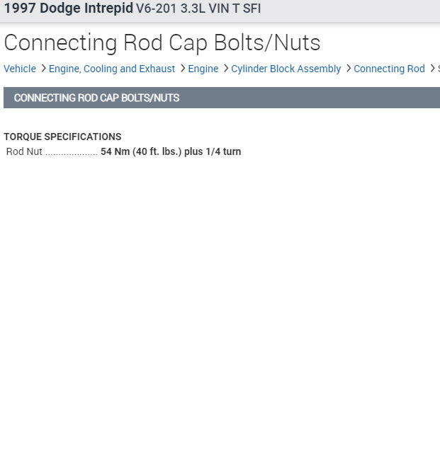

The torque specifications for the rod nut is 54 Nm (40 ft. lbs.) plus 1/4 turn.
Here is a helpful video:
https://youtu.be/juOClONIWeY
