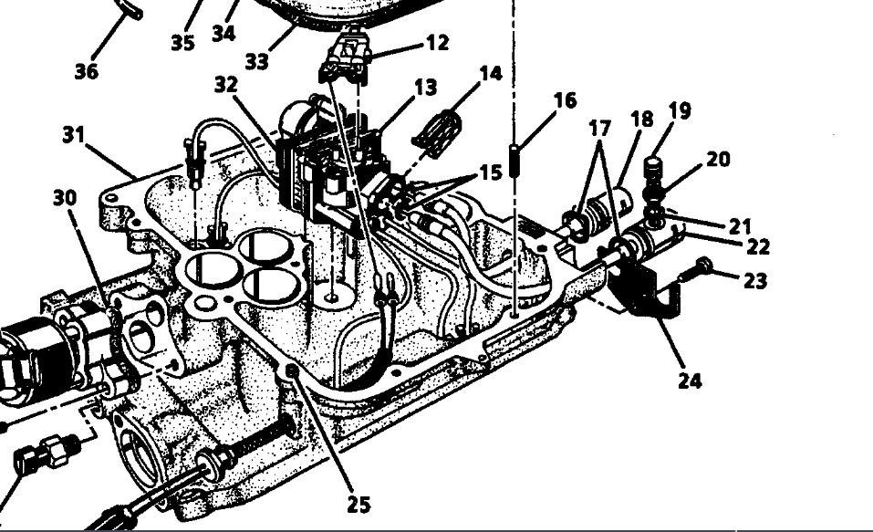

In what order does the poppets go from spider injector
360,000 MILES • 4.3L • 6 CYL • 2WD • AUTOMATIC
DLZ
I removed my old spider without marking where the poppets go.
Jan 18, 2019 at 3:51 AM
Good afternoon,
The new spider has the poppets on them and they fall right to the correct cylinders for installation. Check out the diagrams (Below). Please let us know what you find.
