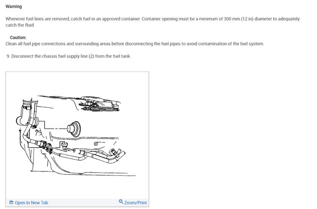

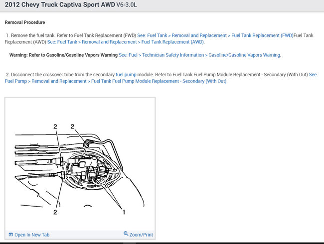

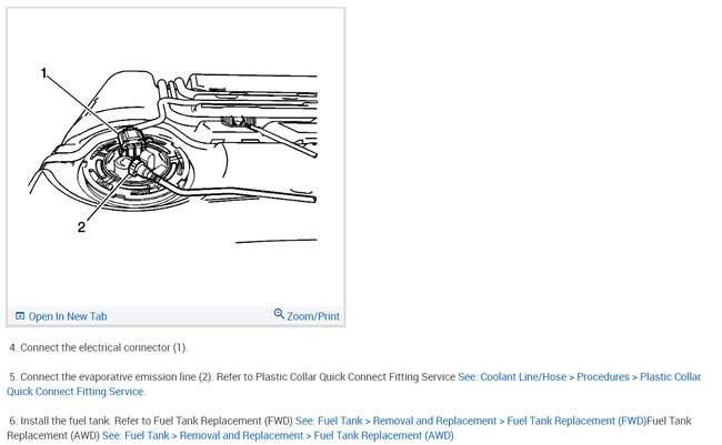

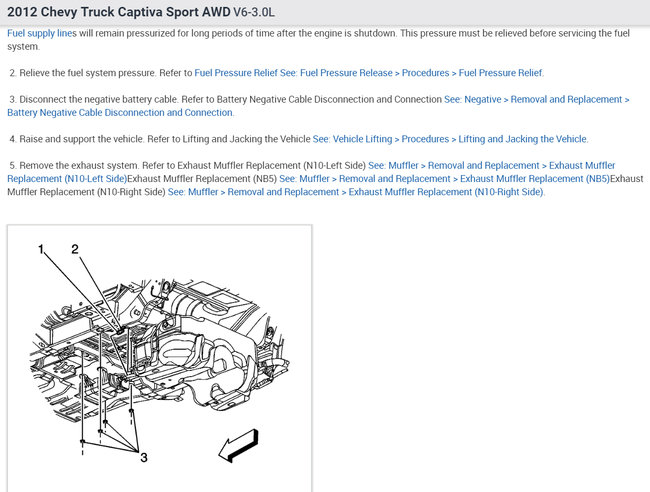

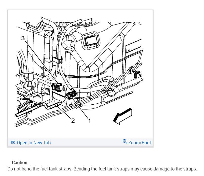

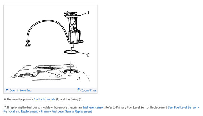

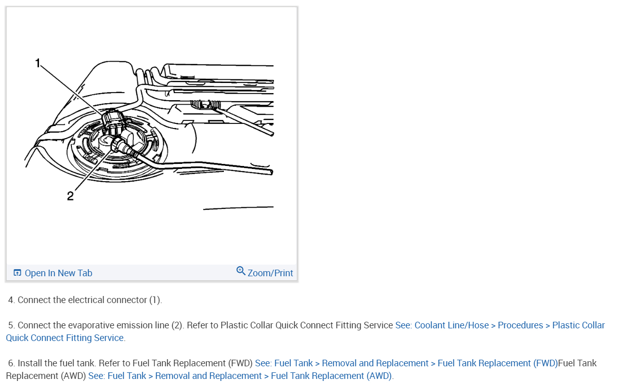

In tank diesel pump not working. Can I change the in tank diesel pump with an outside inline electric diesel pump?
Feb 21, 2019 at 4:24 AM
  • 55,743 POSTS

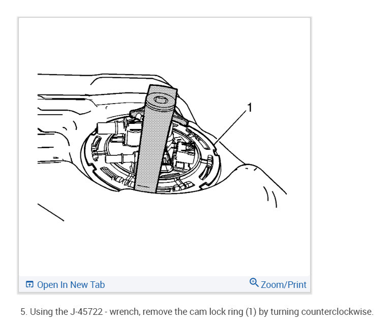

You cannot install an aftermarket pump outside the tank. Here are questions and diagrams on how to change out the fuel pump with a video showing how to drain the tank before you begin:
https://youtu.be/Q5MH2gnyFH0
Feb 22, 2019 at 5:07 AM
CAPETOWN

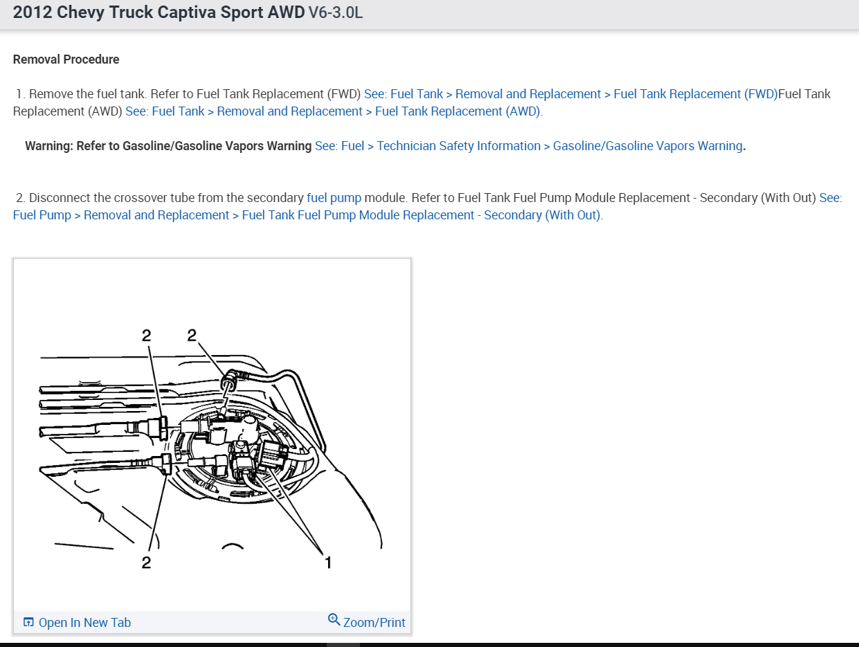

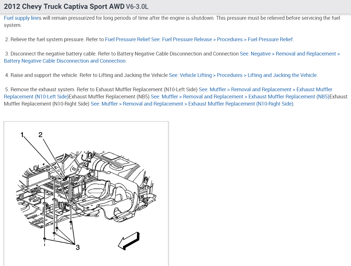

I need to remove the diesel tank to replace the defective in tank diesel pump. Must I remove the prop-shaft also because this car is a 4wd? Apart from the fuel pump relay is there a fuse also?
Feb 25, 2019 at 4:31 AM (Merged)
  • 55,743 POSTS
Yes you will need to remove the drive shaft before you can get the tank out. Here are guides to help you get started:
https://www.2carpros.com/articles/how-to-remove-a-drive-shaft
and
https://www.2carpros.com/articles/how-to-replace-an-electric-fuel-pump
