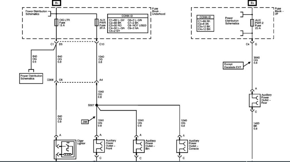

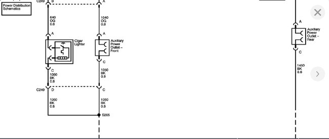

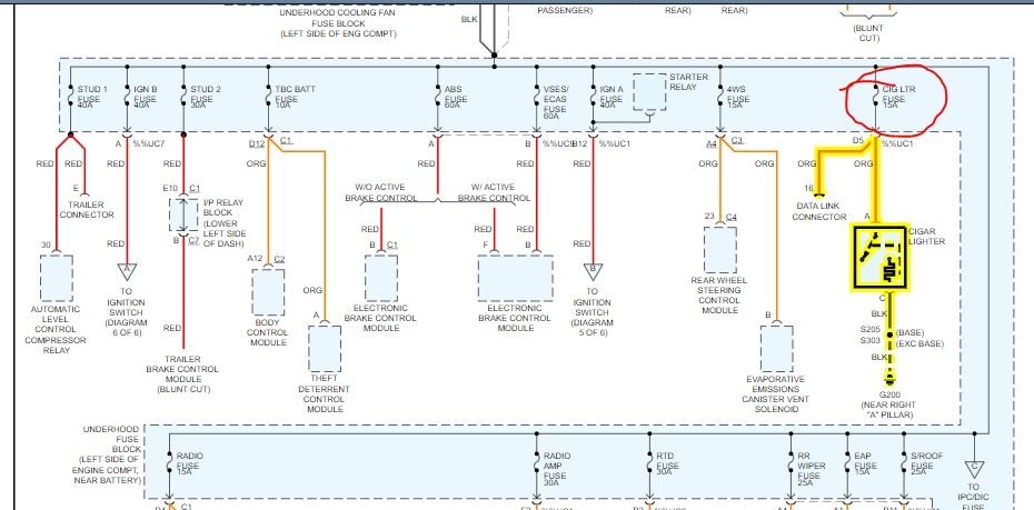

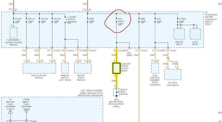

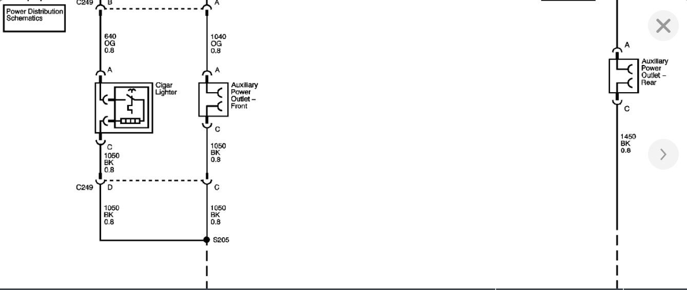

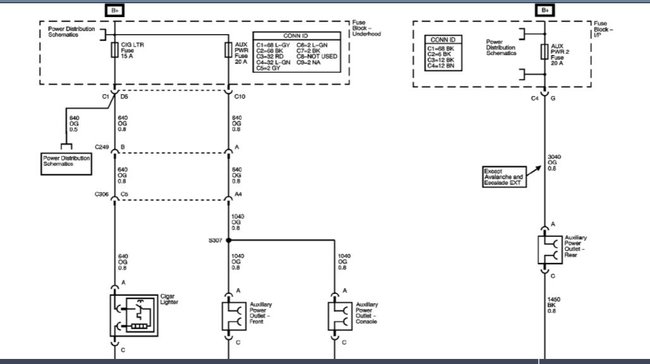

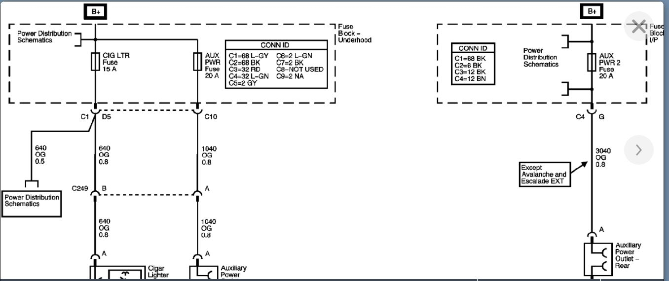

I need to figure out where the orange power wire goes for the front cigarette lighter port. Vehicle listed above is an XL model.
Sep 23, 2021 at 1:03 PM
Experienced Mechanic
52,796 POSTS
Good afternoon,
I attached both the color and a black and white diagram for you.
