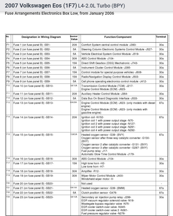

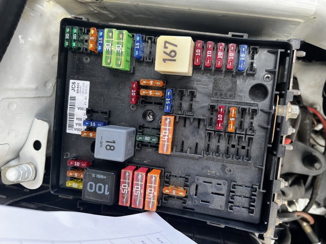

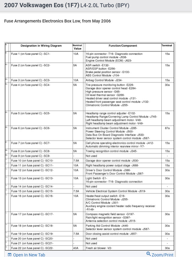

I was searching everywhere for different fuse diagrams for my model of vehicle but cannot find any of them that actually solve the issues that I am having. The car was working alright before any attempts to fuse changes were made. I looked into this and didn’t realize just how many different layouts there were for my car based on packages included. I need the fuse layouts for under the hood and inside the dash, please. The VIN for my vehicle is WVWDA71F07V030509.
Mar 31, 2022 at 5:26 AM
SQM
  • 6,383 POSTS

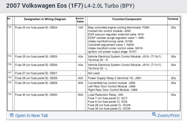

I have attached the fuse diagram below for your reference.

The fuse diagram for the box in the engine bay is different from the layout in mine. Is there another diagram for me to follow? I’ve searched and seen many different diagrams for my car model and was looking to try and get something as close to the one for my VIN as possible. Thank you!

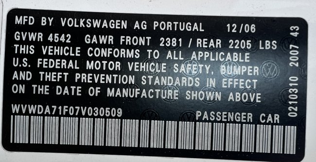

What is the manufacture date on the door of the vehicle?
Apr 2, 2022 at 1:42 AM
OBTREV
  • 6 POSTS
Here’s the information.
Apr 2, 2022 at 7:39 AM

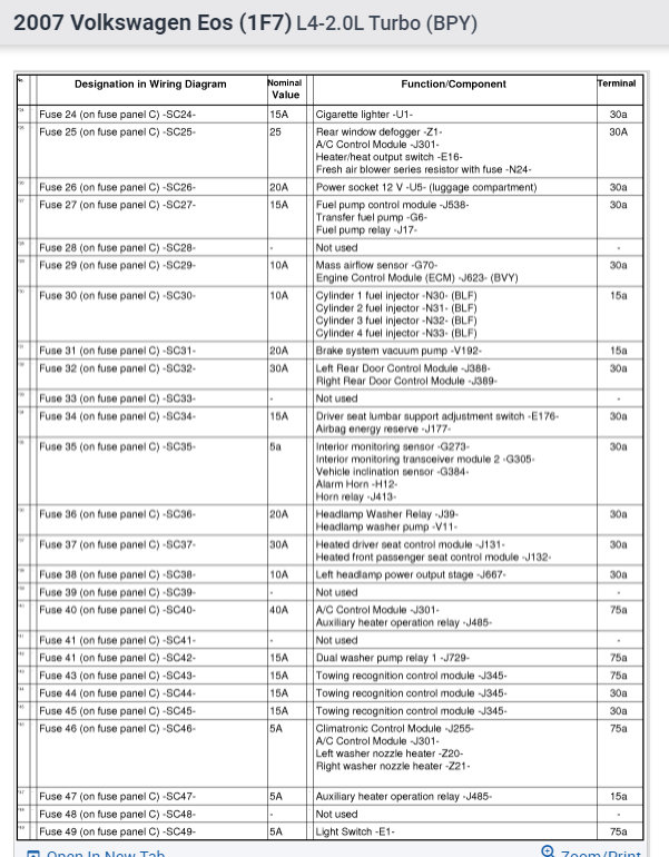

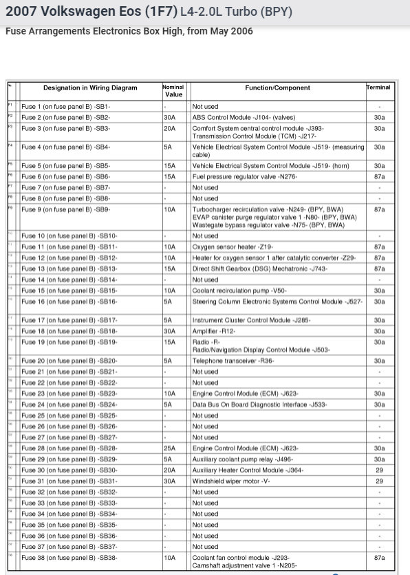

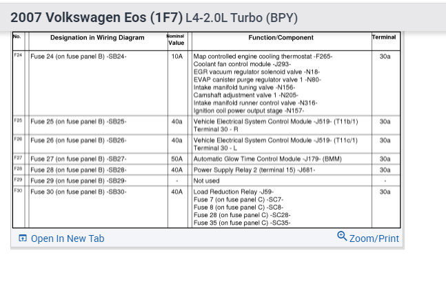

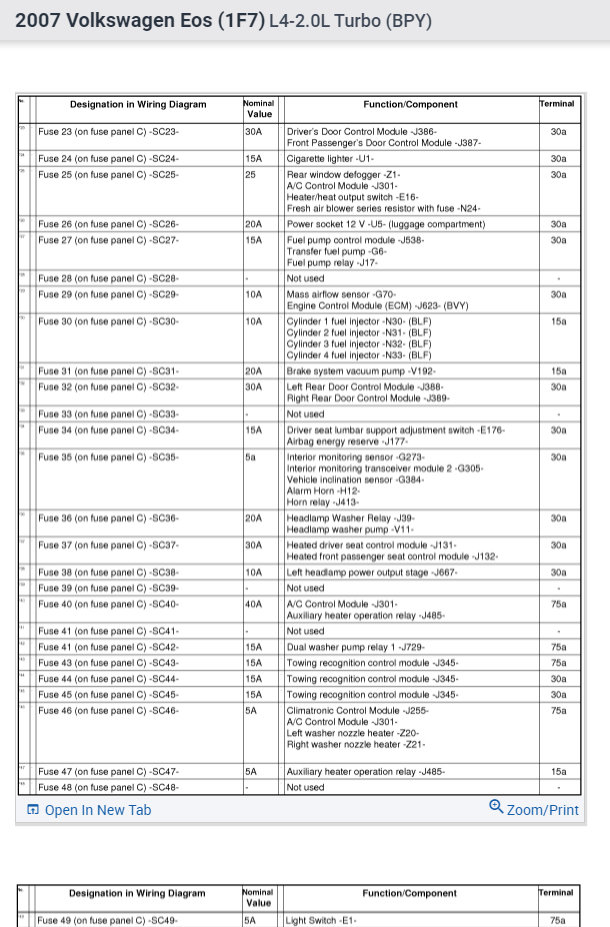

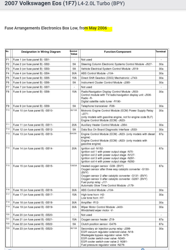

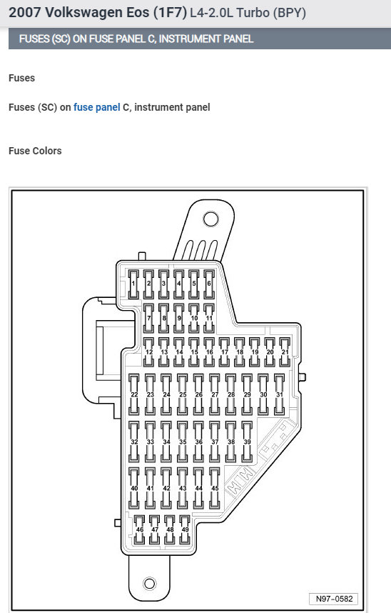

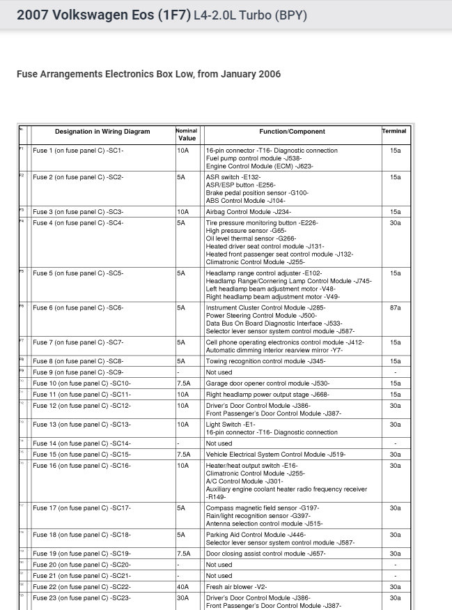

Take a look at the images below. First two show the fuse arrangements for under the hood fuse box and the second two inside the car.
Let me know if this helps.

Looking at the diagrams you’ve sent, the arrangement for the one under the hood doesn’t match the one found in my vehicle.

Is your vehicle US or Euro spec?

The vehicle is US spec.

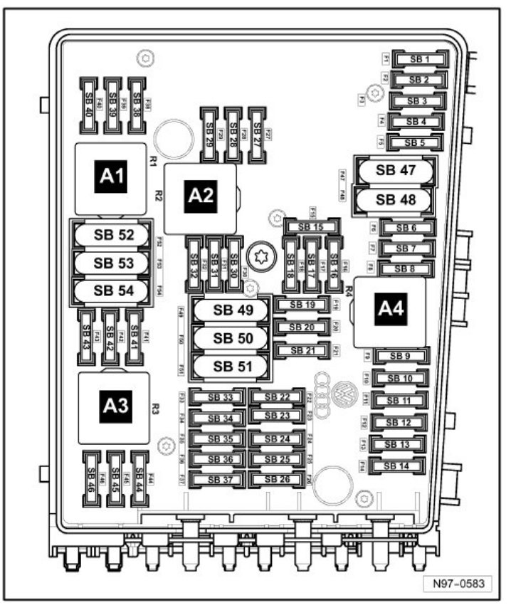

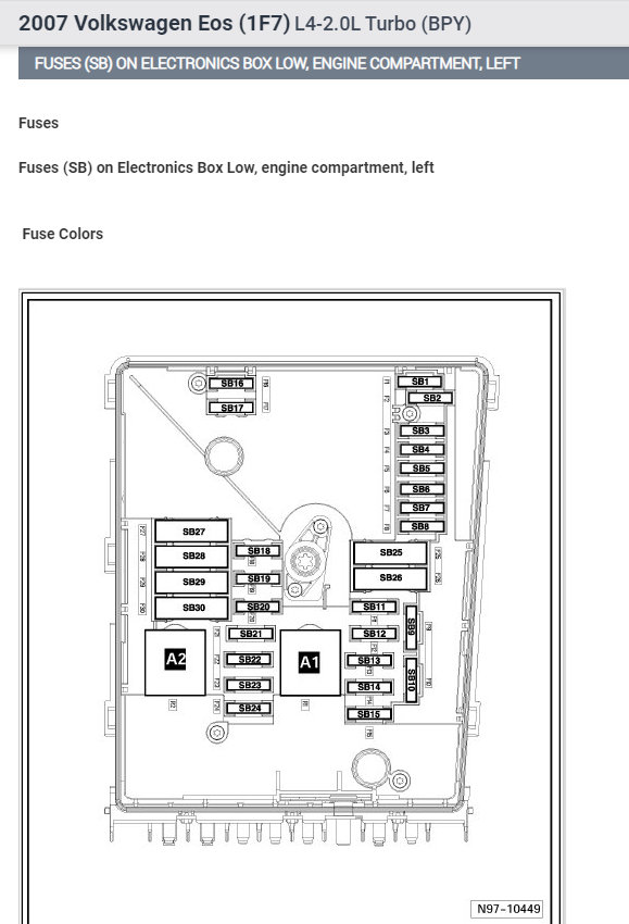

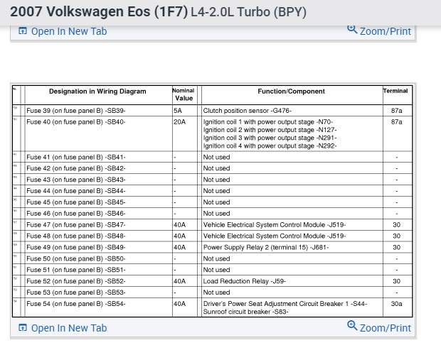

See the diagrams below.
Apr 11, 2022 at 2:10 PM
OBTREV
  • 6 POSTS
Hello again! Thank you very much. After following the diagrams provided, I was finally able to locate and install the needed fuses. A quick jump and my car is back up and running again. Thank you again!
