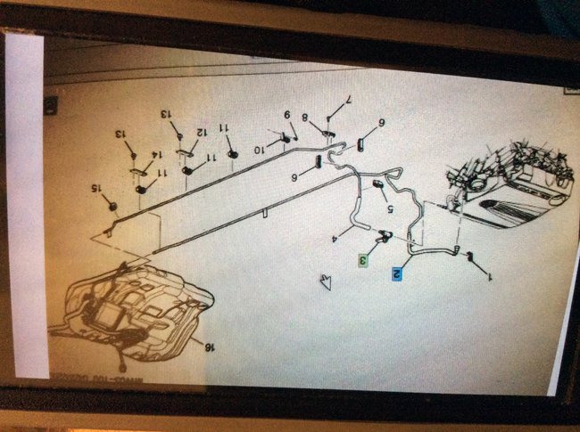

My problem with the vehicle listed above is as follows: I need a fuel feed pipe (GM #15923815) and an emissions pipe (GM
#15834004). I was told that they are not available and GM no longer makes them.
Do not know what to do. Really do not want to junk my well maintained, otherwise good running auto. Maybe you have a solution?

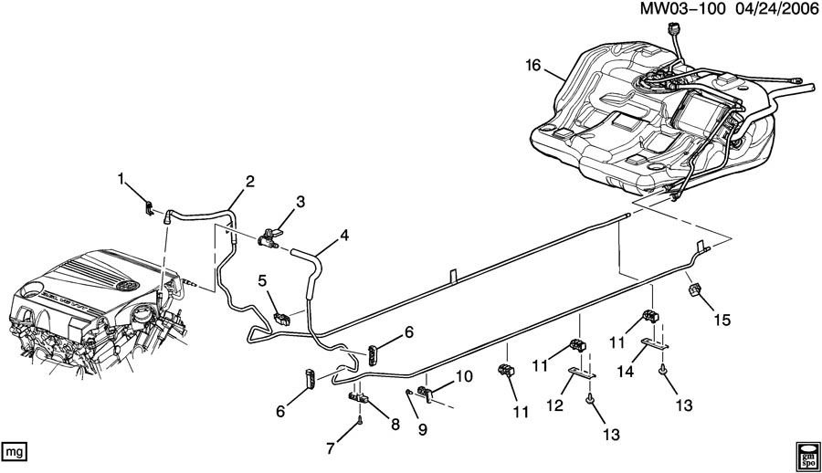

I need a fuel feed pipe and an emissions pipe. Reproducing the metal tube is not necessarily the issue. What I cannot find is/are the plastic tubing that connects to the tube and connects to the gas tank.

Roy - items 2 and 4.
Those are simple to make out of the proper tubing and connectors. Most decent independent shops can make them or you can buy the correct connectors and tubing and form them yourself. If it is a small part of the line you can repair just that section.
