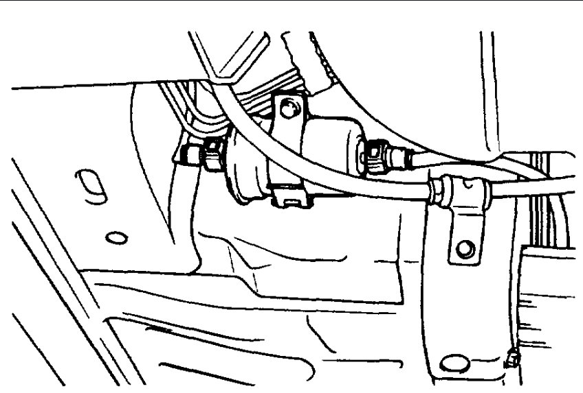

I cannot locate the inline fuel filter for my vehicle listed above (L).

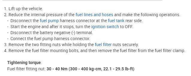

The fuel filter for your car is located at the left front corner of the fuel tank.Here is a tutorial showing what is involved to replace:
https://www.2carpros.com/articles/how-to-change-a-fuel-filter
I've attached a picture of its location and steps on how to replace below.Hope this helps and thanks for using 2CarPros.
