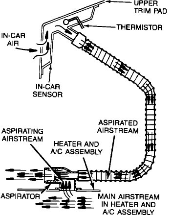

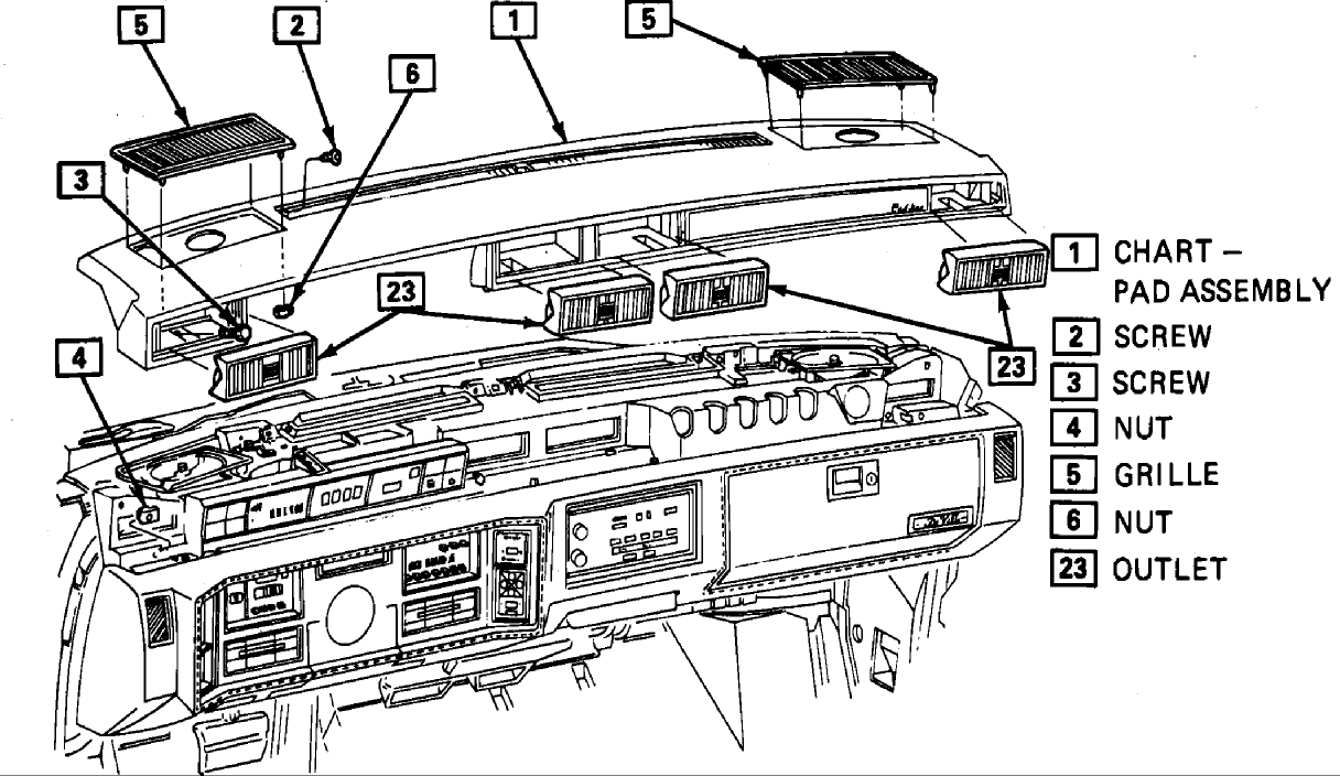

Hello, here is my problem, I have an F-13 code on my car, which means "in-car temperature sensor circuit", but I cannot find, where this sensor is located. My heating ventilation has stopped working. if I change this sensor, my ventilation does it come back, yes or no? I also have an order F-48 refrigerant system problem, but my ventilation was still working with this code before. why now nothing works? to help me to be able to start my ventilation what to do? Thank you.

The sensor is hiding in plain sight. It is behind the Cadillac emblem on the upper trim pad. To get to it you remove the instrument panel top cover, unscrew the screw holding the sensor, disconnect the aspirator hose and the electrical connector and swap it out.
