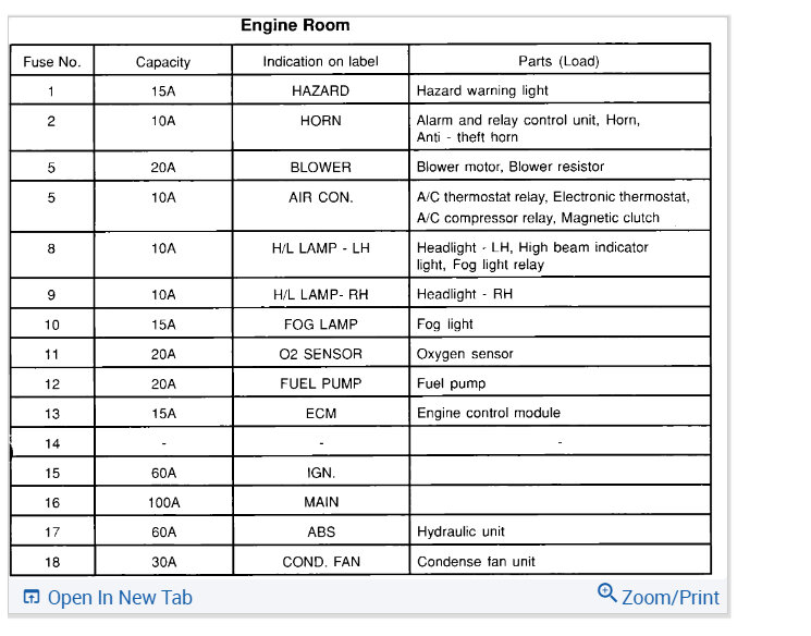

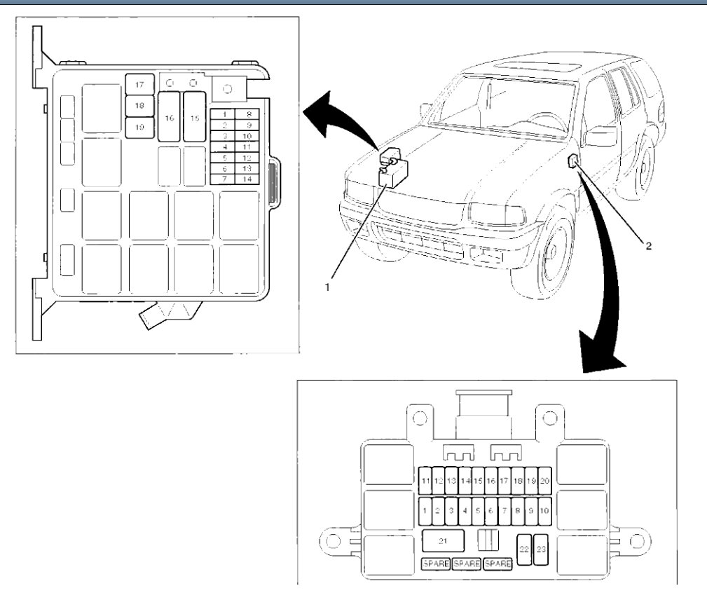

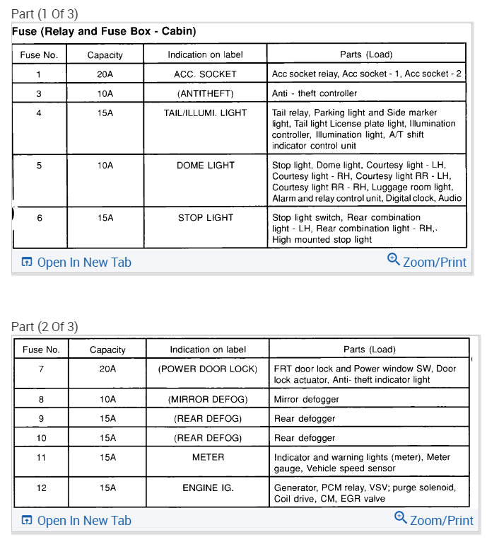

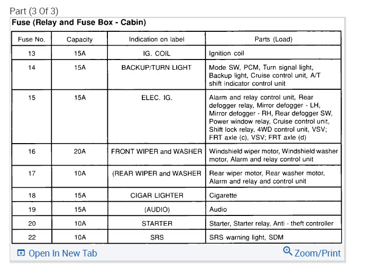

I need fuse box diagram for drivers side dash
May 29, 2023 at 5:52 PM
Experienced Mechanic
55,658 POSTS
Sure, here is a guide to help test the fuses and the fuse labels and location in the diagrams below:
Check out the images (below). Please let us know if you need anything else to get the problem fixed.
