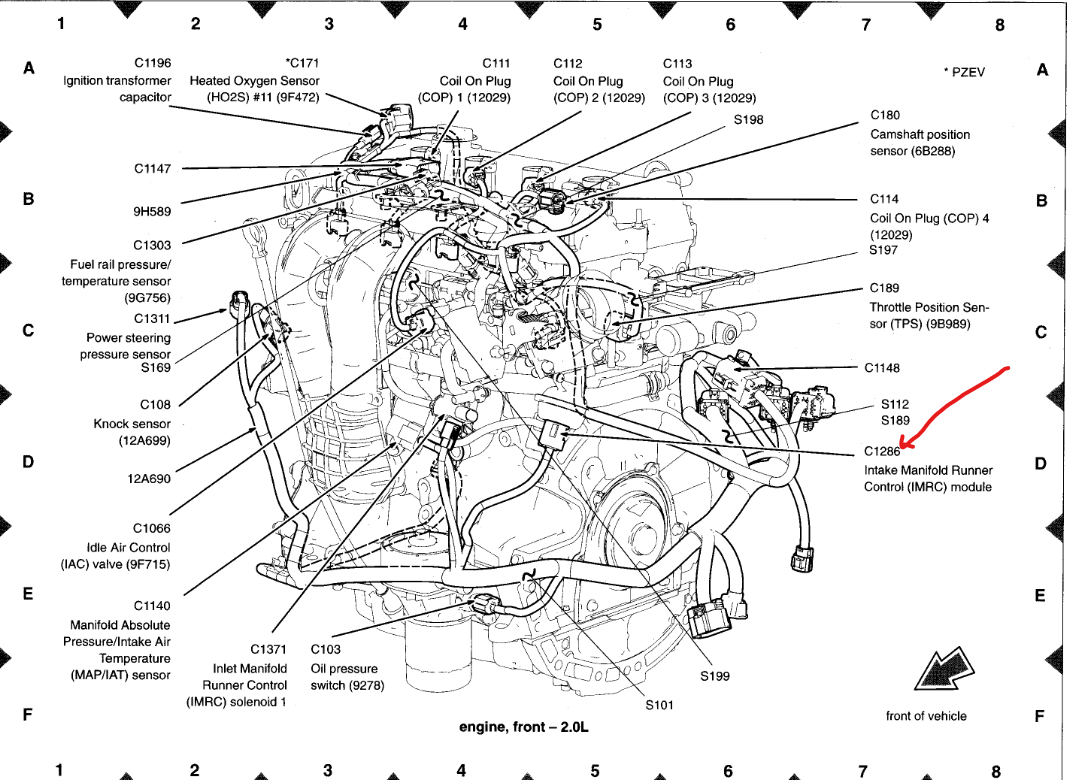

The bottom hose on my imrc valve looked like it was cut or something and was throwing a P2004 code so I went to replace it, and I cannot find the other point where the hose connects.

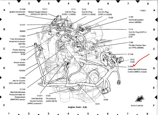

The top hose: usually goes to the intake manifold vacuum source. Bottom hose: goes to the IMRC actuator diaphragm or control valve.
P2004 - Intake Manifold Runner Control (IMRC) Stuck Open (Bank 1)
Here is a diagram that shows the hoses. Check out the images (below). Let us know how it goes. Please upload pictures or videos in your response.
