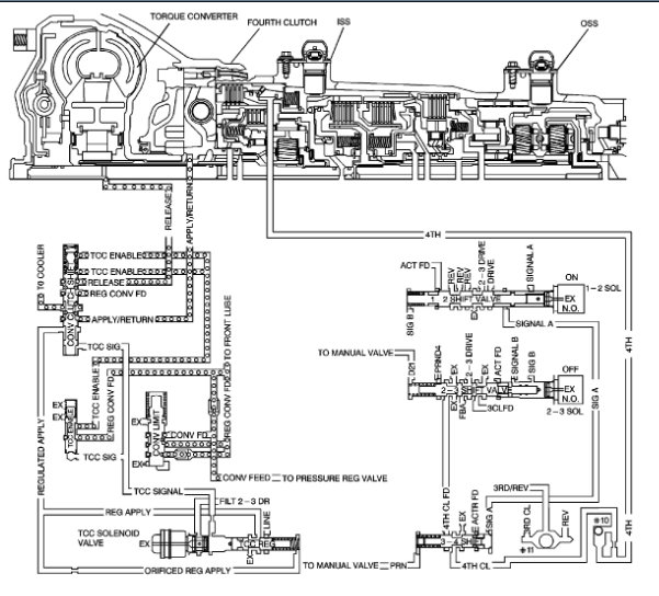

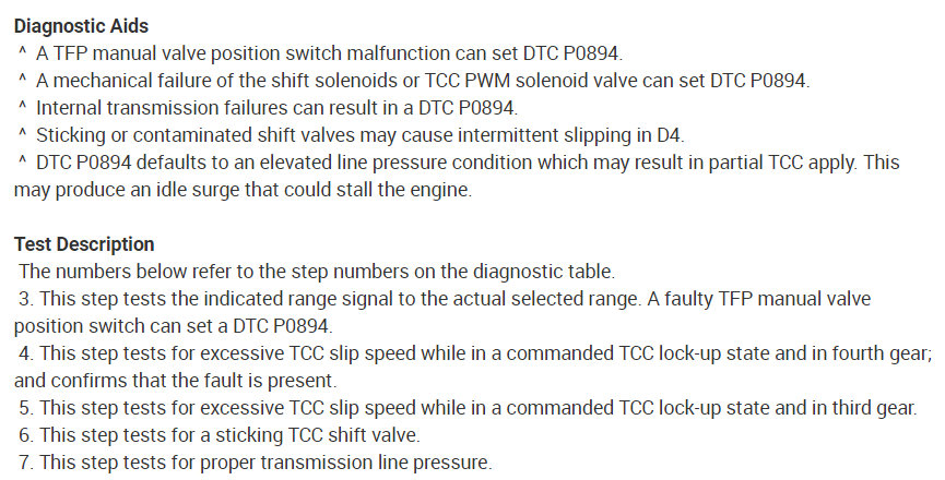

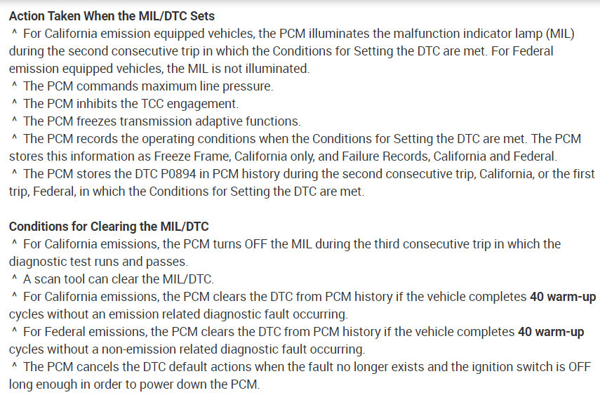

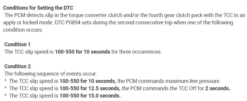

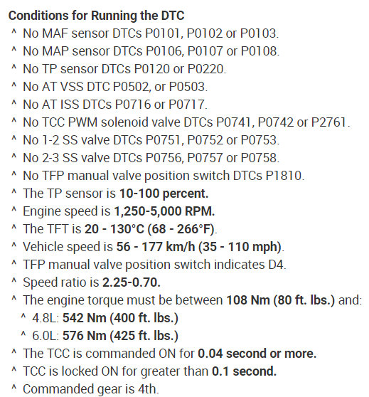

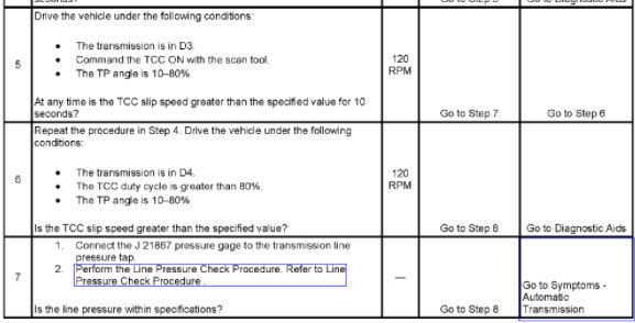

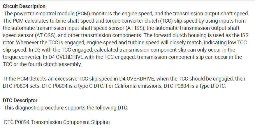

My vehicle listed above is an Express 3500. recently has stopped locking the torque converter when cruising. And it started jerk into every gear as if it were a manual transmission and I had dumped the clutch. After researching it, the jerking into each gear is a result of the P0894 Transmission Component Slipping code. After thoroughly inspecting it, I found that the transmission cross member is covered in ATF coming from the top vent. This leads me to believe that the torque converter has overheated and spit all its fluid out.

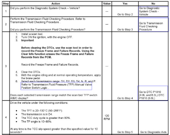

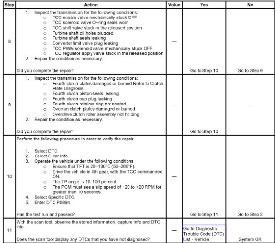

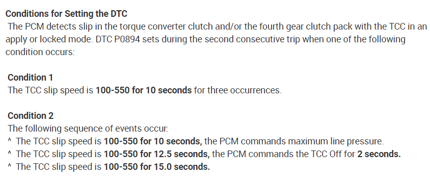

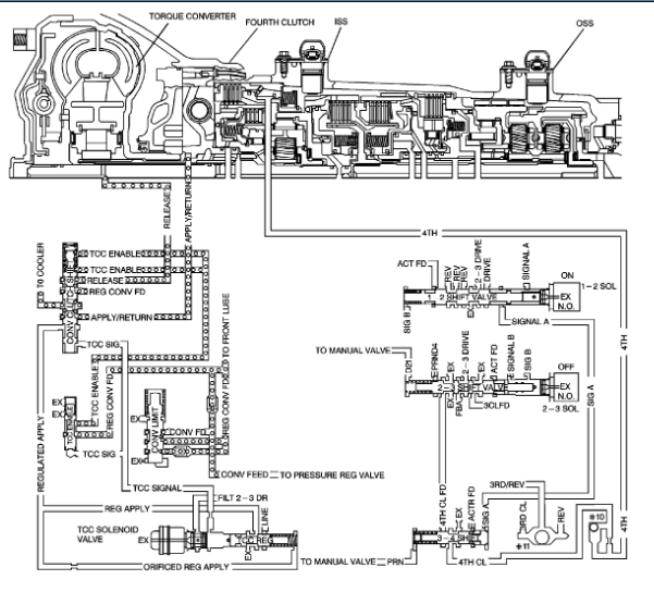

I've attached picture diagnostic steps below relating to the transmission code you have P0894. If you want to give me your vans VIN number I can find out your converter size on Monday when my friends shop is open. Hope this helps and thanks for using 2CarPros.
