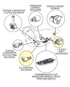

Mar 12, 2008 at 7:19 AM
BMRFIXIT
  • 19,053 POSTS
you gave me the engine size not the tranny is it 4L60E or 4L80E This is the location of your sensors and solenoids in relation to the tranny if you have not done a thing like this before may I suggest get few estimates tranny oil pan has to be removed and filter too good luck
https://images.2carpros.com/forum/automotive_pictures/99387_tranny_1.jpg
Mar 12, 2008 at 12:42 PM
IFCMEMBER
  • 15 POSTS
I think it was 4L80E. Thanks for your help. Last question, do you know if there is repair diagram for my car on line? So I can do repair myself.

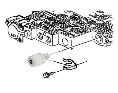

BMRFIXIT
  • 19,053 POSTS
You need the 2-3 solenoid order that then pull down tranny pan and replace
https://images.2carpros.com/forum/automotive_pictures/99387_tranny_2.jpg
Mar 15, 2008 at 10:50 AM
IFCMEMBER
  • 15 POSTS
Ok Thank you so much for your help. I'll try to do it next week and I'll let you know of my resoults
