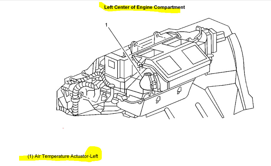

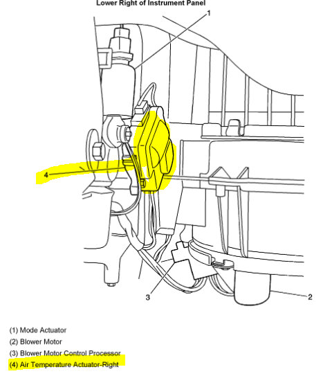

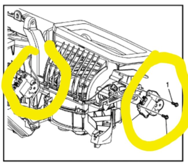

I bought 2 new door blend actuators for my car listed above.
AutoZone store indicated to me that this car has 2 door blend actuators in the parts page (2 per car). The actuators are the same AC Delco 15-74122.
My question, are the 2 actuators in my car located under the glove box?
Aug 18, 2024 at 7:39 AM
  • 110,251 POSTS
If the vehicle has dual climate control, yes, it will have two actuators. However, it is odd that both would fail at the same time. Are you unable to control the temperature on either side of the vehicle?
I attached two pics below. One shows the left actuator (driver's side) and the other shows the right side (passenger's side)/
Take a look and let me know if this helps.
