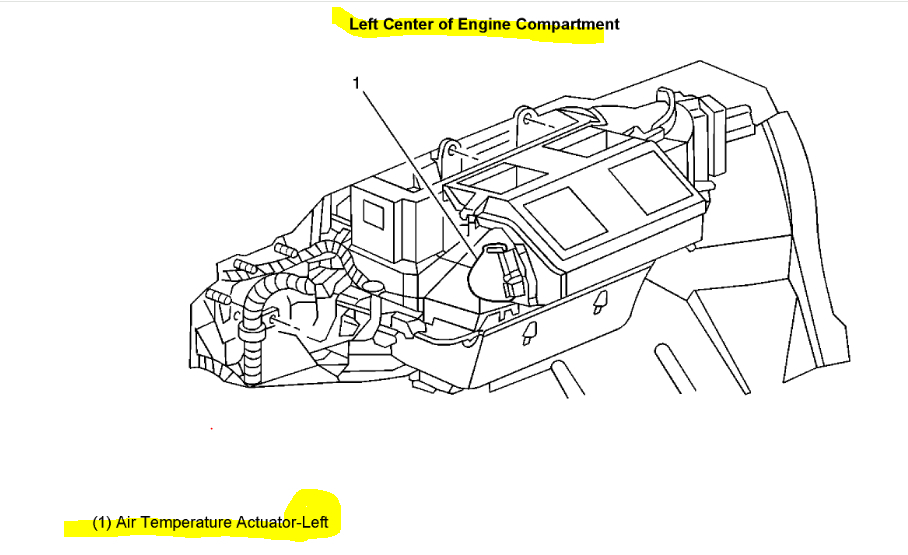

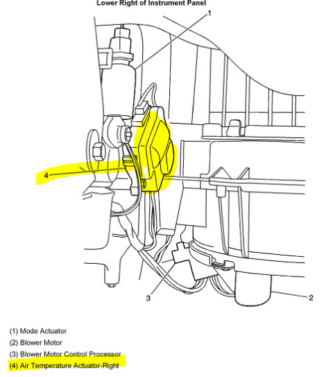

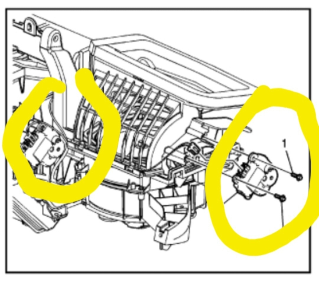

If the vehicle has dual climate control, yes, it will have two actuators. However, it is odd that both would fail at the same time. Are you unable to control the temperature on either side of the vehicle?
I attached two pics below. One shows the left actuator (driver's side) and the other shows the right side (passenger's side)/
Take a look and let me know if this helps.
