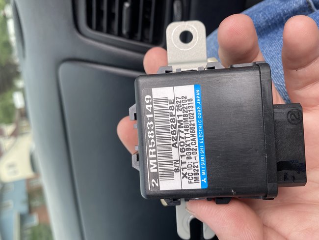

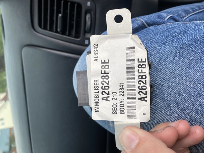

I’m not sure where the immobilizer unit is in the car. Can someone please explain to me where to find it? I need the serial number off of it.

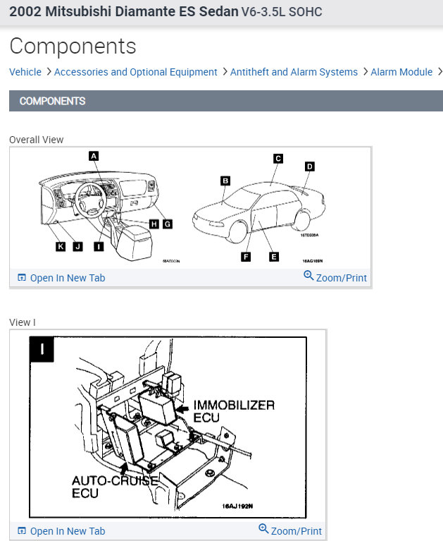

The immobilizer unit is located under the center of dash, forward of center console.
See attached diagram below.
Let me know of any questions.

I found it, but I called my nearest Mitsubishi dealership said they don’t have a pin for the S/N I provided.

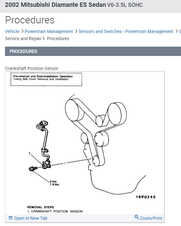

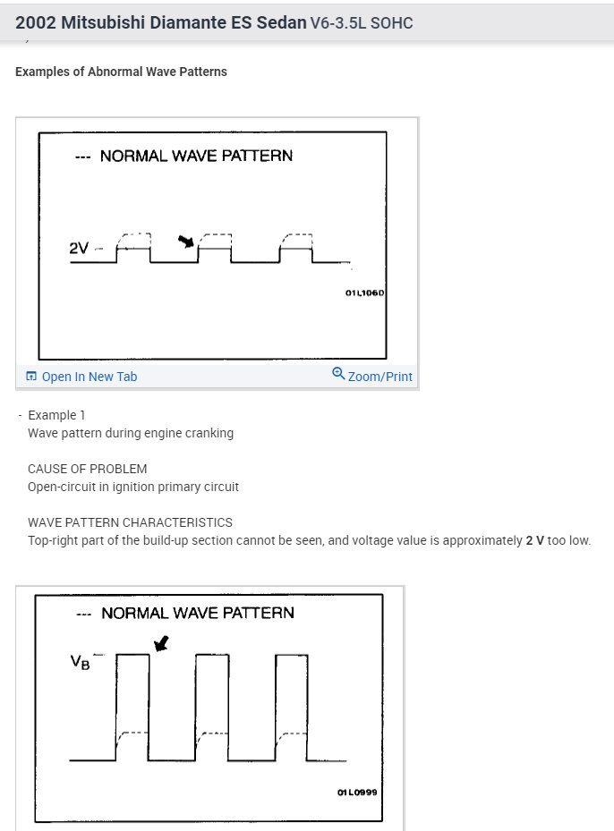

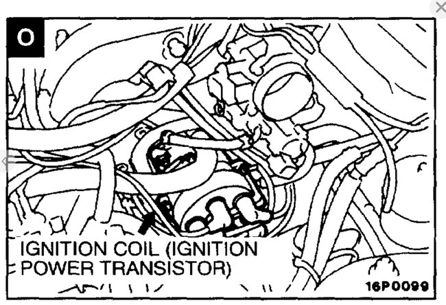

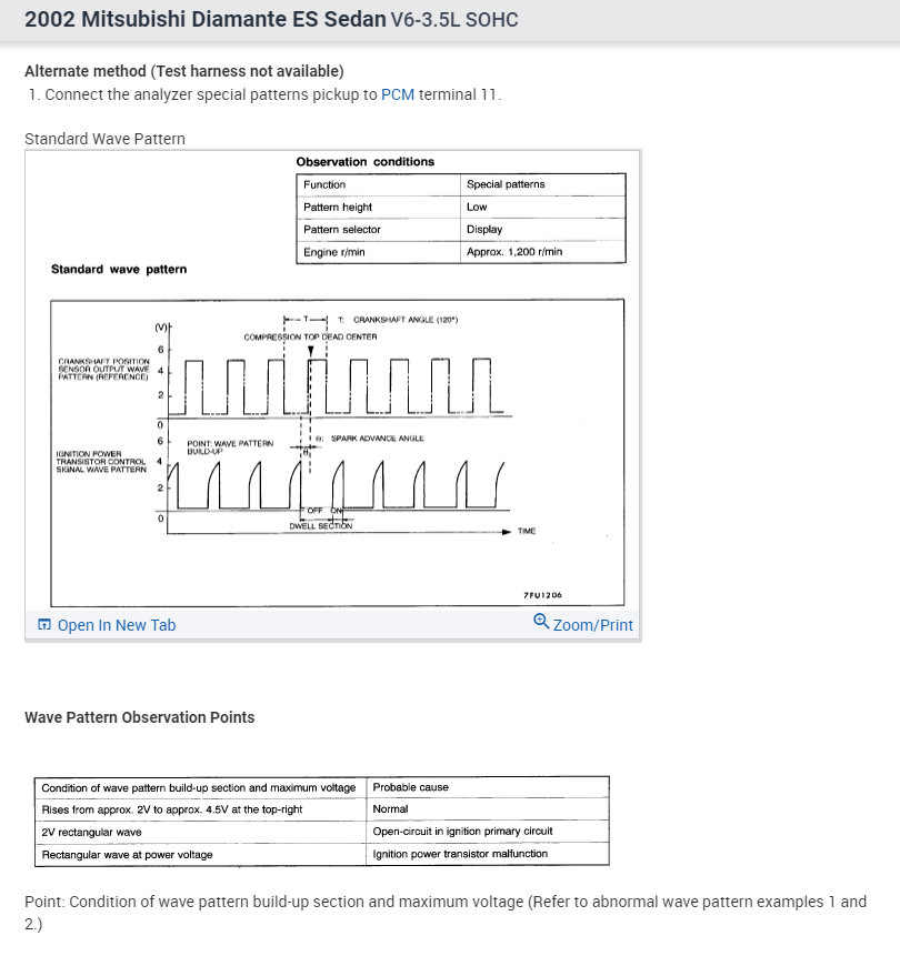

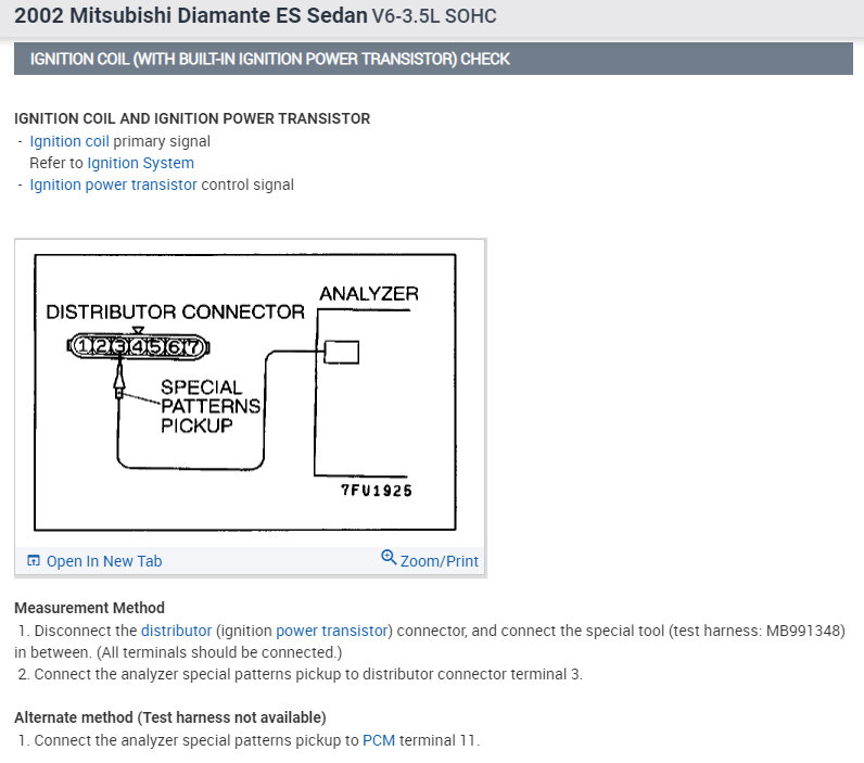

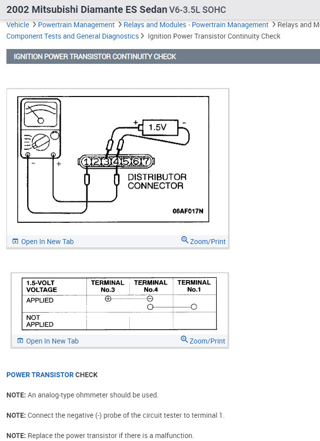

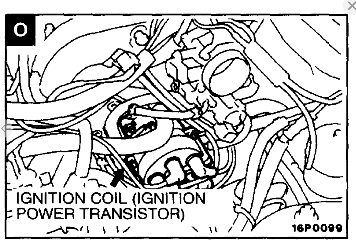

No spark can be due to a faulty coil/ignition module. See attached.

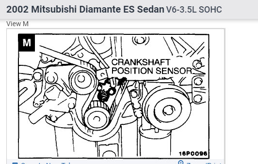

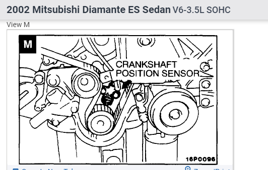

Another possibility is a faulty crank position sensor.
Friday, June 10th, 2022 AT 3:53 PM

Ignition coil replaced and still no spark and now my security light is gone. I’m clueless on what to do now.

Are you getting any codes?
Crank sensor could be the culprit here.
