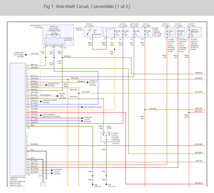

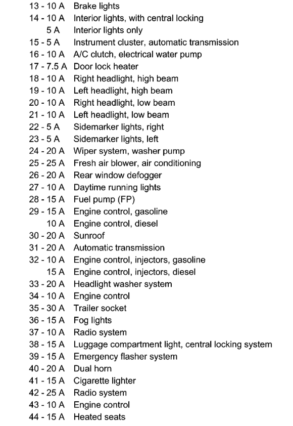

Car starts and then shuts off in two to three seconds, immobilizer light is on and just need to reset it to start the car!

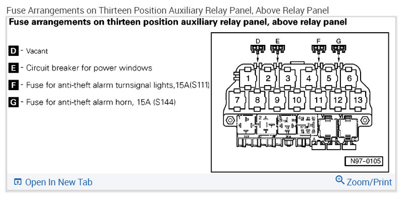

SANDY ROBINSON-KING

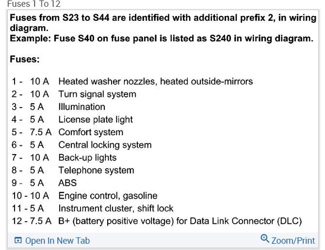

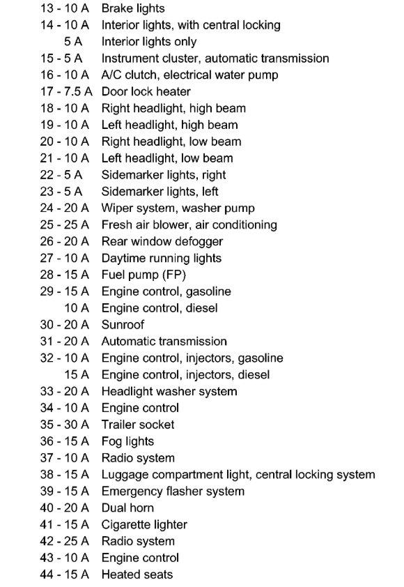

I’ve tried all these and nothing worked, I also don’t know which fuse is to the security system (they only have pictures, not very good ones I might add) Any other suggestions?

Hello again.
Okay, I will look it up for you. Can you give me the engine information? Is it 1.8 , 1.9 , or 2.0 Liter. Hope to hear back soon.

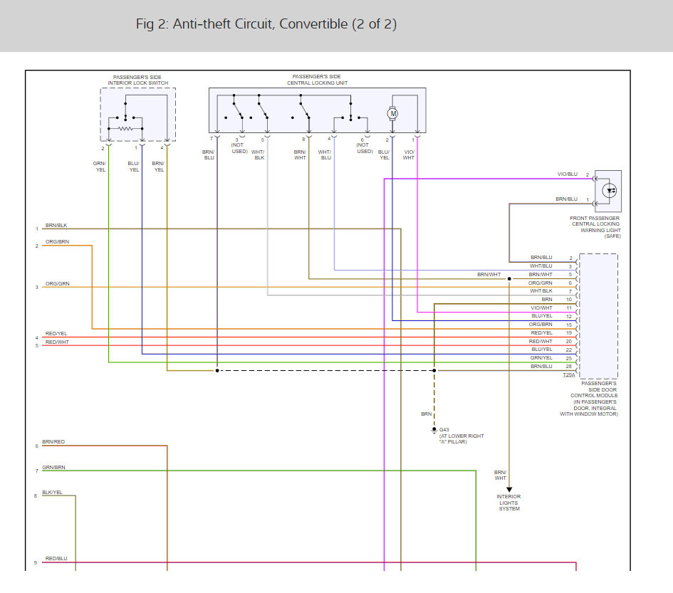

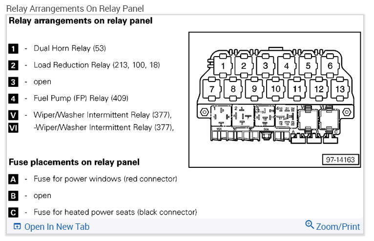

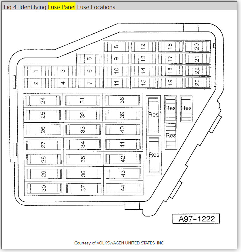

  • 55,412 POSTS

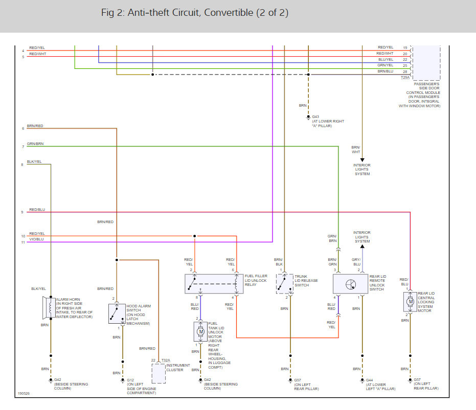

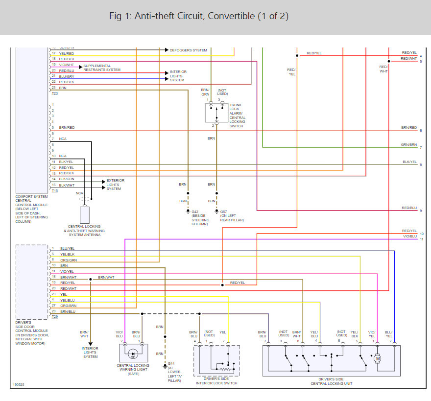

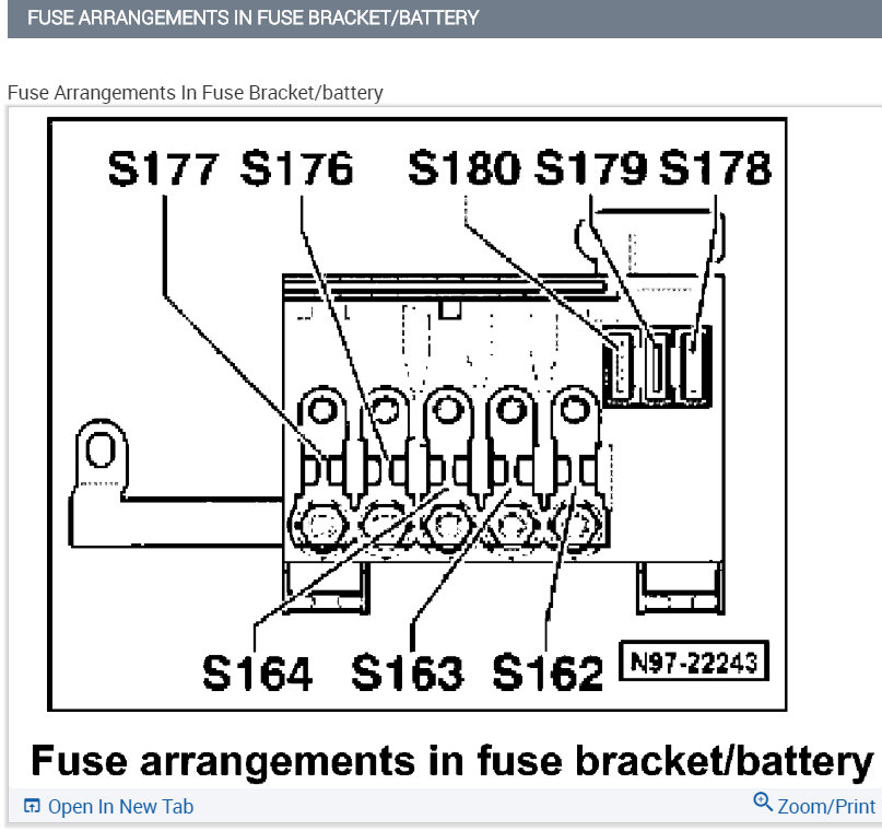

There are many fuses. here are the wiring diagrams for the security system so you can see how it works and the fuses that need to be checked with the fuse location below:
