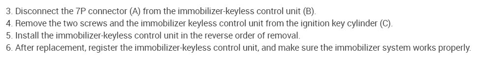

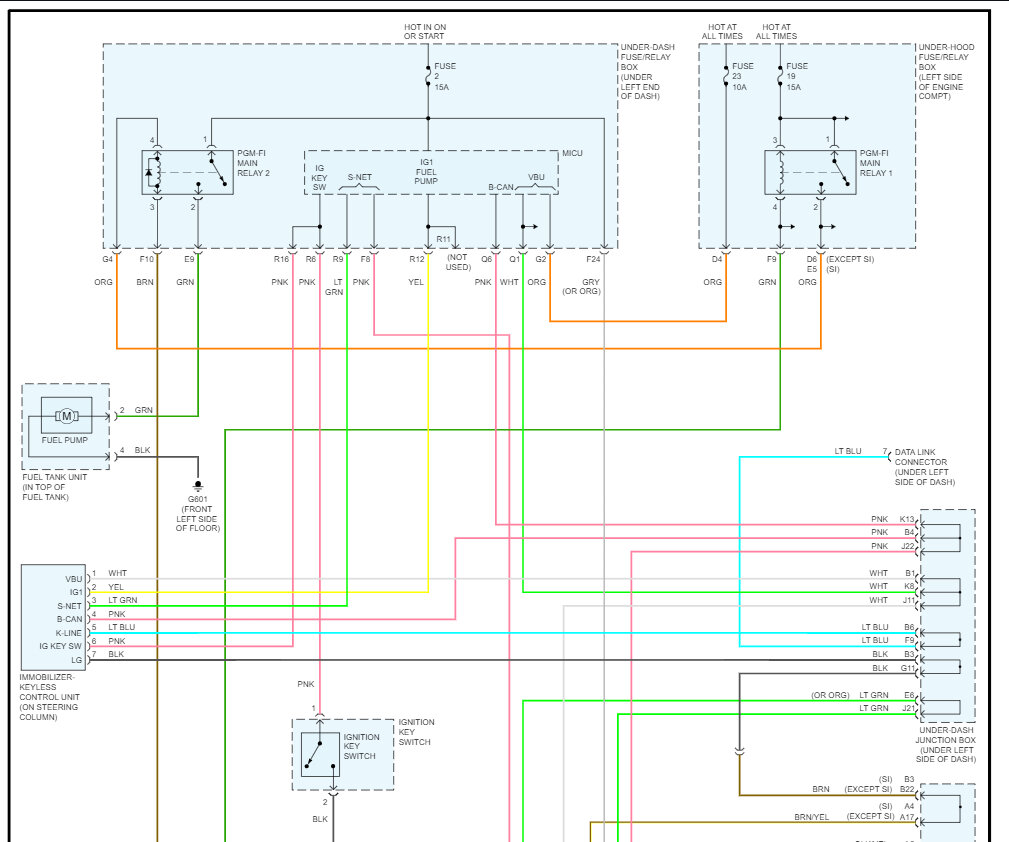

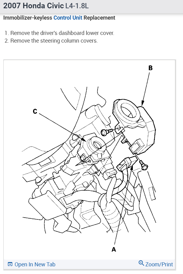

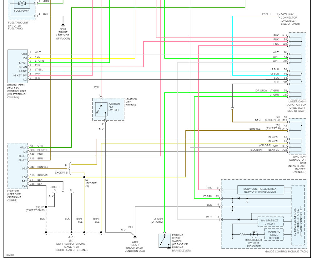

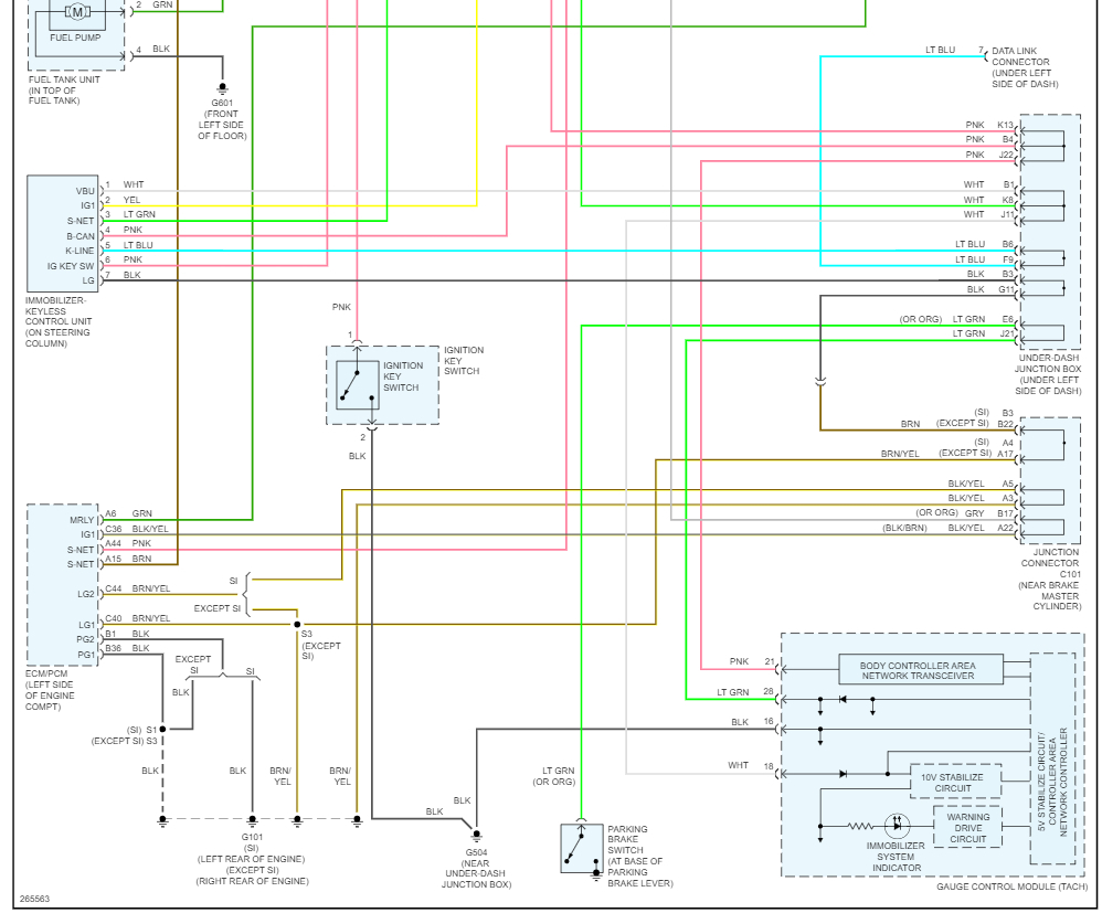

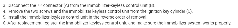

I have seen both the immobilizer key sensor go out or the MICU, you should do a CAN scan to see if any codes are stored.
You can get a CAN scanner (Controller Area Network) which will work on most cars from Amazon.
https://youtu.be/u-4syLc-ifQ
Here is how to check out the immobilizer key sensor which is probably the issue and in case code comes up for it and I have included the alarm wiring diagrams so you can see how the system works. Check out the images (below). Please let us know how it goes.
