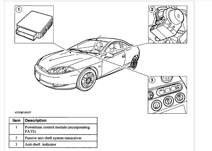

Dears, do you have some schematic, or step-by-step instructions to reach the immobilizer module and antenna ring on the ignition switch?
My problem is not recognized code, after starting, red diode starts blinking fast. After that I must do the reprogram procedure with 4times on-off until the diode continuously light, and pressing any button of the key while diode turns off.

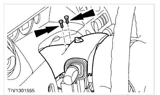

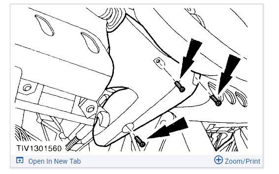

I found only 3 screws fixing the lower plastic cover behind the steering wheel, and after unscrewing them, it does not even get loosened. Tried to use forcing separation with a plastic tool between the lower and upper cover, but again nothing.

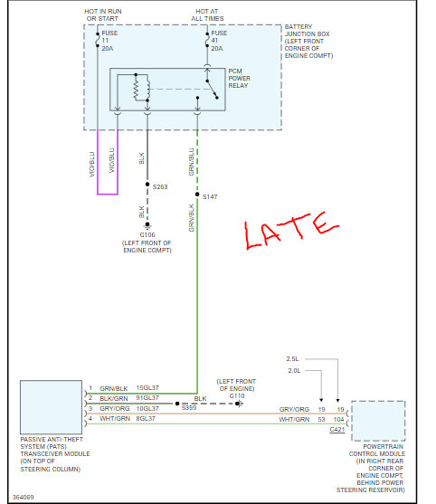

If you look at pic 1 below, it shows the components you mentioned. Now, the PATS (passive anti-theft system) module is integral to the powertrain control module.
The PATS uses a specially encoded ignition key. Each encoded ignition key contains a permanently installed electronic device called a transponder. Each transponder contains a unique electronic identification code out of over four quadrillion combinations.
Each encoded ignition key must be programmed into the vehicle's Powertrain Control Module (PCM) before it can be used to start the engine.
The transceiver module communicates with the encoded ignition key (at the ignition switch). This module is located behind the steering column shroud and contains an antenna connected to a small electronics module. During each vehicle start sequence, the transceiver module reads the encoded ignition key identification code and sends data to the PCM.
If you plan to replace the transceiver, it will require programming.

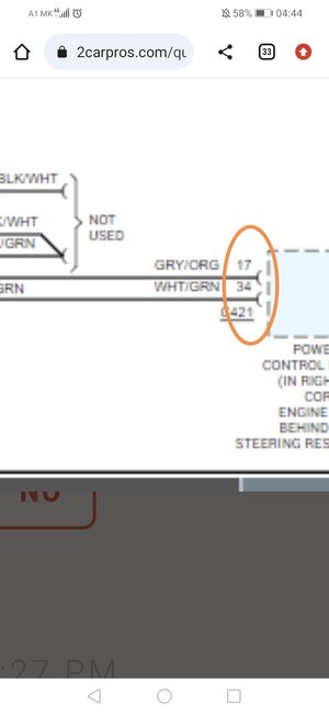

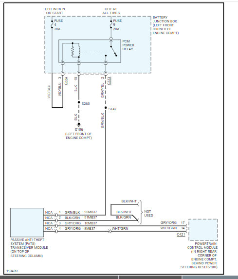

I attached three pics below. The first shows locations, pic 2 is the wiring schematic based on early production and the last one is on late production. The last two pics show the five screw locations that hold the steering column cover in place.
Let me know if this helps.

Does it serve only as a kind of "microswitch" to make a contact between these two points to trigger the PCM, or sends some special data? (I mean this case, if I find these two points and wire jump them, will the PCM be triggered as "readed key" all time?
Apr 28, 2024 at 12:49 PM
  • 110,241 POSTS
It signals the correct key is being used. It recognizes the transponder in the key and signals the PCM (PATS) it is okay to start.. That is why the system will need programming to recognize the new transponder. Also, jumping the two wires won't eliminate the issue.

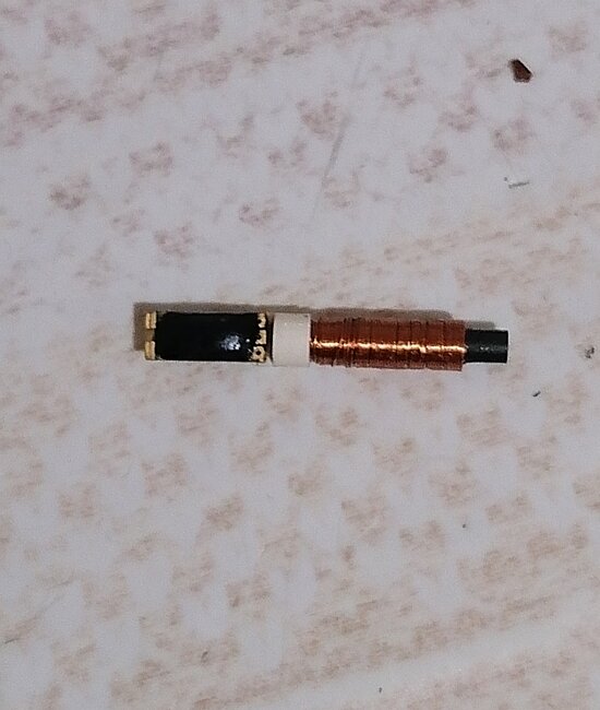

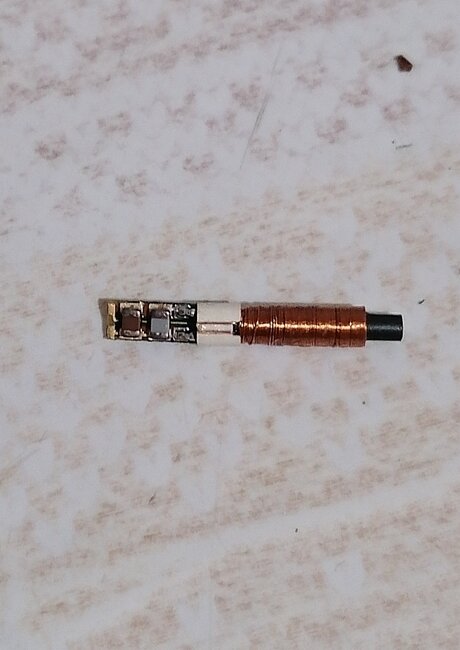

Could it be a small chance (even 1%) that transponder chip in the key got some failure, and stops working intermittently? (I mean in case because nothing lasts eternal, even it is passive component, it contains capacitors - which maybe is almost impossible to fail on that extremely low inducted voltage, but it is made 24-5 years ago)
I am asking this, because the most cheap step that I can do by myself without need of buying any additional electronics and without need to trust of any "expert"
(here in my country everyone that have money to buy some technology is an expert in that area, and if you take the car to 5 technicians, you get 5 different diagnostics and solutions)
is to buy new chip only, mount into the key and program it directly to the car with on-off method.

Not a high chance that it's the key that's bad, The common failures in them are the modules themselves. If you really want to do some testing you could get a copy of FORScan https://forscan.org/home.html Get the windows version, and the dongle from these folks https://www.obdlink.com/products/obdlink-ex/?ref=forscan

I already purchased this morning transponder chip, to give it a try first...because it is $5 only and will receive it this afternoon by kargo taxi.
I only need the correct and exact procedure to pair (program) it with the car, directly on the car as a master chip on the key, because I have only one key.
