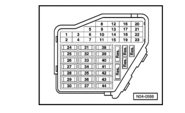

Ok. I try to test relay n 167 (i suppose that it was designed to command injection pump). I pick up the couvercle the turn ignition on. The relay shut for a moment then it open. is this normal?
Feb 4, 2018 at 4:41 AM
  • 55,770 POSTS
Yes, it sounds like a normal cycle.
