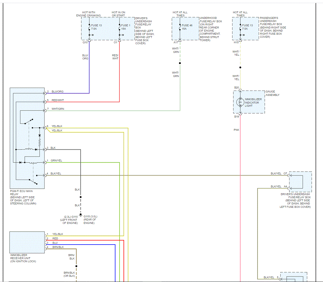

I just changed my battery recently and now all of a sudden the green key light won't stop flashing. is there anyway to reset this? I have the original key so not sure why it won't start. thanks in advance.

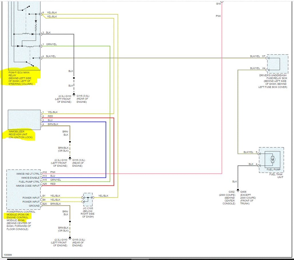

Since you have the original key, this isn't making sense. When the immobilizer is engaged, it shuts fuel down from the pump. Do you hear the pump actuate?
Also, when it doesn't start, does the engine still crank?
Let me know. As far as the immobilizer circuit, there is a receiver unit on the key cylinder That is what recognizes the key and signals the okay to the powertrain control module to run the fuel pump.
Take a look below. I attached the wiring schematic for this circuit.
Let me know if you hear the fuel pump, if the starter engages when it's a no-start condition, and inspect the fuses identified in pic 1 below. Since it did start yesterday, I doubt a fuse is bad; however, there could be a connection issue in the fuse box.
See pics below. I had to cut it pic in half to make it readable for you. I did, however, overlap them so you can follow from one to the next.
