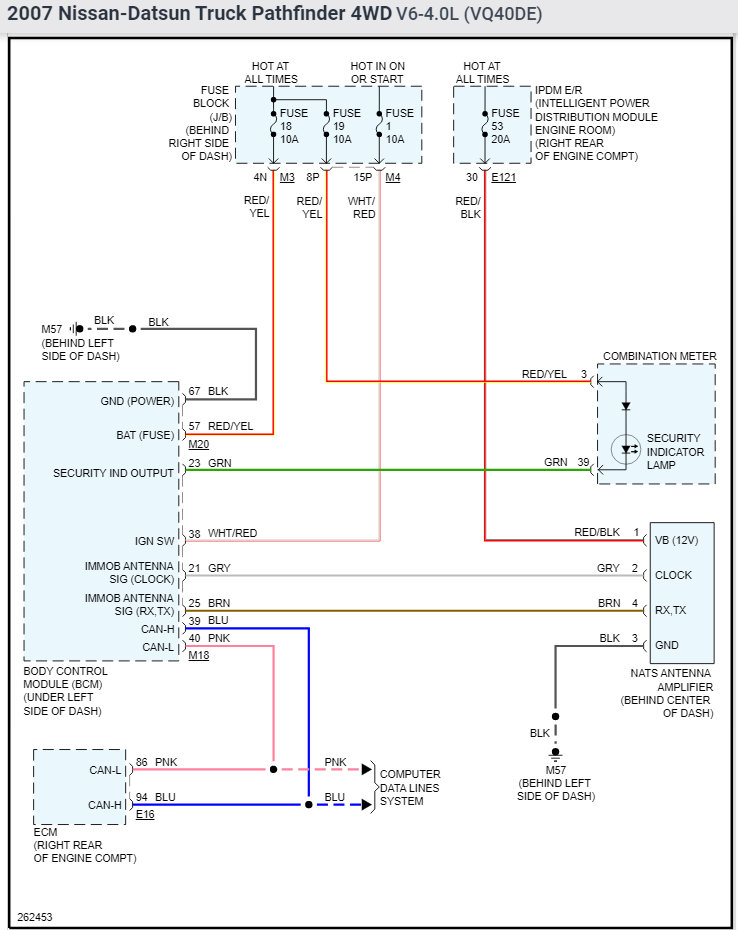

I severed the antenna wire on my immobilizer to my vehicle, I'm wondering if I can rewire the antenna wire or if I need a new immobilizer?

The antenna wires are typically the gray and brown wire for these immobilizers.
Where did the wire break? Unless there is damage to where the wires go in you should be able to reattach by soldering.
Here is a helpful video on how to solder:
https://youtu.be/4TjSYfLTHfg
I have attached the wiring schematics for the immobilizer below.
