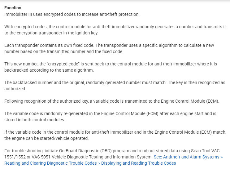

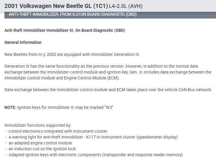

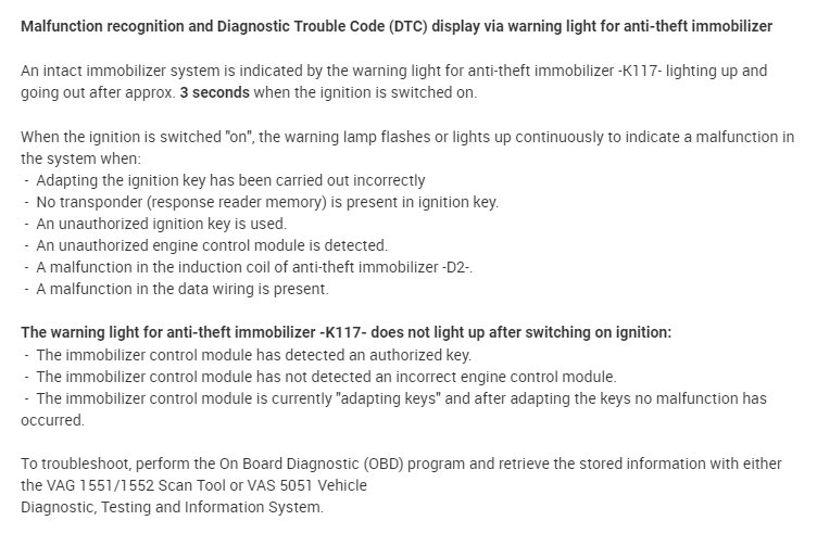

RFID tube was crushed. How do I program the new one?
Jun 2, 2019 at 5:29 PM
DANNY L
  • CAR REPAIR CONTRIBUTOR
  • 5,648 POSTS
Hello, I'm Danny.
It will have to be programmed using the Volkswagen VAG tool. I've attached a few pictures below showing its description.Hope this helps and thanks for using 2CarPros.
