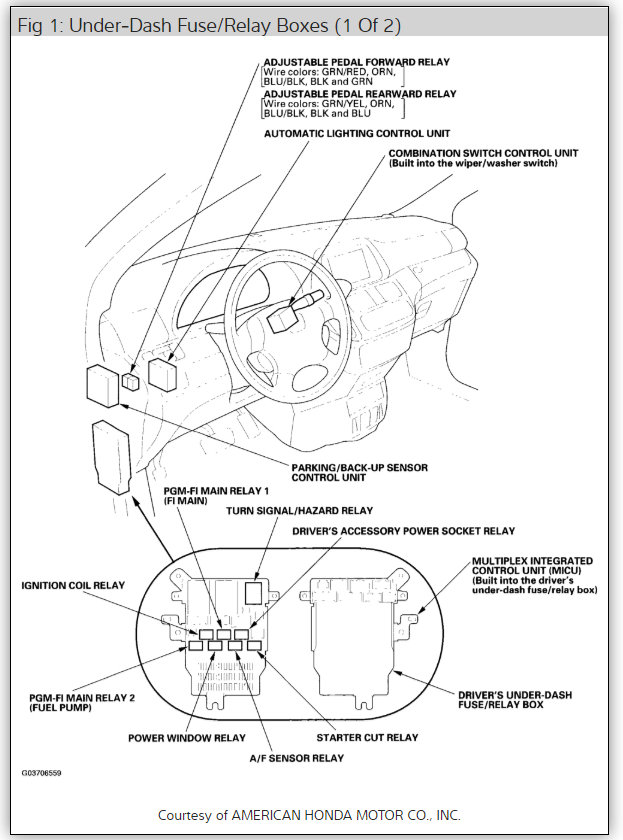

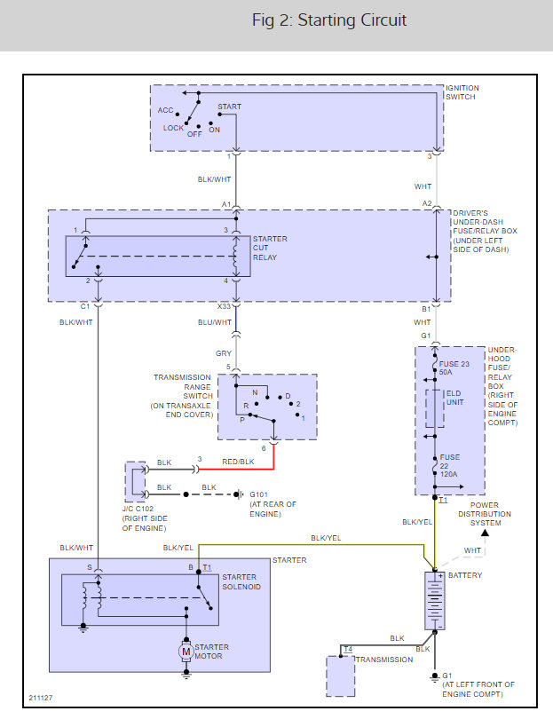

Starter motor continues to run without key, green light flashes on dash.
Jun 11, 2018 at 7:08 AM
  • 55,711 POSTS
There is a starter cut relay that is stuck and needs to be replaced. Here is a wiring diagram so you can see how the systems works and a guide to help test the relay once you find it from the diagrams below:
