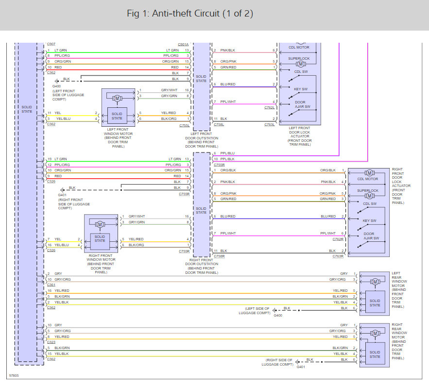

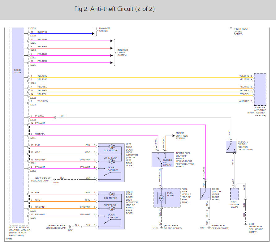

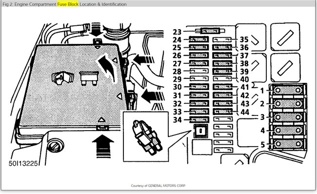

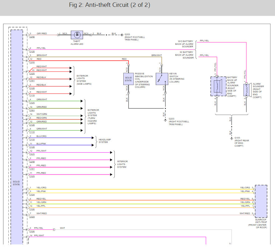

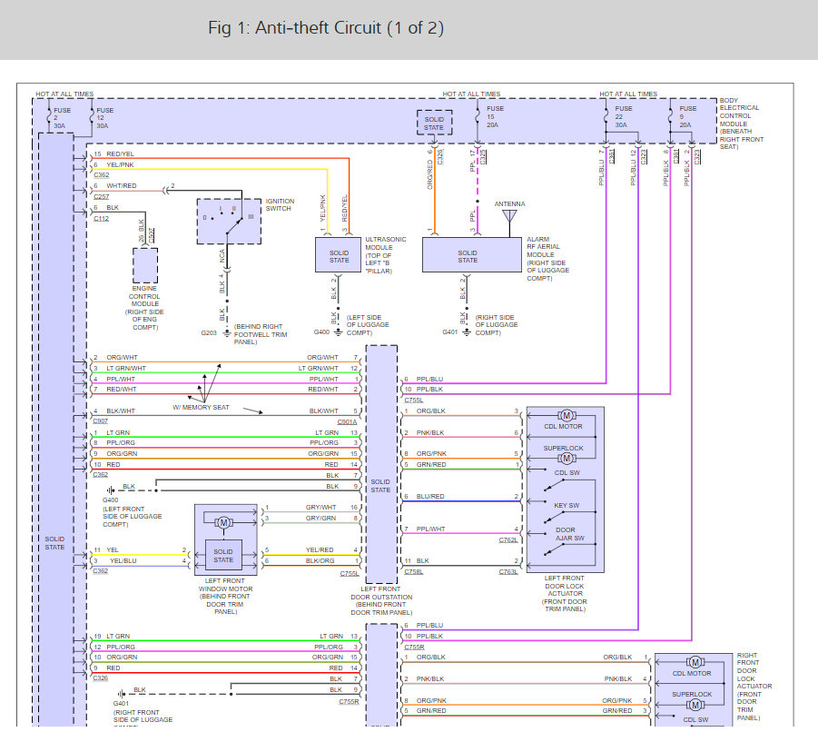

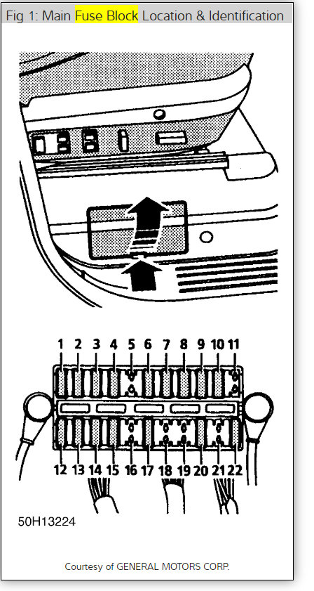

It sounds like you may have a fuse blown. Here is the security system wiring diagrams so you can see how the system works and which fuses to check:
Check out the diagrams (below). Please run this test and get back to us.
Aug 14, 2018 at 4:10 AM
GORDON MCDOUGALL
Hi, managed to check fuses they are okay. The only other thing I can think of is the immobilizer has fried.
Any other ideas/help?
