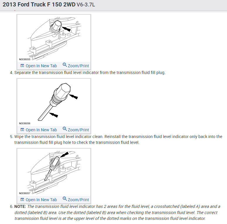

I think it’s supposed to be in between the A and B on the dipstick.
Is that when it’s not running though ?
Jul 30, 2021 at 2:53 AM
SQM
  • 6,383 POSTS

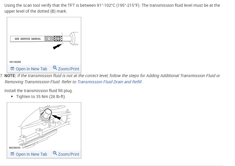

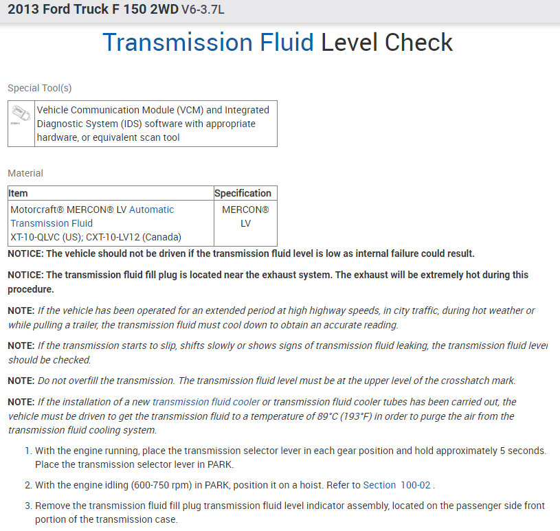

When check the transmission fluid, start the engine and the transmission needs to be in park and the engine needs to be in operating temperature.
And yes, the fluid level should be between A and B.
https://youtu.be/164DjhKjqxA
I have attached (see below) complete procedure with details for your reference.
