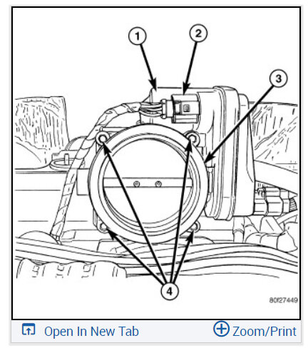

The truck stalled a little at a red light and felt like it was running out of gas. so, I coasted to a stop light to turn off the road and when I fully stopped the truck would only move a little at a very low RPMs and after a few days it wouldn’t move forward at all reverse works perfectly still and the 4w drive has been disconnected since I got the truck.
Sep 22, 2024 at 6:12 AM
  • 55,758 POSTS

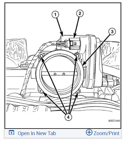

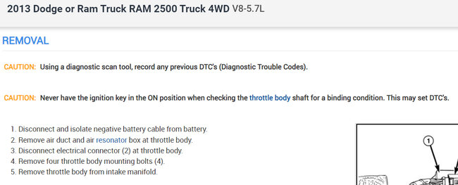

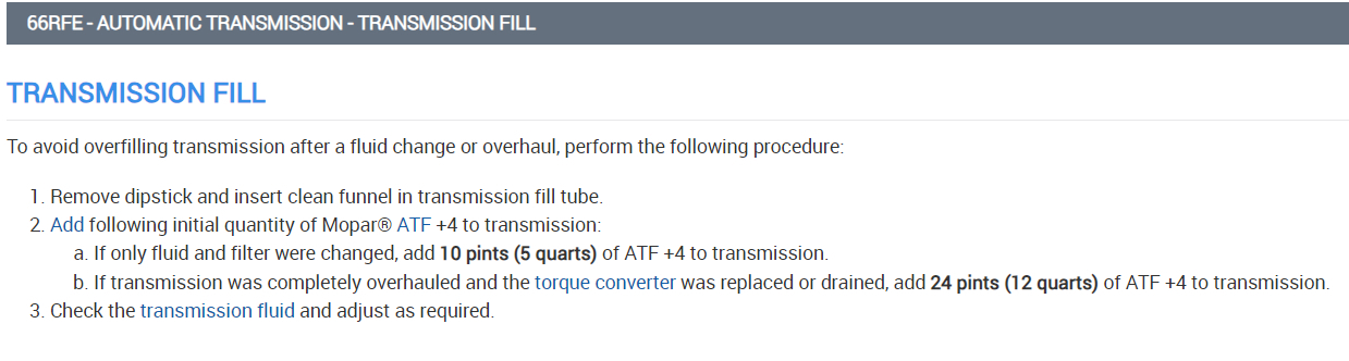

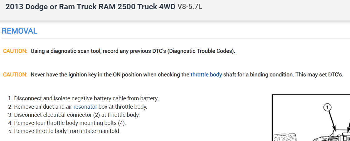

It sounds like the truck is in limp mode which is common. This is usually because of a dirty throttle body but we should check the transmission fluid as well. Can I ask if you have any warning lights on? Here is how to check the transmission fluid and how to service the throttle body. This guide can help you understand more on limp mode:
https://www.2carpros.com/articles/reduced-power-limp-mode
and
If the transmission is not leaking, then it should be okay. Check out the images (below). Please upload pictures or videos in your response of any problems so we can see what to help you with.
