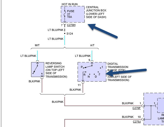

I have no turn signals, no reverse lights and no cruise control. I have been told that it could be that. Any other suggestions?
Aug 17, 2016 at 3:50 AM
HMAC300
  • 48,601 POSTS
for turn signals check fuses under hood and relays like trailer relays and hazard switch see if power is going in and out of multi function switch. lights do not go through bcm. for cruise have it scanned for codes and check fuses as well under hood it may be the clock spring in steering wheel column or brake switch/abs problem for that.for back up lights make sure bulbs are good and check fuses then have scanned for codes to see if transmission range selector switch is working.

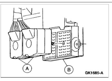

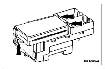

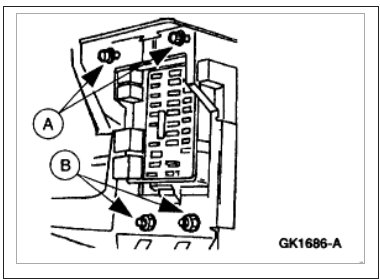

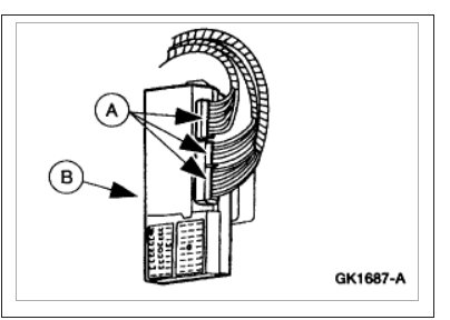

I need to find my body control module on my 2000 F-250 so I can get the identification numbers off it to get a new one. Nk idea where it is or what it looks like really. Help please!
2000 Ford F-250 super duty. 5.4 liter V8. Auto. 4x4. A remote starter was being hooked up and I was told the bcm got fried. The 4x4 is engaged all time. Airbag light stays on sometimes and when it does the heater doesn't work. Various dash lights go on and off. Power locks don't work. Cruise control either.
Aug 18, 2019 at 2:18 AM (Merged)
  • 55,433 POSTS
Theses trucks do not have a BCM they have a GEM module which is located under the dash on the drivers side here are diagrams to help you see how to change it out.
