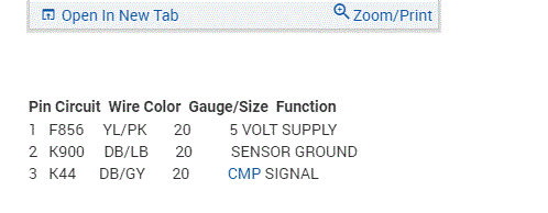

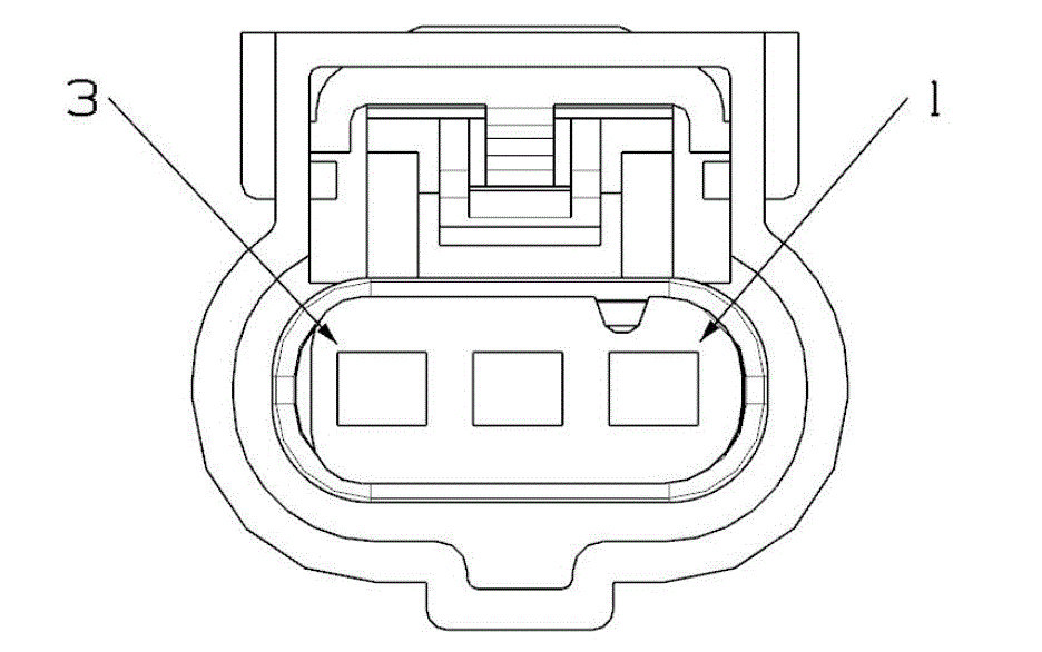

When you checked the wiring, did you check the voltage to the sensor? You need to remove the connector and test for voltage at the sensor. The 2 end wires of the connector must have 5 volts with the key on.

Yes, i checked both wires and they say around 5 volts.

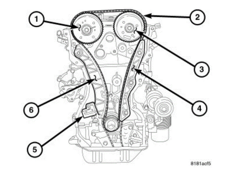

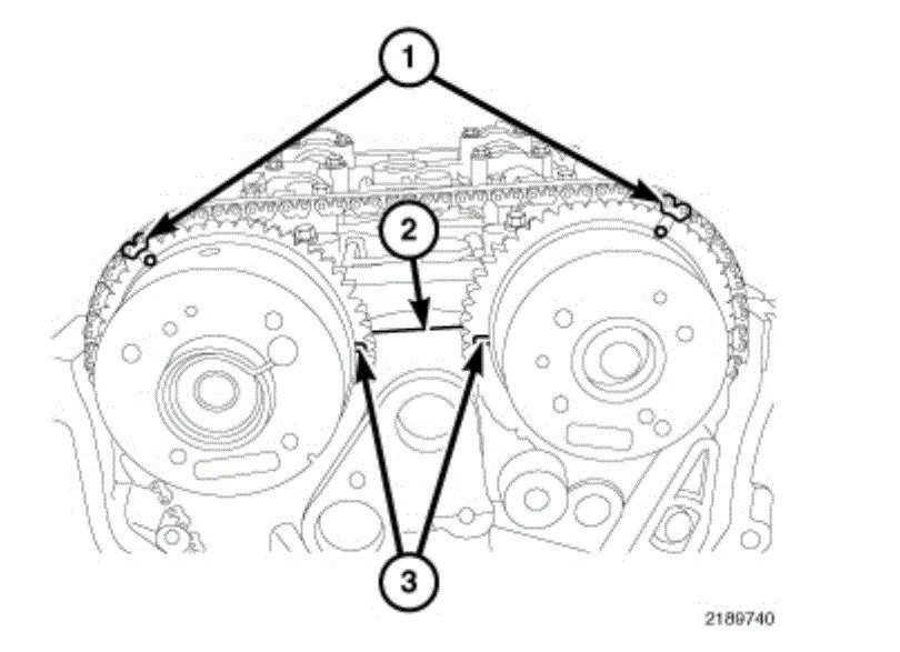

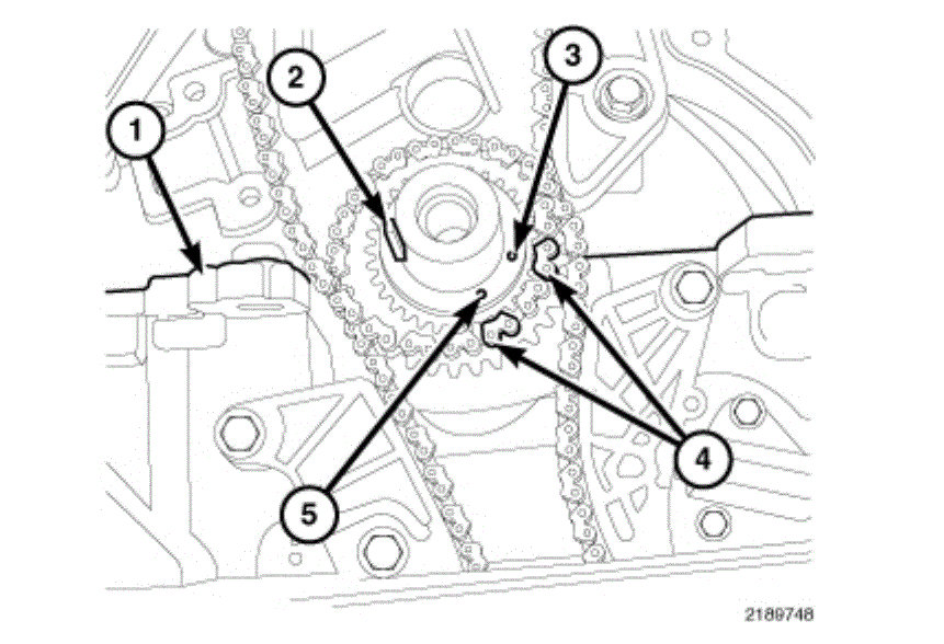

Okay, first, compression is low. Sounds like the valve timing is off and that alone will set the 340 code.
https://www.2carpros.com/articles/how-a-timing-belt-works
I attached a YouTube video on the timing marks for you.
https://www.youtube.com/watch?v=Yxhx83g1LYE

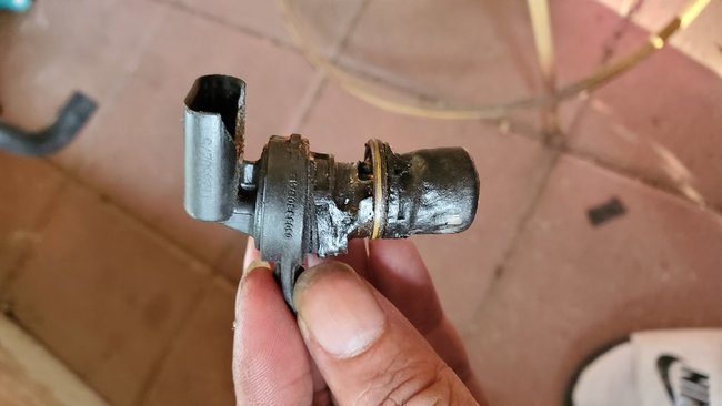

So I checked my cam sensor again and I barely realized that my other sensor was broken.
Also some water got mixed with oil in my engine.

Here's the cam shaft sensor rear:

Okay, did you check the timing belt marks to see if they are correct?
