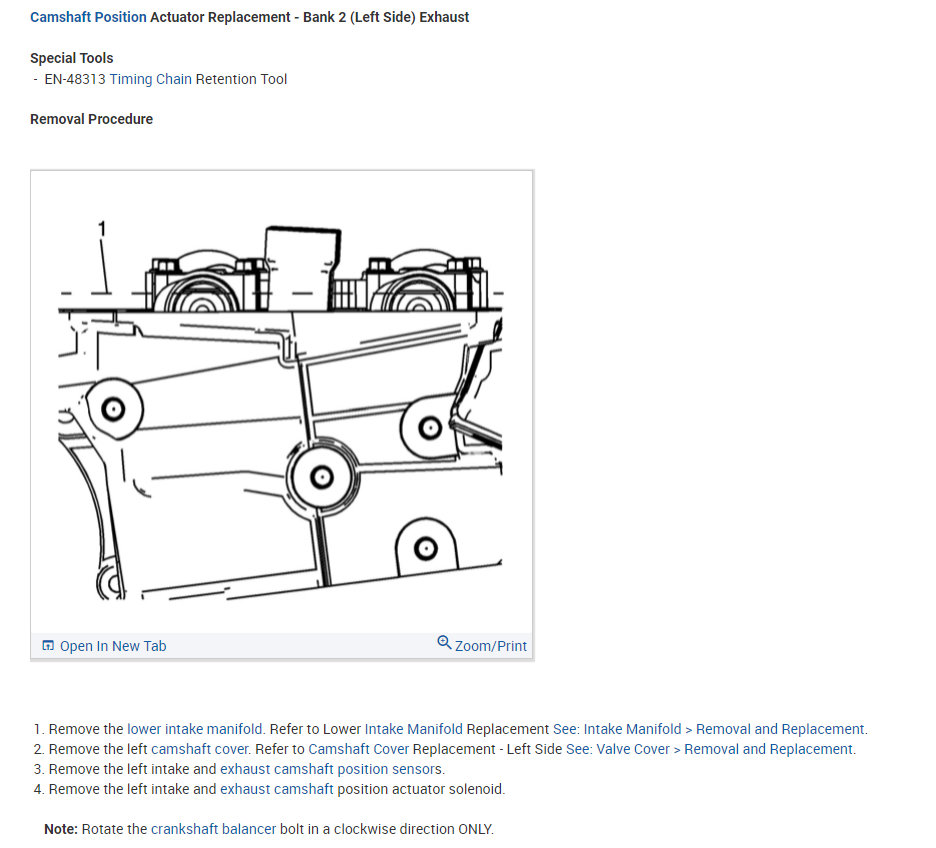

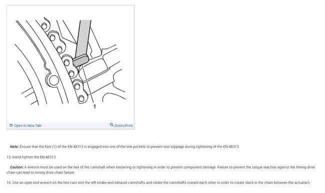

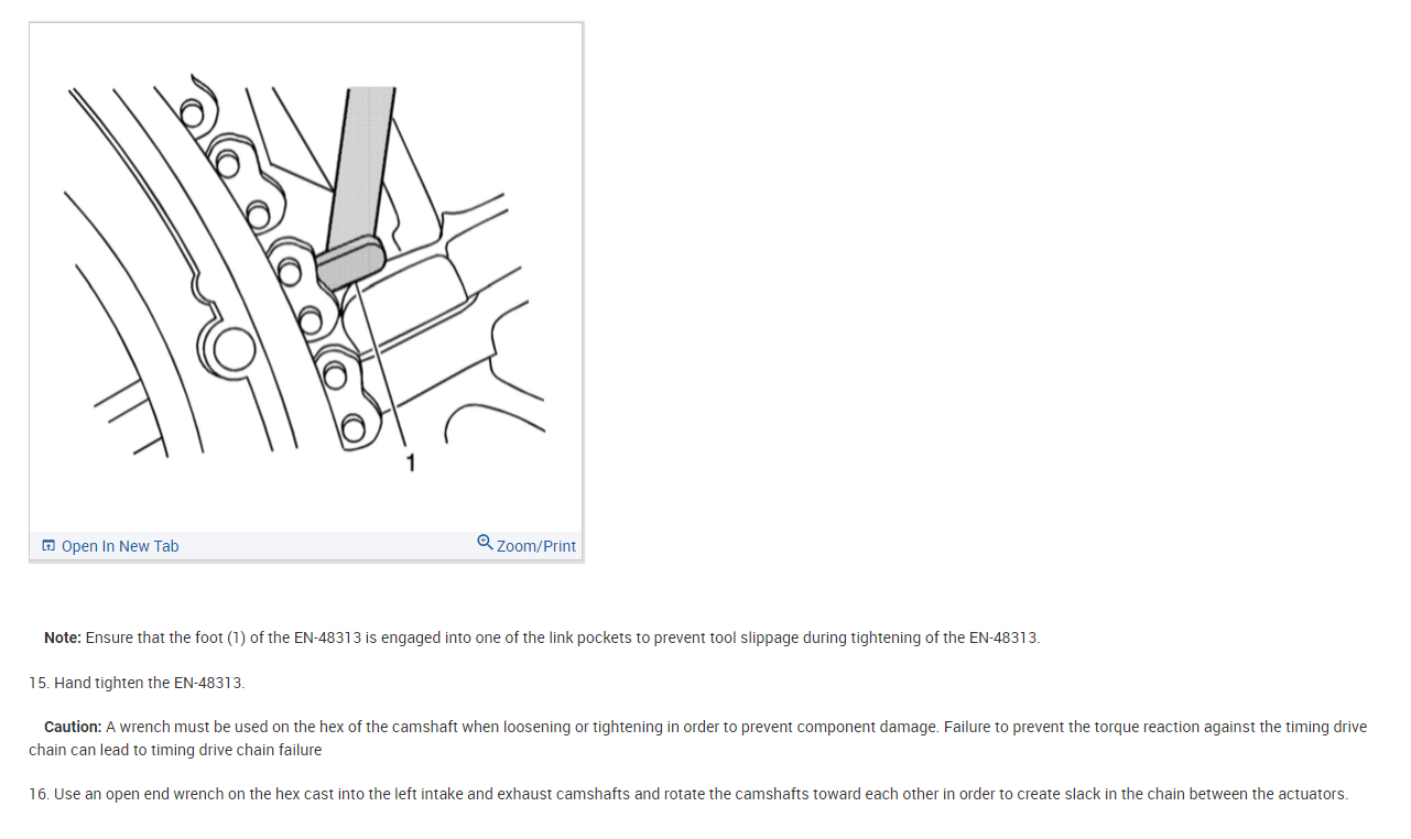

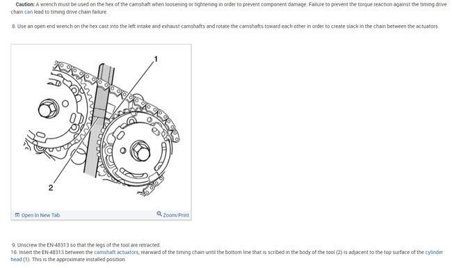

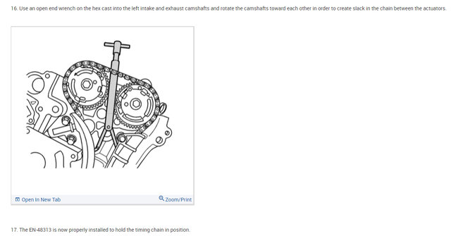

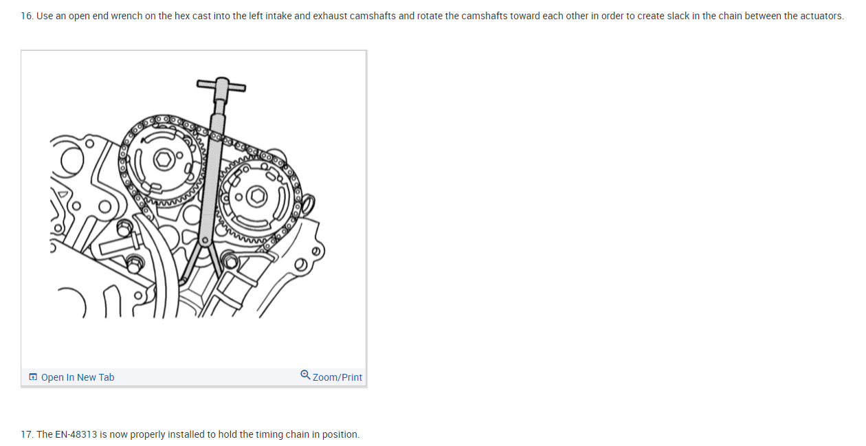

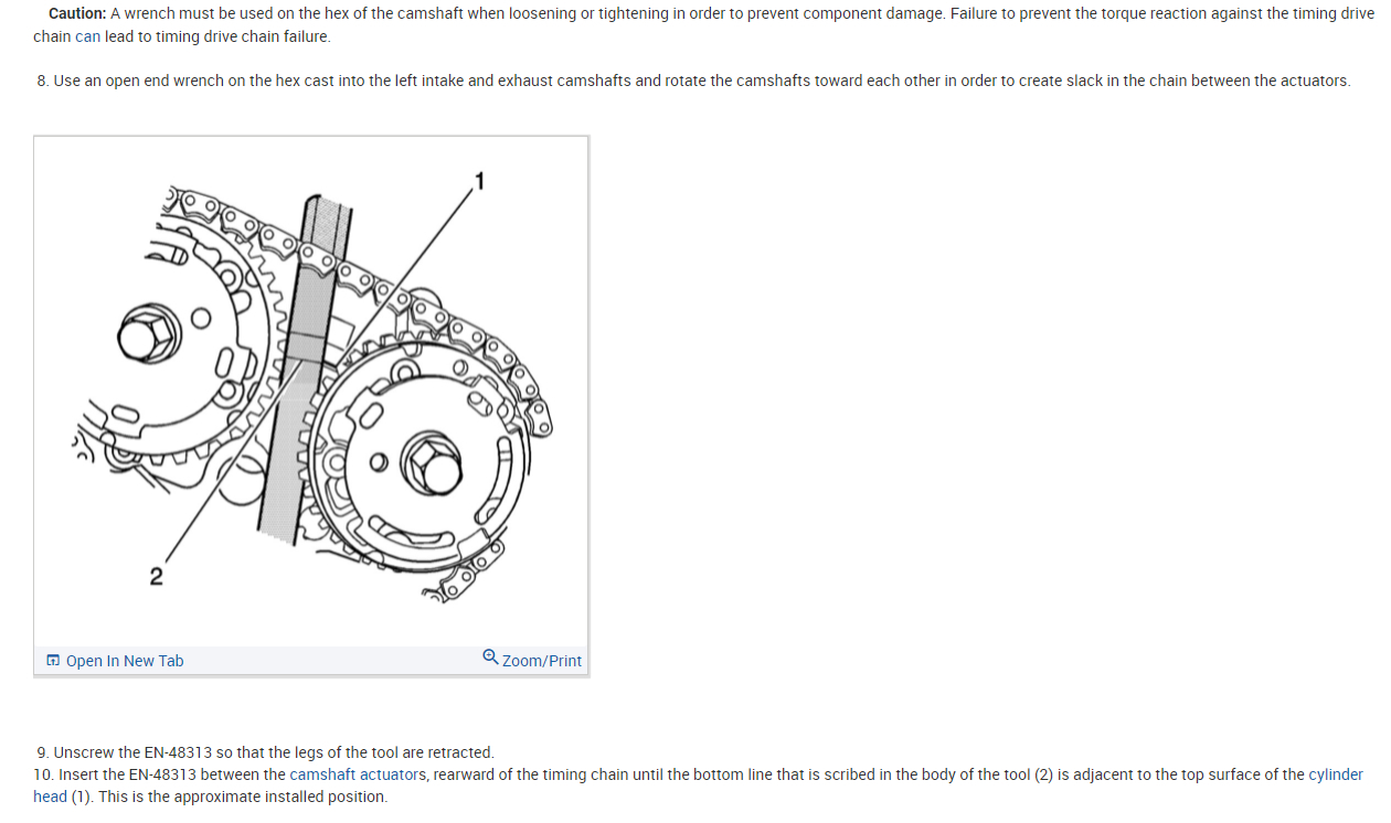

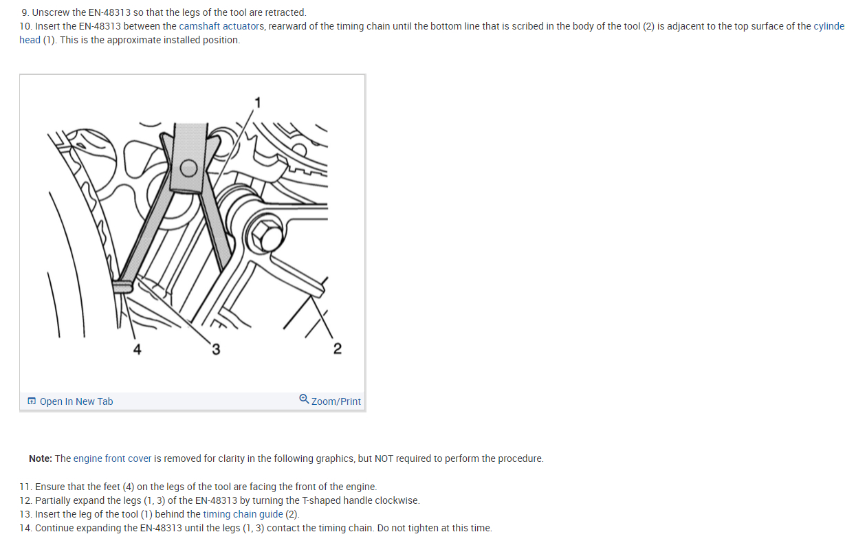

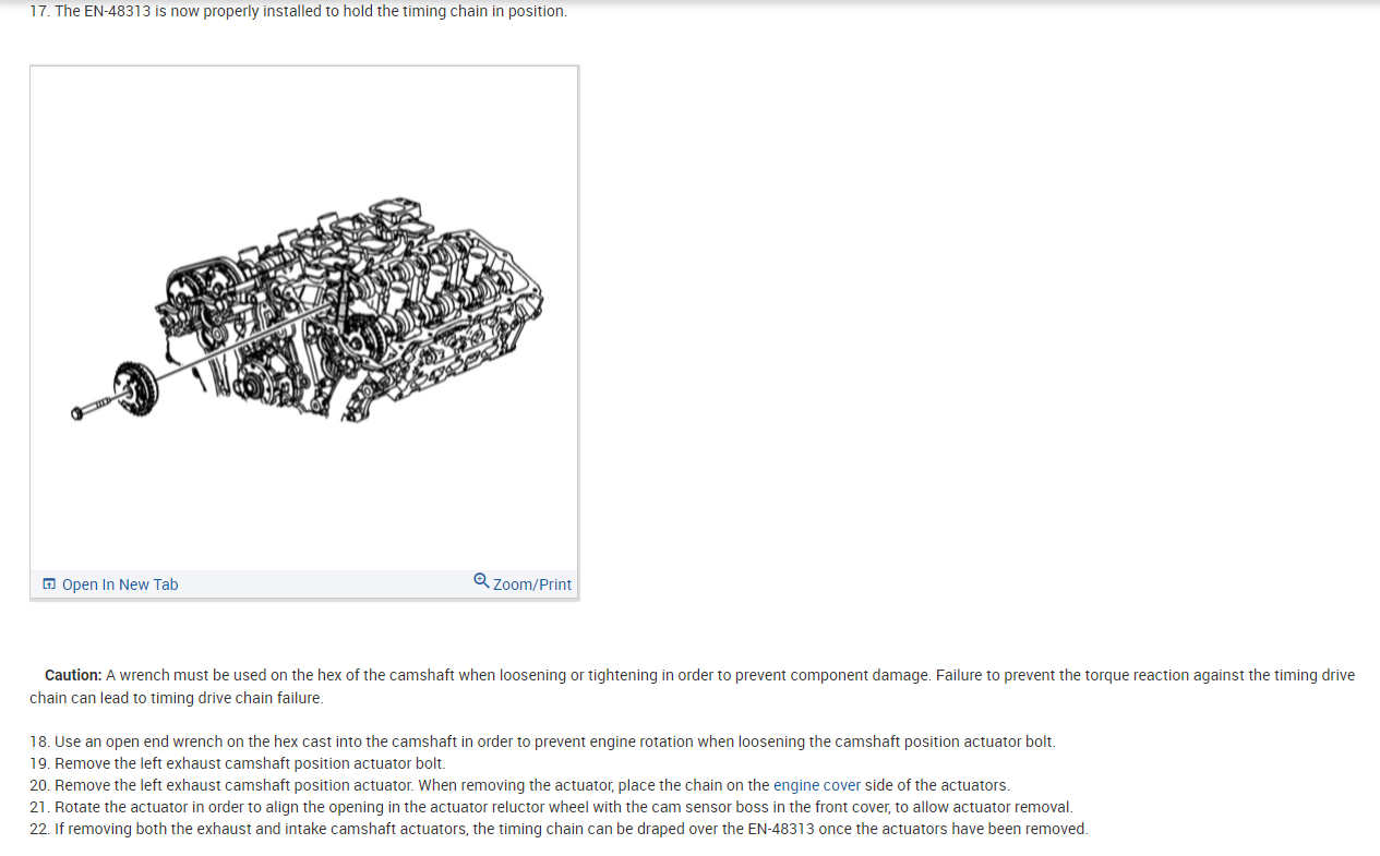

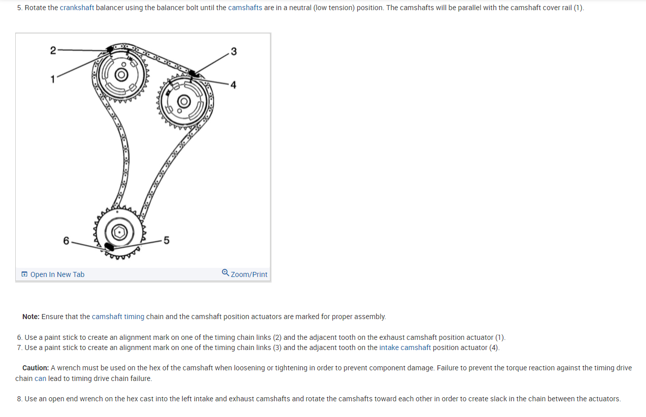

I have changed my camshaft sensor and crank sensor only 2 but still those codes are appearing. what should I do and how many sensors in my car?
Jul 25, 2021 at 3:46 AM
Experienced Mechanic
52,796 POSTS
Good evening,
This code could be the actuator solenoid that has failed or the screen on the end is clogged with debris. I attached a flow chart for you to view.
I attached the flow chart for the 24 code for you.
Follow the chart and let me know the results.
