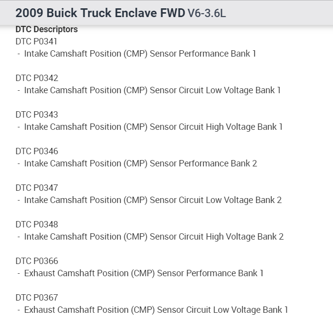

I am getting a po342 code
2009 BUICK ENCLAVE
89,000 MILES • 3.6L • 2WD • AUTOMATIC
BENNIELEE 66

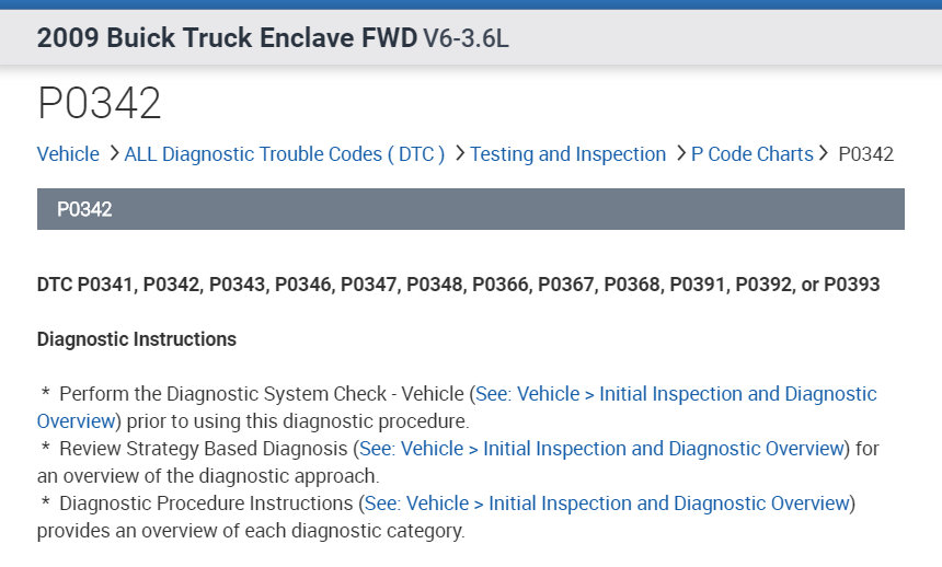

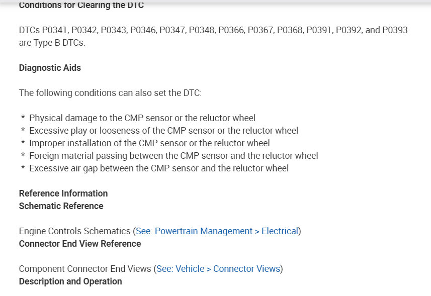

I have replaced the intake came sensor intake bank 1 but still getting code 342. I have checked plug connector to sensor, checked battery,checked harness for bad wires, have 4.9 volts on pins going to sensor, checked for good ground and checked starter wires and all is good. What am I missing?

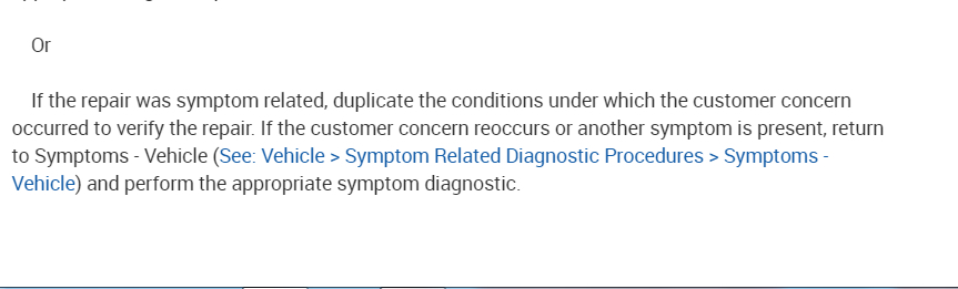

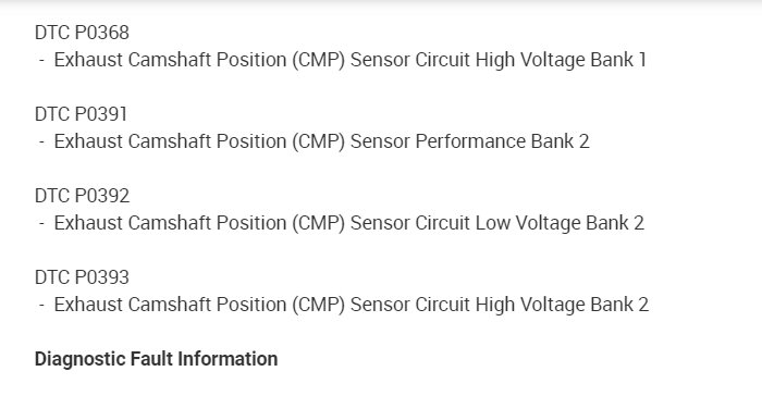

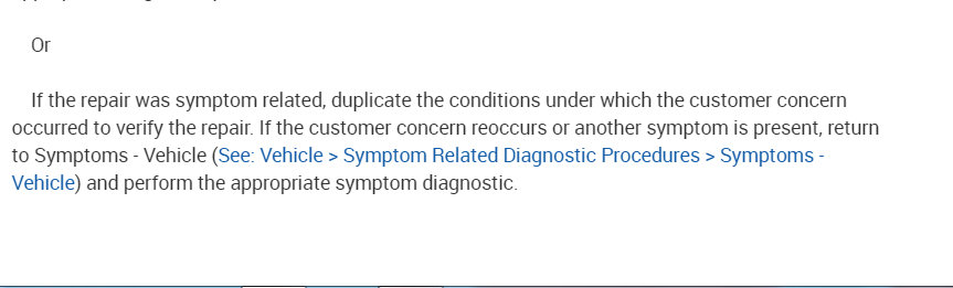

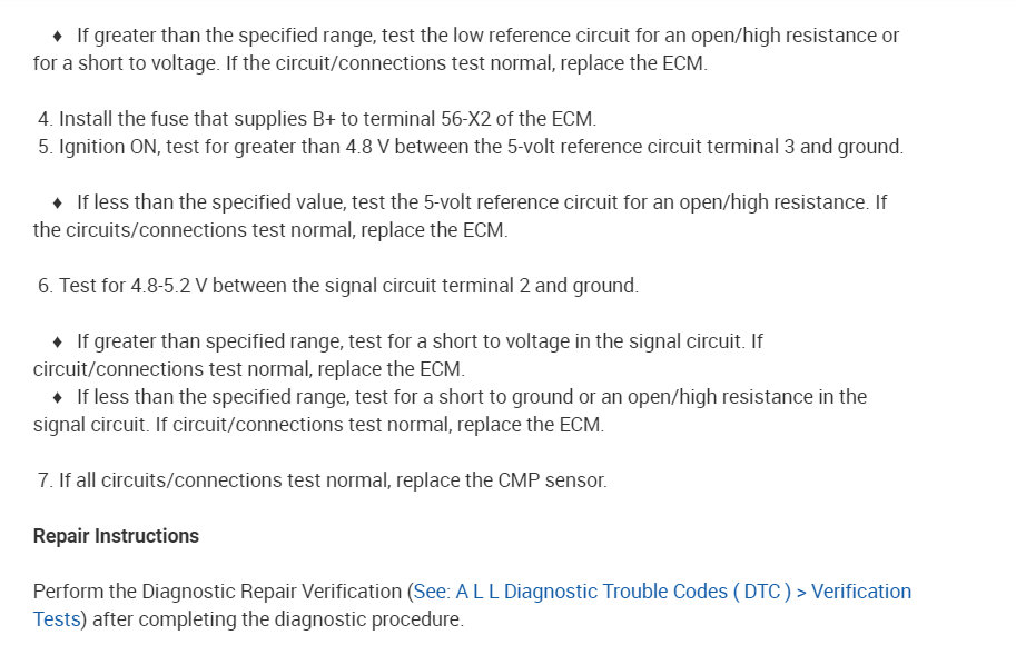

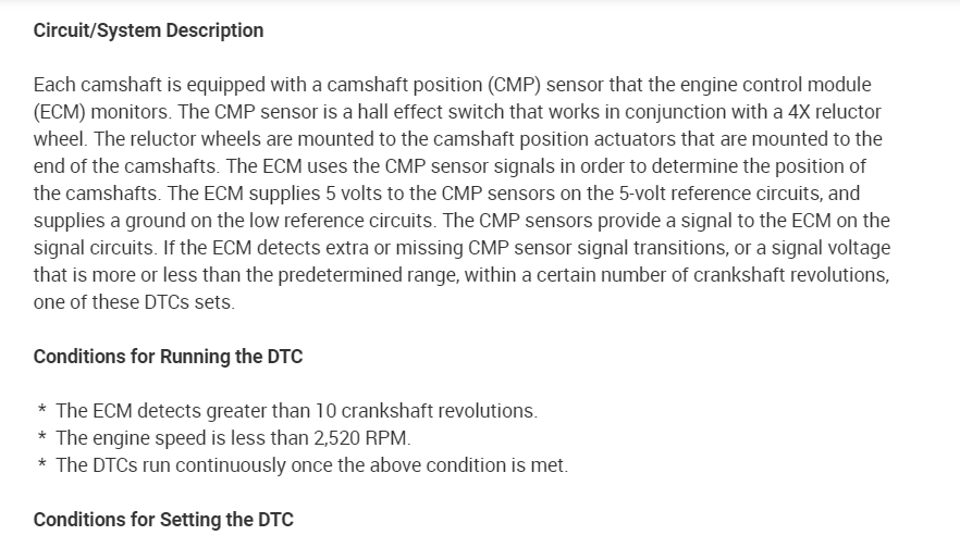

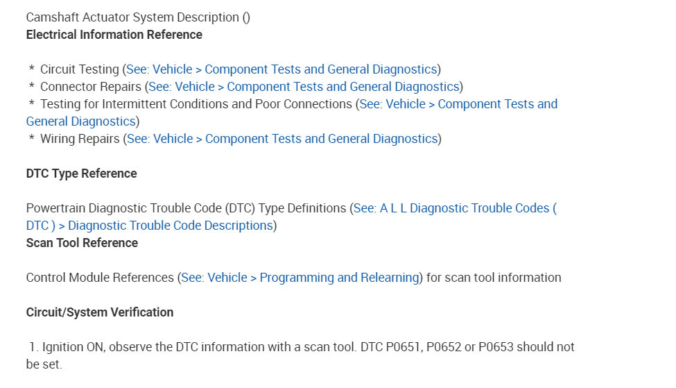

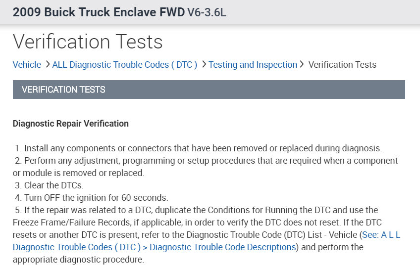

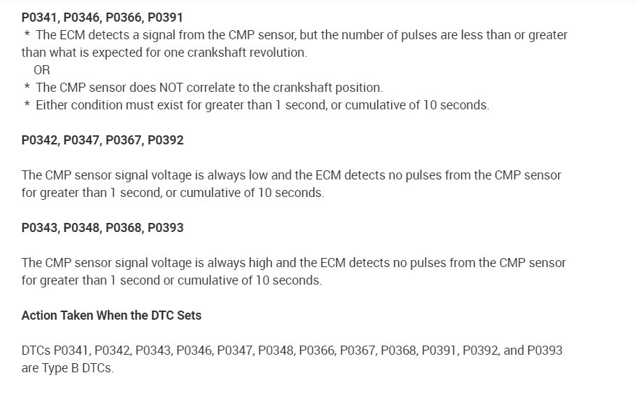

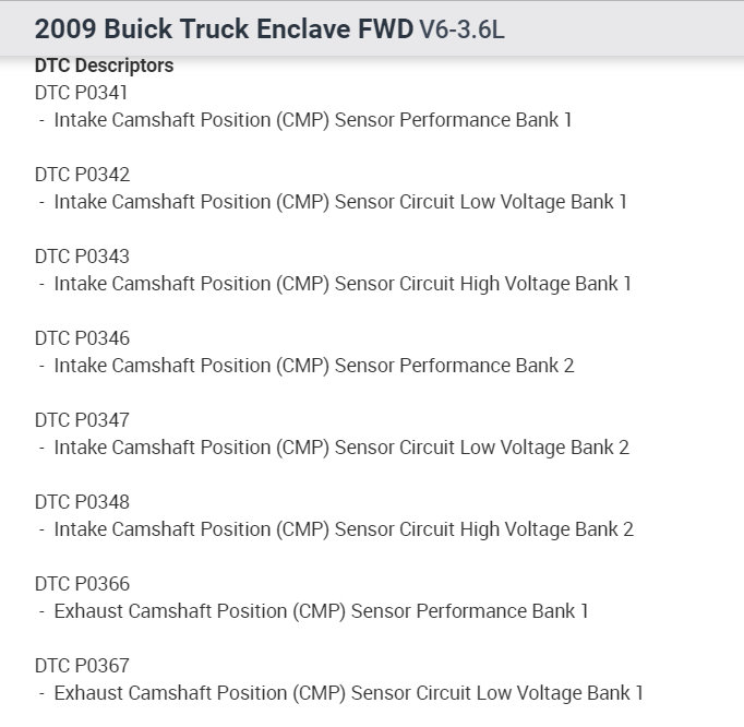

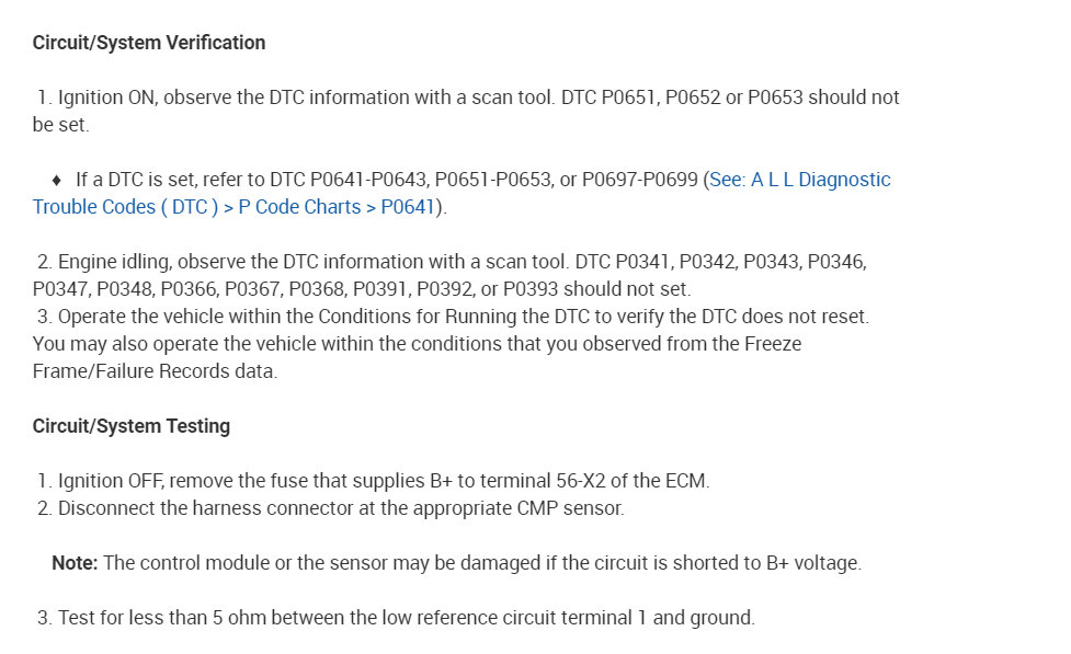

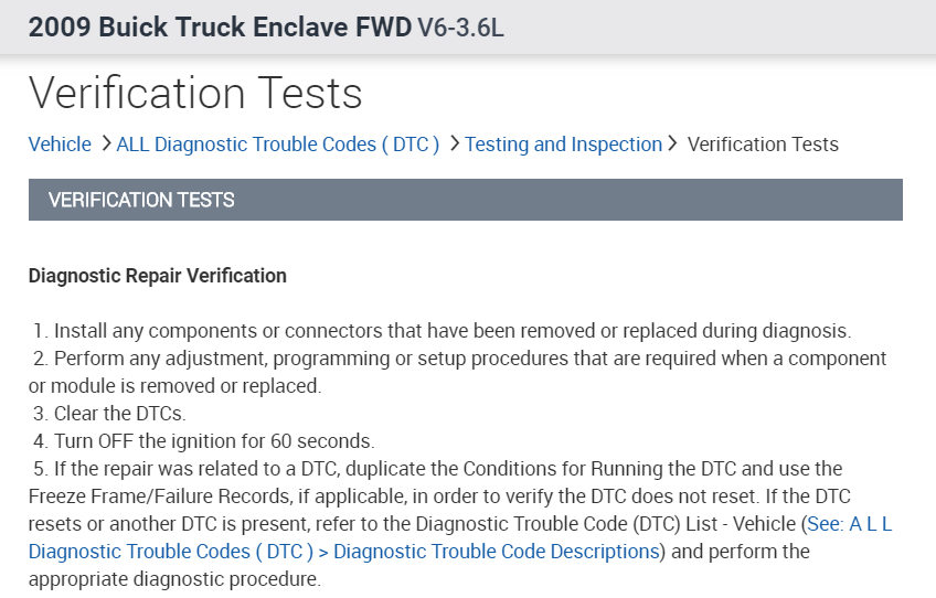

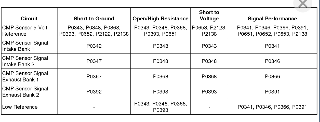

In the diagrams down below I have included the Buick factory diagnostic troubleshooting guide for Direct Trouble Code (DTC) P 0342. Please go through this guide and get back to us with what you are able to find out.
Thanks,,
Alex
