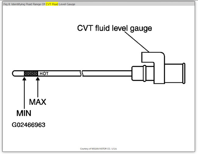

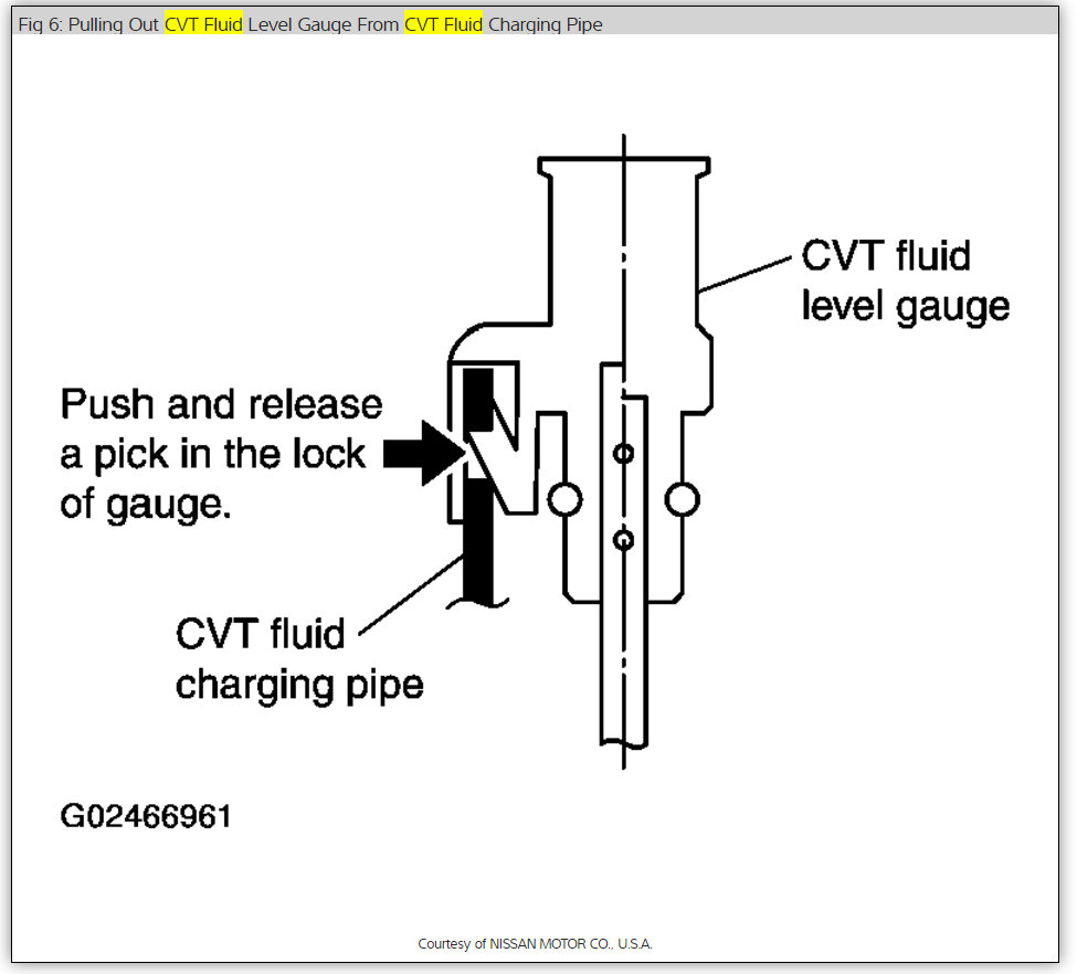

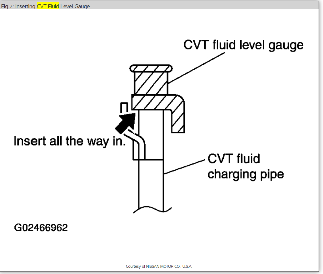

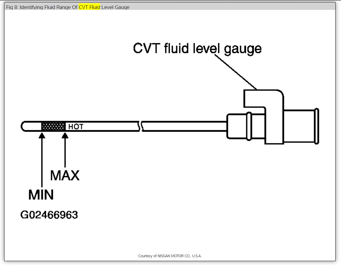

It sounds like is it low on fluid. Have you checked it? Here is a guide and a diagram on how to do it:
FLUID LEVEL CHECK
Fluid level should be checked with the fluid warmed up to 50 to 80°C (122 to 176°F). The fluid level check procedure is as follows:
Check for fluid leakage.
With the engine warmed up, drive the vehicle in an urban area. When ambient temperature is 20°C (68°F), it takes about 10 minutes for the CVT fluid to warm up to 50 - 80°C (122 - 176°F).
Park the vehicle on a level surface.
Apply parking brake firmly.
With engine at idle, while depressing brake pedal, move shift selector throughout the entire shift range.
Pull out the CVT fluid level gauge from the CVT fluid charging pipe after pressing the tab on the CVT fluid level gauge to release the lock.
Check the diagrams (Below)
Please let us know what you find Will.

Transmission fluid level turned out to be okay.
I did check the oil level as well and it was maybe about 1.5 quarts more than it should have been. I do not know if that causes anything.
