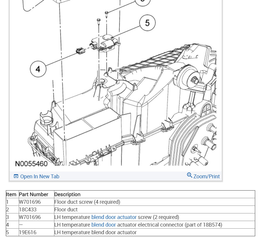

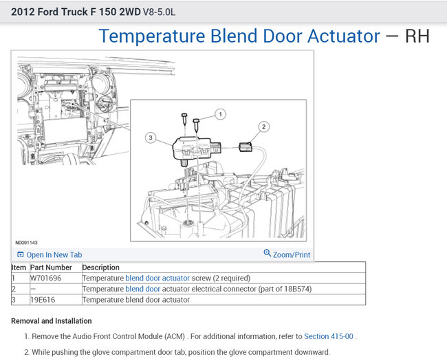

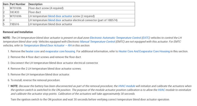

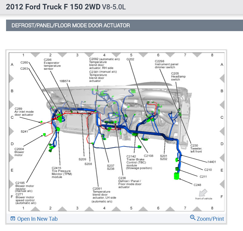

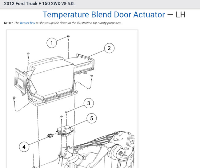

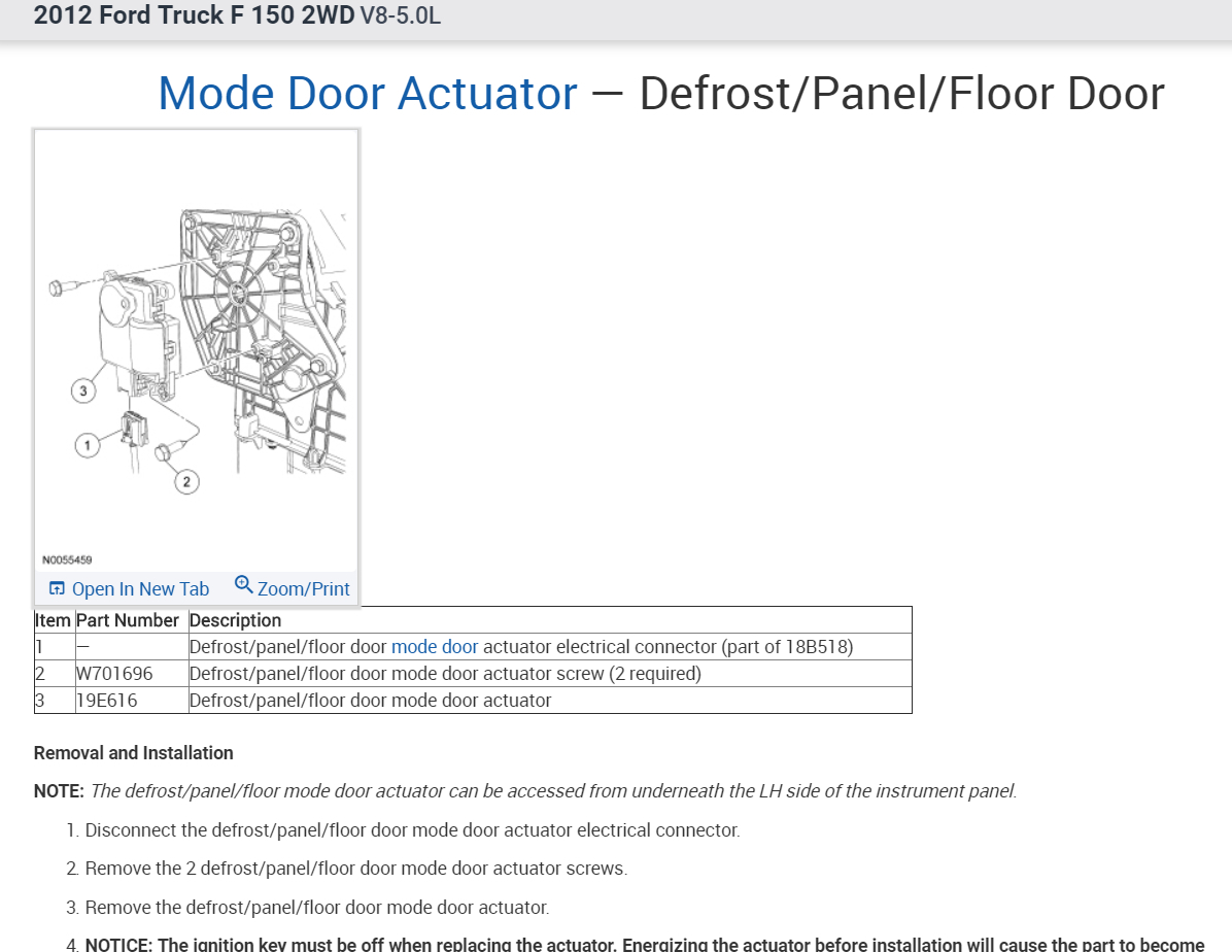

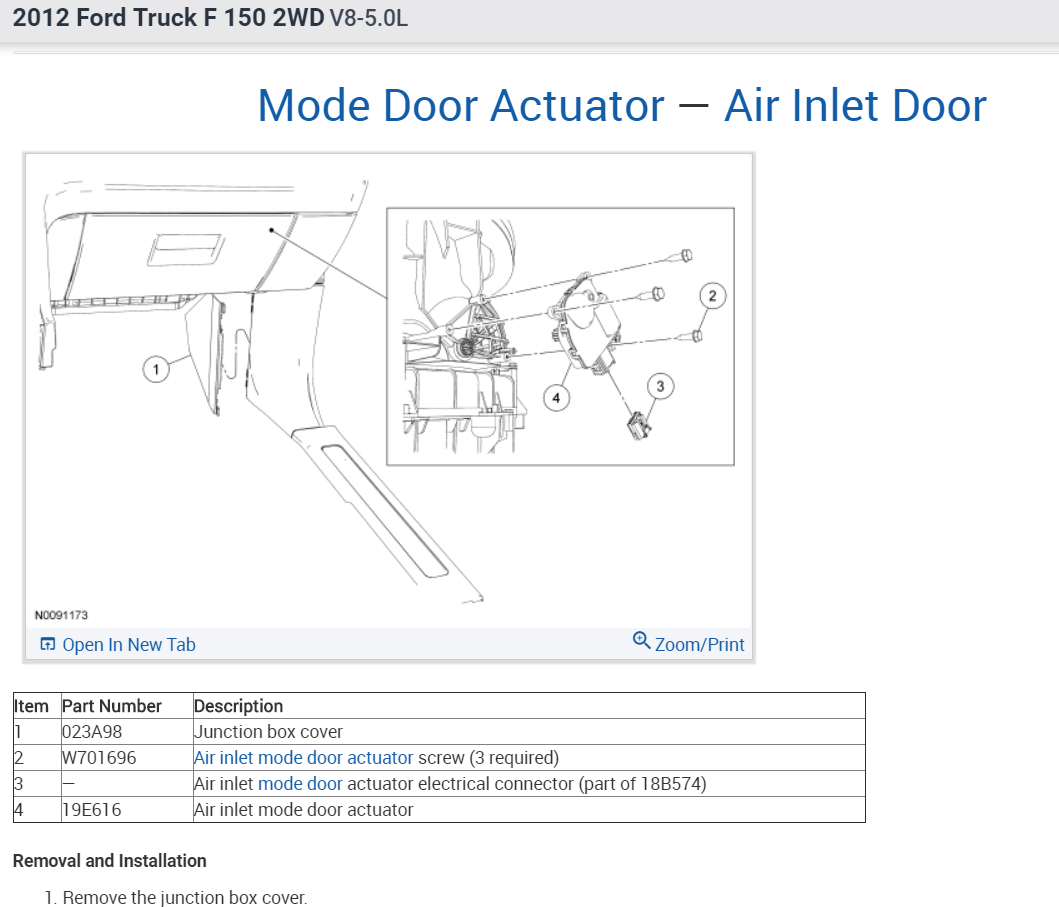

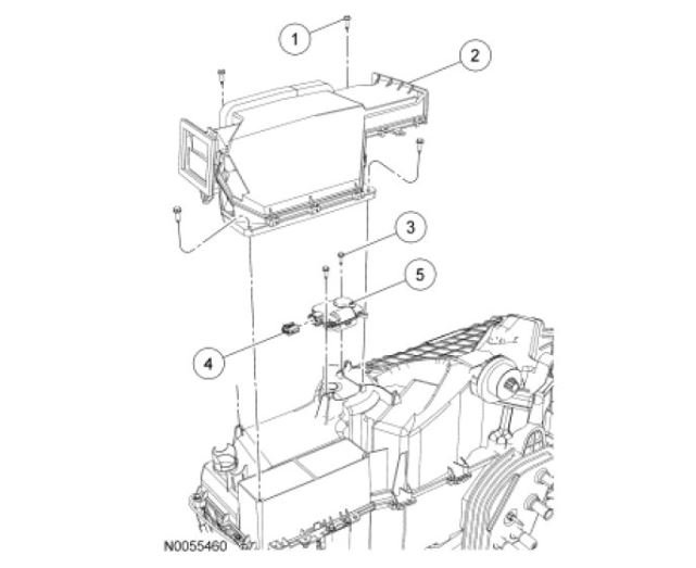

If I can jump in here. I would try to isolate the noise to the effected actuator and then replace it. Below are diagrams to show you the locations. Can you please shoot a quick video with your phone so we can hear the noise? that would be great. You can upload it here with your response. Check out the diagrams (below). Please let us know what you find. We are interested to see what it is.

Ken is correct though, you can repair it if you can feel and see it while it happens. It will involve laying on your back and reaching around under the dash, just let us know where you feel and hear the noise exactly.

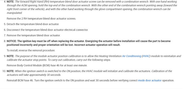

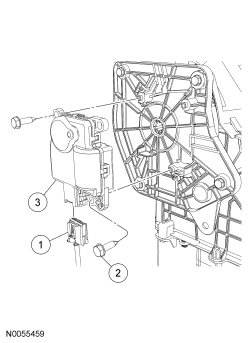

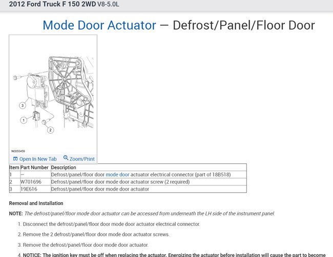

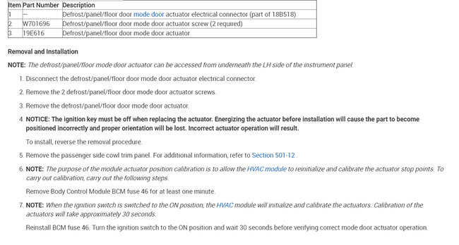

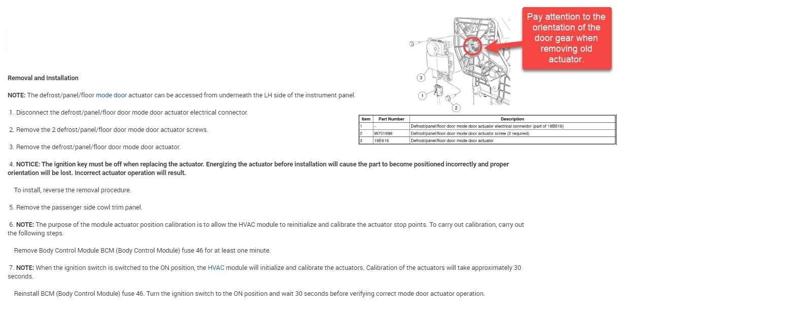

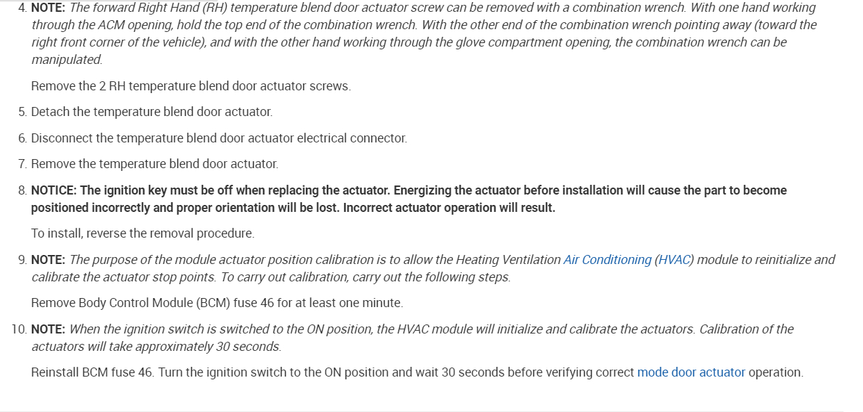

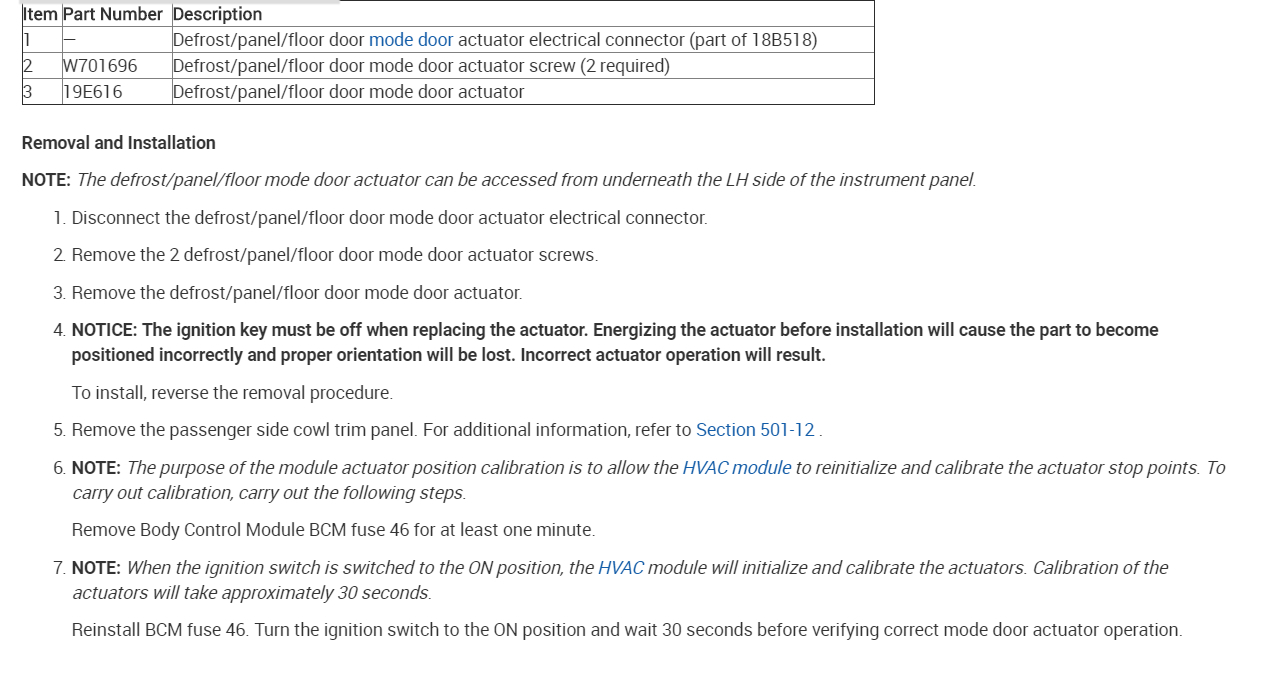

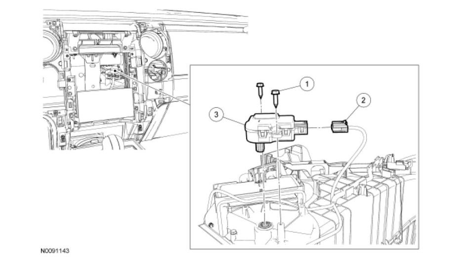

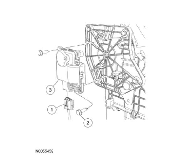

Good job on the video! This is the mode door actuator which is located on the driver side under the dash. You'll have to lay down and reach up to unscrew the 2 8mm bolts to remove the actuator, a pretty easy and straightforward job for anyone to do. After you install the new one, remove fuse #46 from the interior fuse panel behind the passenger kick panel for 1 minute then re-install it, this will recalibrate the actuator when you start the truck. I've attached a picture of the actuator for reference.

Thanks for the information and the reference picture. I will order the actuator and try to install it myself in a few weeks. I had surgery the day after I sent you the video and have just returned home, should be able to attempt the repair in about 3 weeks. Thanks for all of your help in nailing down which actuator to replace. You guys provide a great service for us DIY types.

I was able to replace the mode door actuator over the weekend and the problem is now resolved. The replacement took about 1 hour but would have gone faster if I had realized that I needed to manually rotate the mode door to get the actuator gear lined up with the mode door gear so the actuator would fit into place. Once I figured that out things went smoothly. Thanks again for all of your help.
Oct 2, 2019 at 8:10 AM
BMDOUBLE
  • 1,139 POSTS
Good deal! yeah lining that door up is a part of the job that I wish was easier, sometimes it will drop right in, then other times it will fight you to no end! Glad it worked out though!

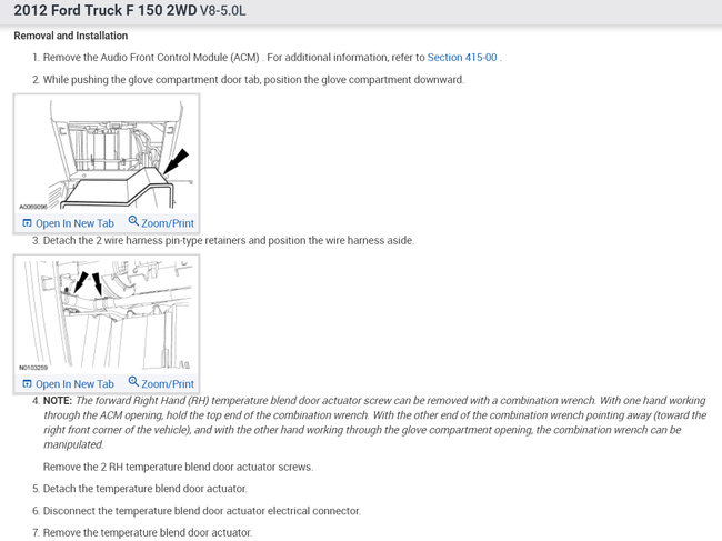

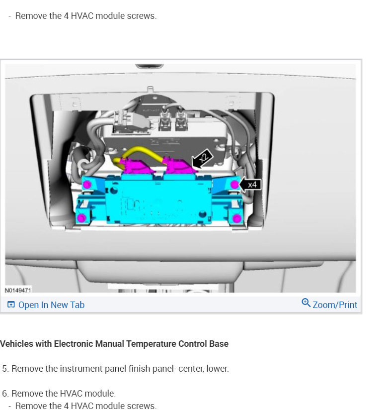

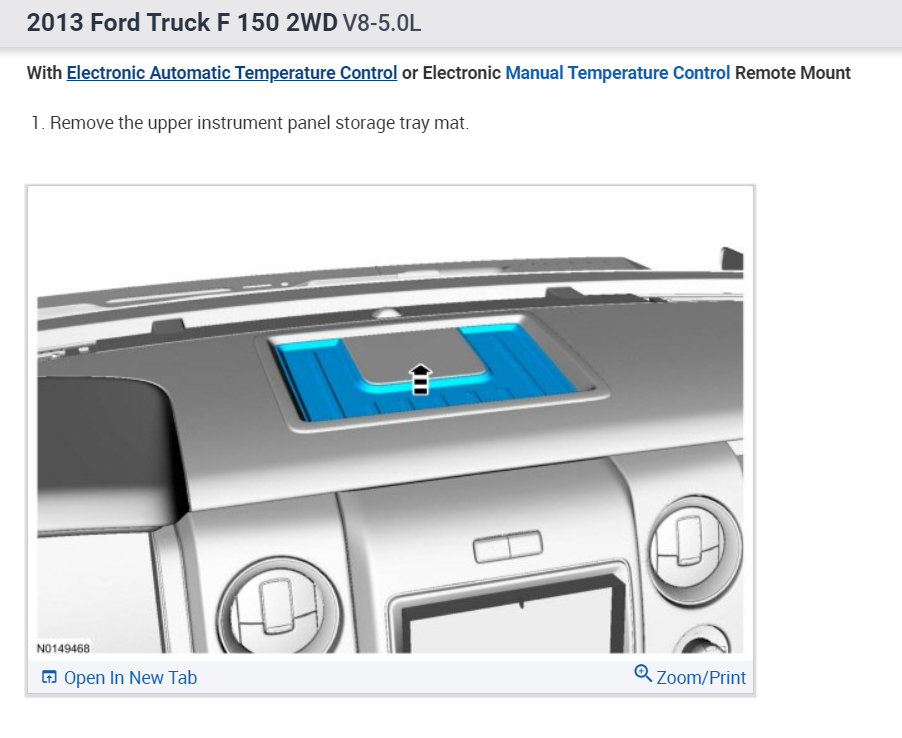

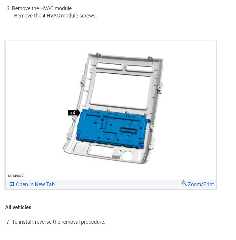

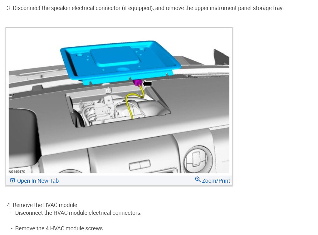

This happens when the control head goes out. here are the instructions on ow to replace it. You will need to get the part number off of it but here are some examples of cost.

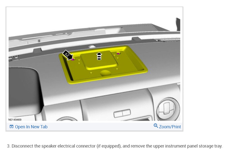

Sounds like a new mode door actuator is in your future. I have included the instructions. Check out the diagrams (below). Please let us know what happens.

Replace the driver-side mode door actuator under the dash (two 8mm bolts). Manually align the mode door gear with the actuator gear so it seats. After installation, remove interior fuse 46 behind the passenger kick panel for one minute, then reinstall it so the actuator recalibrates on startup.
