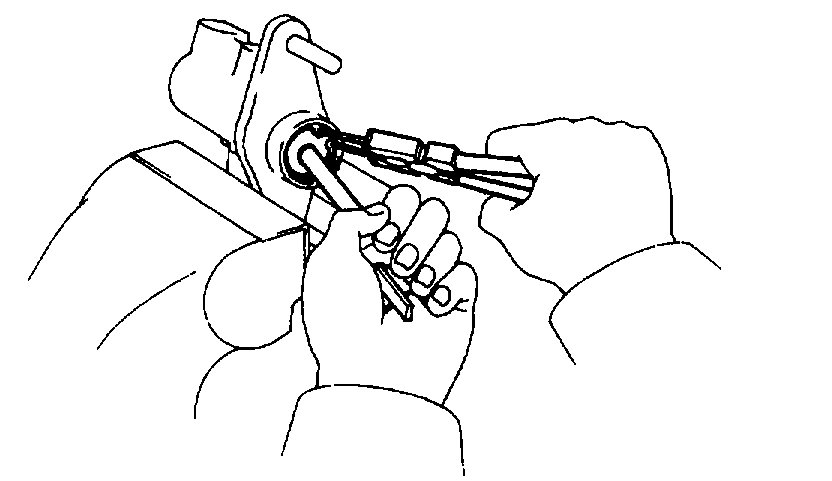

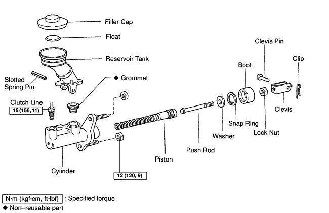

After reading your question, my first suspect is the clutch master cylinder. Here are the directions for replacement or overhaul. The attached pictures correlate with the directions.
CLUTCH MASTER CYLINDER
pic 1
COMPONENTS
REMOVAL

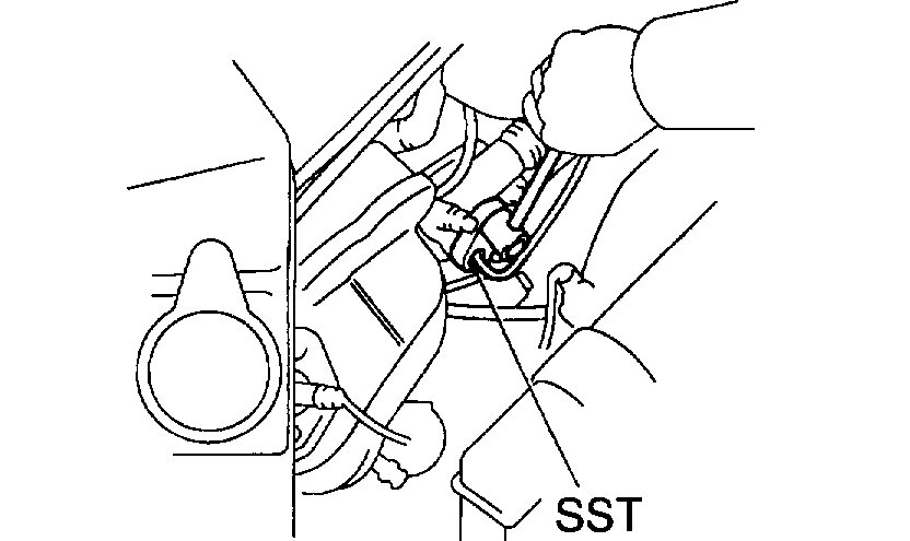

1. DRAW OUT FLUID WITH SYRINGE
pic 2
2. DISCONNECT CLUTCH LINE
Using Special Service Tool (SST), disconnect the line. Use a container to catch the fluid.
SST 09023-00100
Torque: 15 Nm (155 kgf-cm, 11 ft. lbs.)
3. REMOVE CLIP AND CLEVIS PIN
4. REMOVE 2 MOUNTING NUTS AND PULL OUT MASTER CYLINDER
Torque: 12 Nm (120 kgf-cm, 9 ft. lbs.)

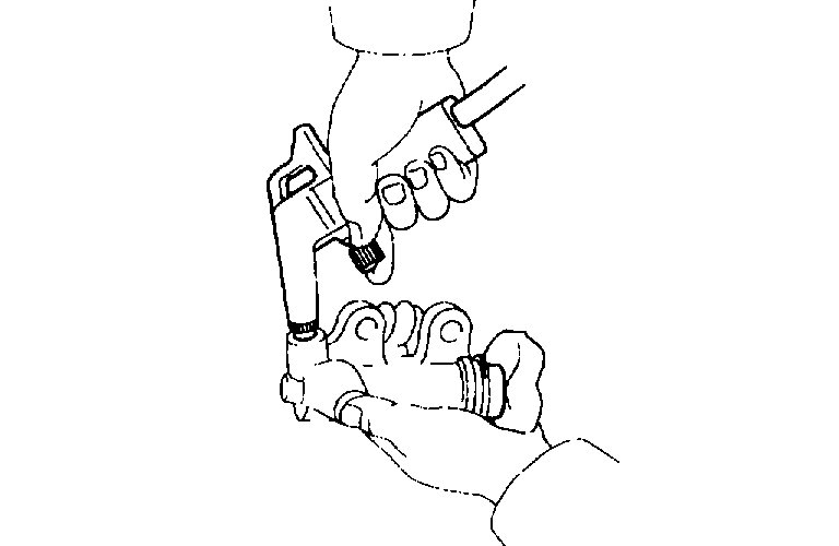

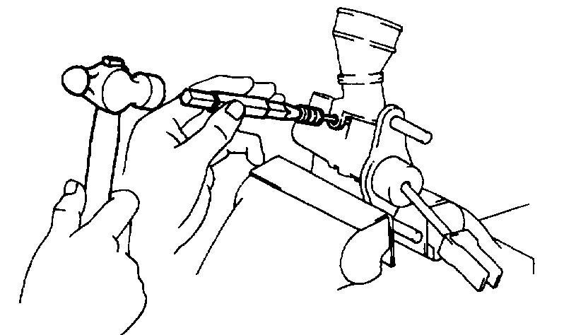

DISASSEMBLY
pic 3
1. REMOVE RESERVOIR TANK
a. Using a pin punch and hammer, drive out the slotted spring pin.
b. Remove the reservoir tank and grommet.
pic 4
2. REMOVE PUSH ROD
Pull off the boot, and using snap ring pliers, remove the snap ring.
3. REMOVE PISTON

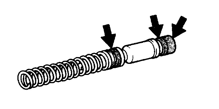

REASSEMBLY
pic 5
1. COAT PARTS WITH LITHIUM SOAP BASE GLYCOL GREASE, AS SHOWN
2. INSERT PISTON INTO CYLINDER
3. INSTALL PUSH ROD ASSEMBLY WITH SNAP RING

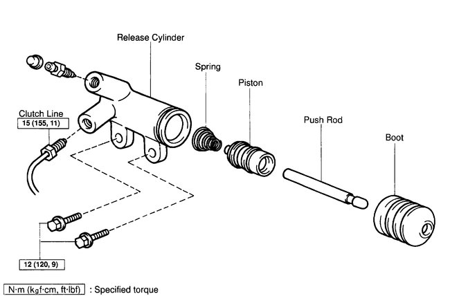

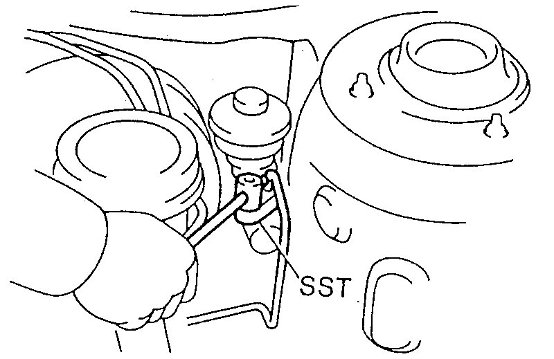

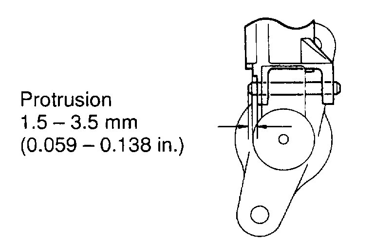

Also, here are the directions for removing, overhauling, and replacement of the clutch slave cylinder which can also be bad. The difficult thing is to determine which is the problem. Both can cause this issue, a soft or spongy clutch pedal and so on. Most commonly, you will find a leak at the slave. The master cylinder usually goes bad internally.
_______________________________________
CLUTCH RELEASE CYLINDER
pic 7
COMPONENTS
REMOVAL
pic 8
1. DISCONNECT CLUTCH LINE
SST 09023-00100
2. REMOVE 2 BOLTS AND PULL OUT RELEASE CYLINDER
DISASSEMBLY
1. PULL OUT BOOT WITH PUSH ROD
pic 9
2. REMOVE PISTON
Using compressed air, remove the piston with the spring from the cylinder.

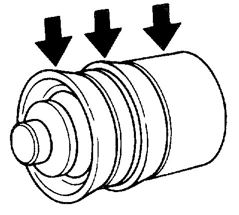

REASSEMBLY
pic 10
1. COAT PISTON WITH LITHIUM SOAP BASE GLYCOL GREASE, AS SHOWN
2. INSTALL PISTON WITH SPRING INTO CYLINDER
3. INSTALL BOOT WITH PUSH ROD TO CYLINDER
INSTALLATION
Installation is in the reverse order of removal.
HINT: After installation, bleed clutch system.

Thank you so much jacobandnickolas for your support and your knowledge. The problem was the clutch master cylinder. The customer is satisfied with the work and his face when he test the car was priceless.
