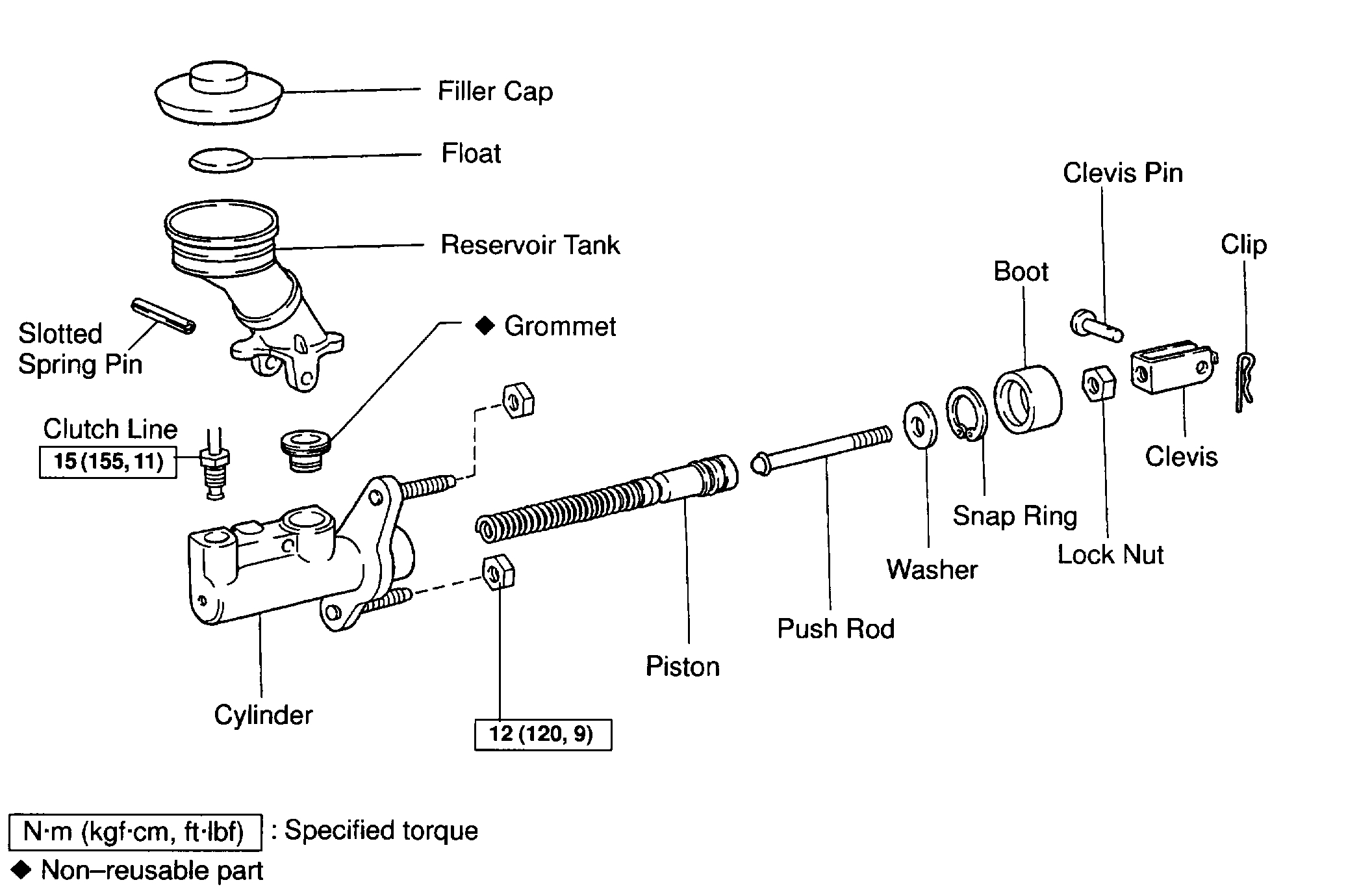

After reading your question, my first suspect is the clutch master cylinder. Here are the directions for replacement or overhaul. The attached pictures correlate with the directions.
CLUTCH MASTER CYLINDER
pic 1
COMPONENTS
REMOVAL
1. DRAW OUT FLUID WITH SYRINGE
pic 2

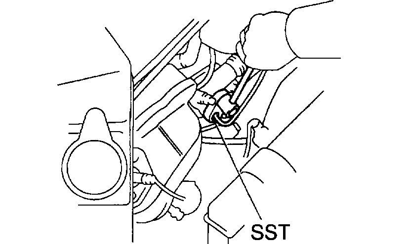

2. DISCONNECT CLUTCH LINE
Using Special Service Tool (SST), disconnect the line. Use a container to catch the fluid.
SST 09023-00100
Torque: 15 Nm (155 kgf-cm, 11 ft. lbs.)
3. REMOVE CLIP AND CLEVIS PIN
4. REMOVE 2 MOUNTING NUTS AND PULL OUT MASTER CYLINDER
Torque: 12 Nm (120 kgf-cm, 9 ft. lbs.)

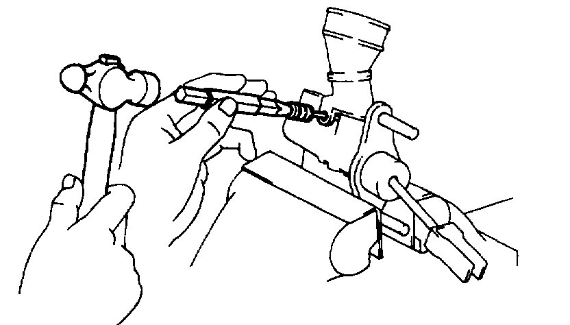

DISASSEMBLY

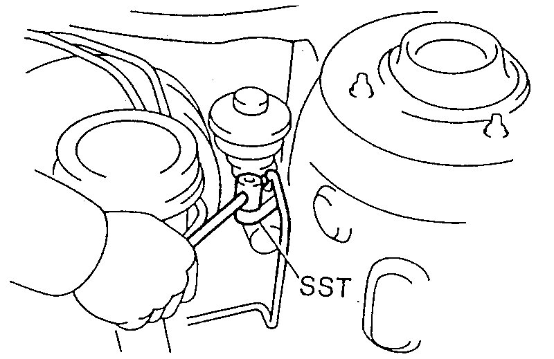

pic 3
1. REMOVE RESERVOIR TANK
a. Using a pin punch and hammer, drive out the slotted spring pin.
b. Remove the reservoir tank and grommet.

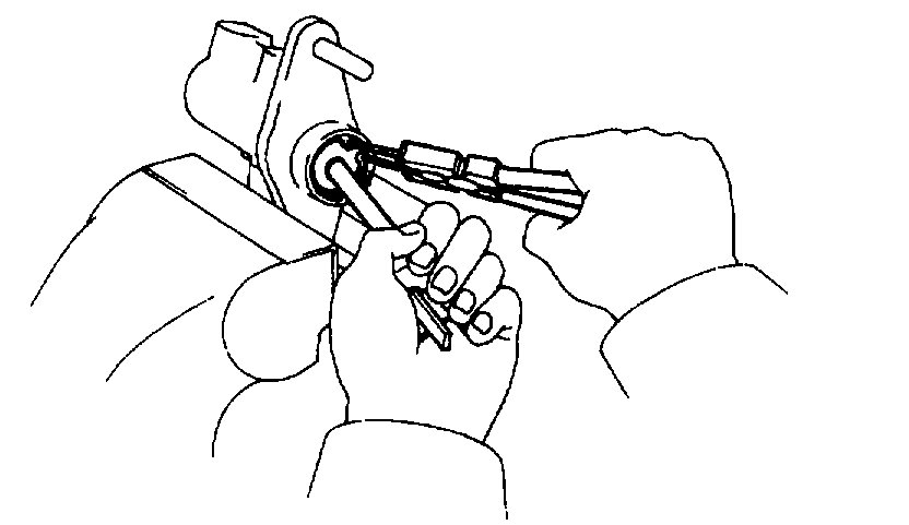

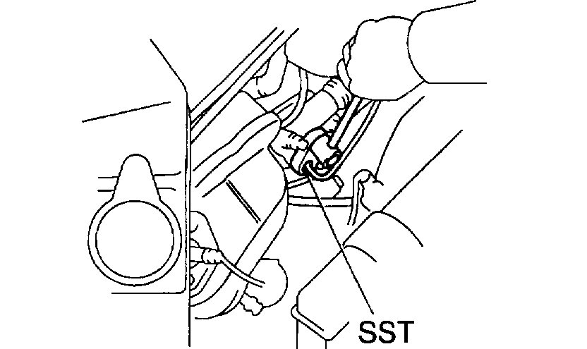

pic 4

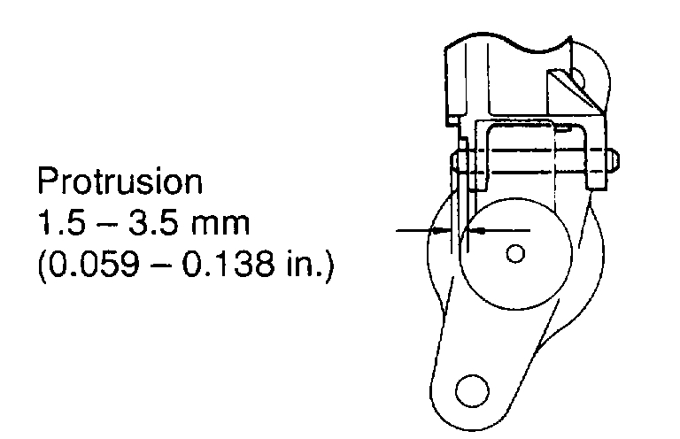

2. REMOVE PUSH ROD
Pull off the boot, and using snap ring pliers, remove the snap ring.
3. REMOVE PISTON

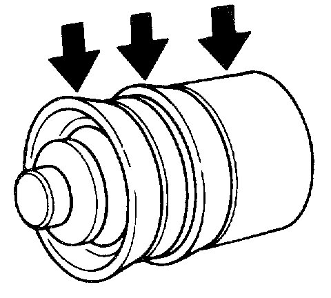

REASSEMBLY

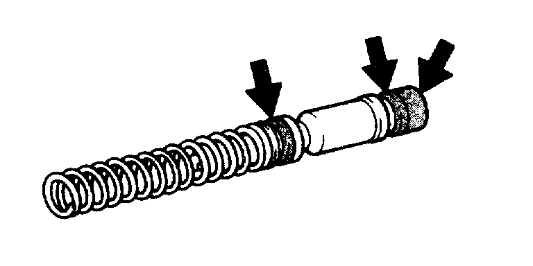

pic 5
1. COAT PARTS WITH LITHIUM SOAP BASE GLYCOL GREASE, AS SHOWN
2. INSERT PISTON INTO CYLINDER
3. INSTALL PUSH ROD ASSEMBLY WITH SNAP RING

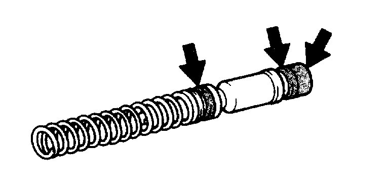

pic 6
4. INSTALL RESERVOIR TANK
a. Install the reservoir tank and a new grommet.
b. Using a pin punch and hammer, drive in the slotted spring pin.
INSTALLATION
Installation is in the reverse order of removal.
HINT: After installation, bleed system and adjust clutch pedal.

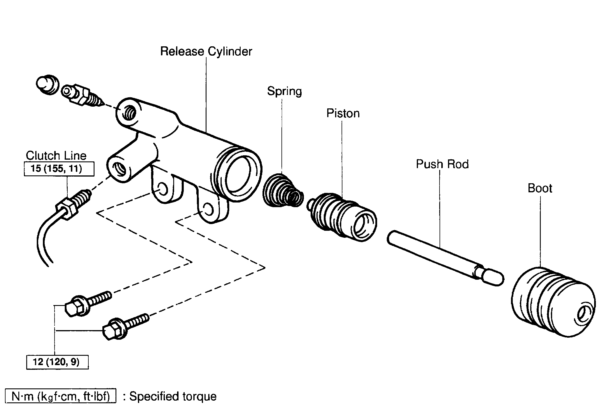

Also, here are the directions for removing, overhauling, and replacement of the clutch slave cylinder which can also be bad. The difficult thing is to determine which is the problem. Both can cause this issue, a soft or spongy clutch pedal and so on. Most commonly, you will find a leak at the slave. The master cylinder usually goes bad internally.
_______________________________________

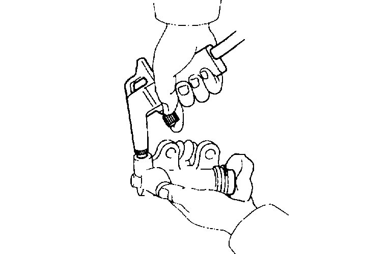

CLUTCH RELEASE CYLINDER
pic 7
COMPONENTS
REMOVAL
pic 8
1. DISCONNECT CLUTCH LINE
SST 09023-00100
2. REMOVE 2 BOLTS AND PULL OUT RELEASE CYLINDER
DISASSEMBLY
1. PULL OUT BOOT WITH PUSH ROD
pic 9
2. REMOVE PISTON
Using compressed air, remove the piston with the spring from the cylinder.
