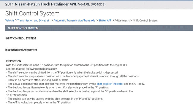

Ignition will not turn to the lock position
160,000 MILES • 2.5L • 4 CYL • TURBO • 4WD • AUTOMATIC
ROSSO_AUS
Australian Nissan Pathfinder 2011.
It has a smart key where I don’t need to insert key into barrel to turn on/off but there is a key for emergencies.
The ignition knob will not turn to lock. I can turn the car off but there is a lock position to lock the steering wheel.
I’ve put car into park, put my foot on brake, jiggled the steering wheel and only sometimes the ignition will go to lock.

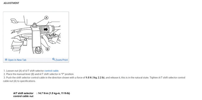

I watched the video. If I had to guess, I would say the shift lock isn't fully engaging in park. What happens if you push the shifter toward park, and then try the key?
Here is my dilemma: In the US, they don't offer the 2.5L. I looked up a 4.0L to gather some info. I found how to adjust the shifter cable that could be off a bit. Take a look through it and let me know your thoughts.
