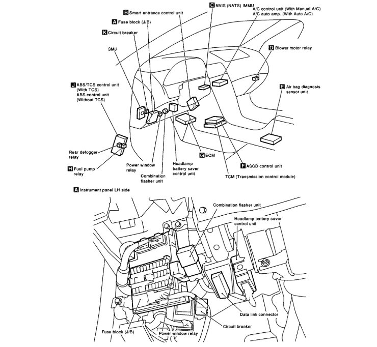

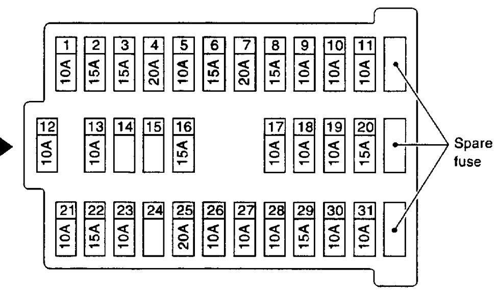

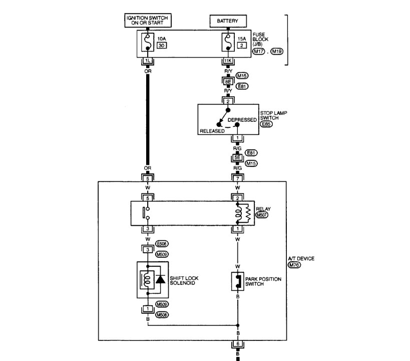

It could be the shifter is stuck and not going all into park move the the shifter from drive to park and see if it releases the ignition switch. I'm attaching fuse location and wiring diagram below check the interlock solenoid fuse and replace if blown. Check the power and ground to the interlock solenoid. Let us know if you need more information.
Thank you
Joe T.
