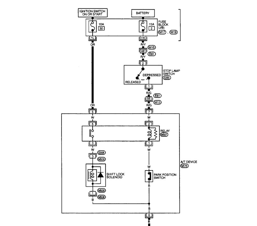

I am unable to start my car. I put the key in ignition but the key is unable to turn for the car to start. My lights and radio will come on but I'm still unable to start my car.

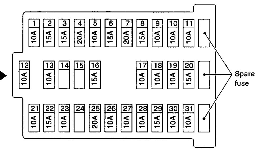

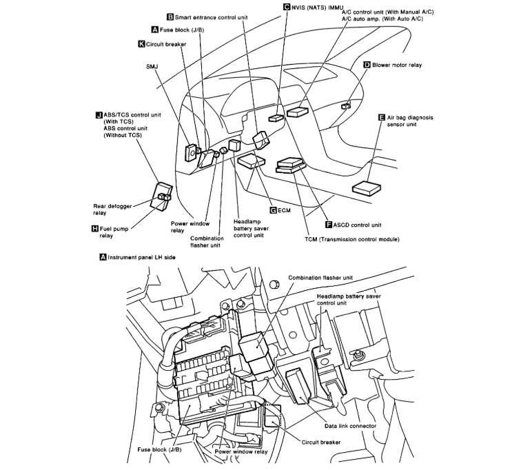

It could be the shifter is stuck and not going all into park move the the shifter from drive to park and see if it releases the ignition switch. I'm attaching fuse location and wiring diagram below check the interlock solenoid fuse and replace if blown. Check the power and ground to the interlock solenoid. Let us know if you need more information.
Thank you
Joe T.
