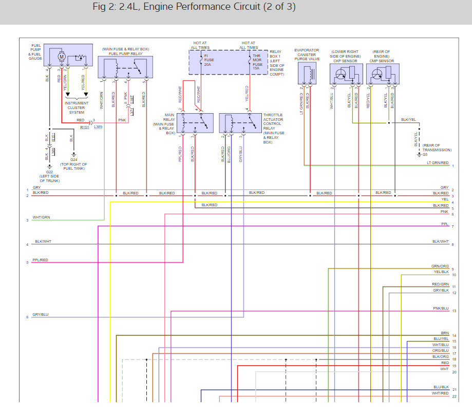

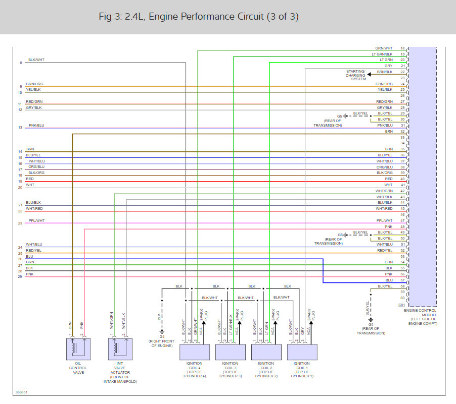

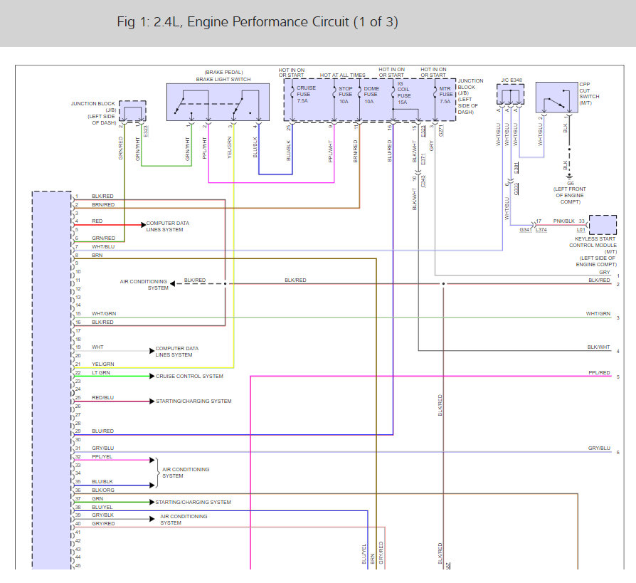

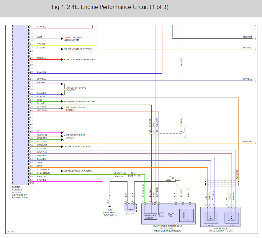

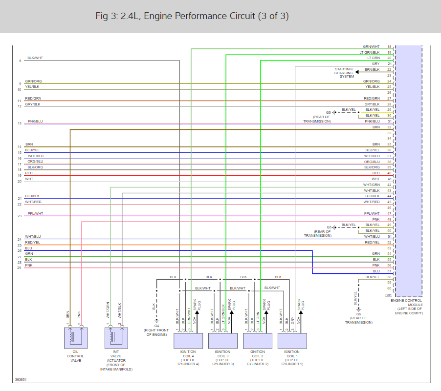

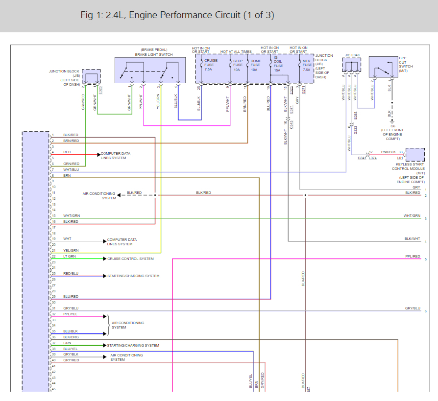

I have the vehicle listed above LXI model. I am working with my private car repair shop. I just want to know in my car's ignition coil not getting 12 volts DC current after inserting key and start. Can I give 12 volts from battery direct to coil to just start the car for one time? If yes, can you please tell how?
Sep 11, 2018 at 3:01 PM
  • 55,402 POSTS

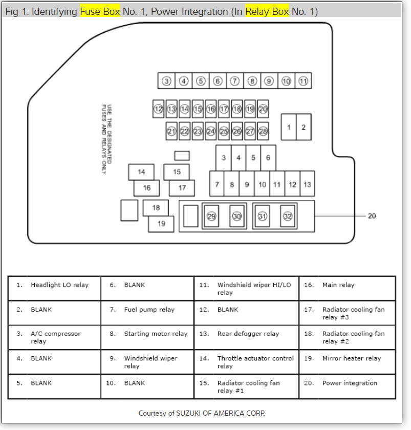

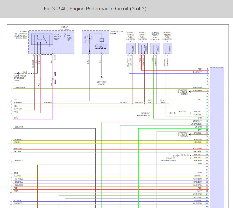

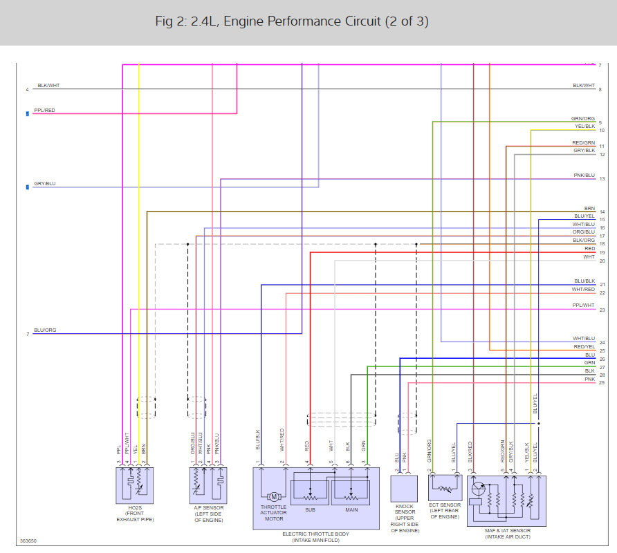

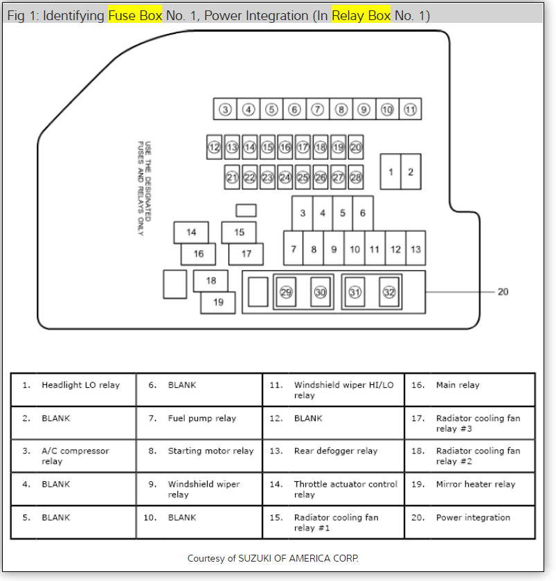

Hmm, not sure if that will work. It sounds like main relay is not working. Here is a wiring diagram for a similar car since we do not have that one in the states it should work though with a guide to help you test the relay.
