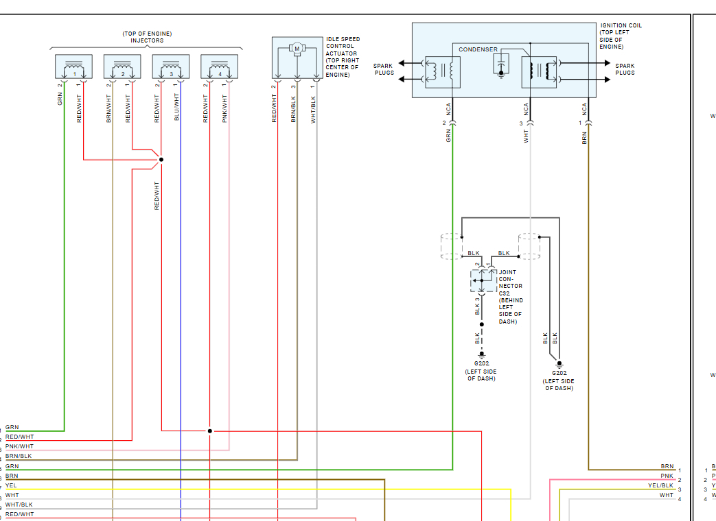

The wire harness fried. I need the wire diagram to wire the wires going to the coil pac directy without the plug until i can find a new plug to the coil pac.

Sure, I got you covered, here is the wiring diagrams for the ignition coils. Check out the images (below).
