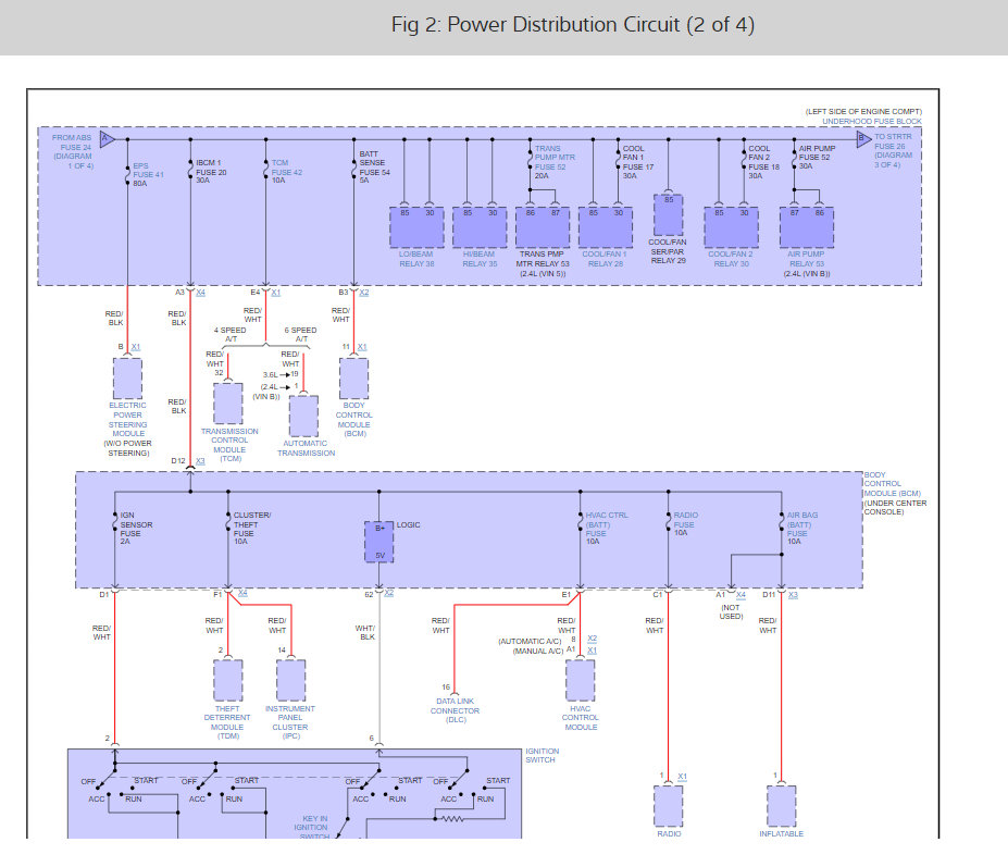

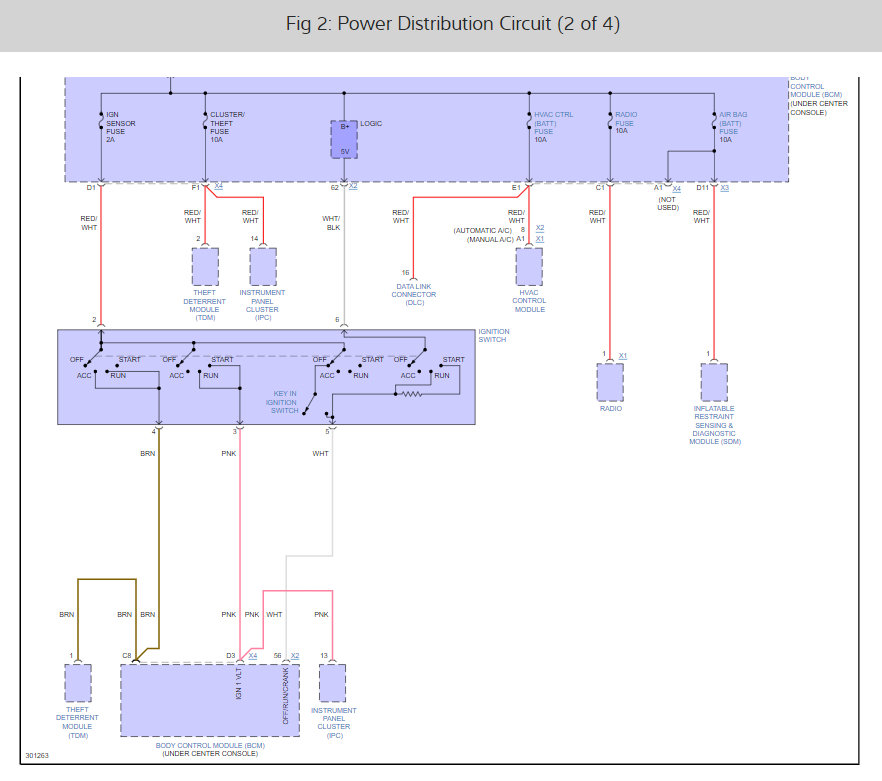

Ignition switch wiring diagram needed
2009 CHEVROLET MALIBU
190,000 MILES • 2.4L • 4 CYL • 2WD • AUTOMATIC
JAB95
Got car from a buddy, the ignition was removed and where electrical connectors plug in where broke. I got a universal keyless remote start kit and was mostly wondering what each wire in the connectors does.
May 30, 2022 at 1:29 PM
  • 55,267 POSTS
Here are the ignition switch wiring diagrams as you have requested, I have also included a guide that will help you test their connections please let us know if you need anything else.

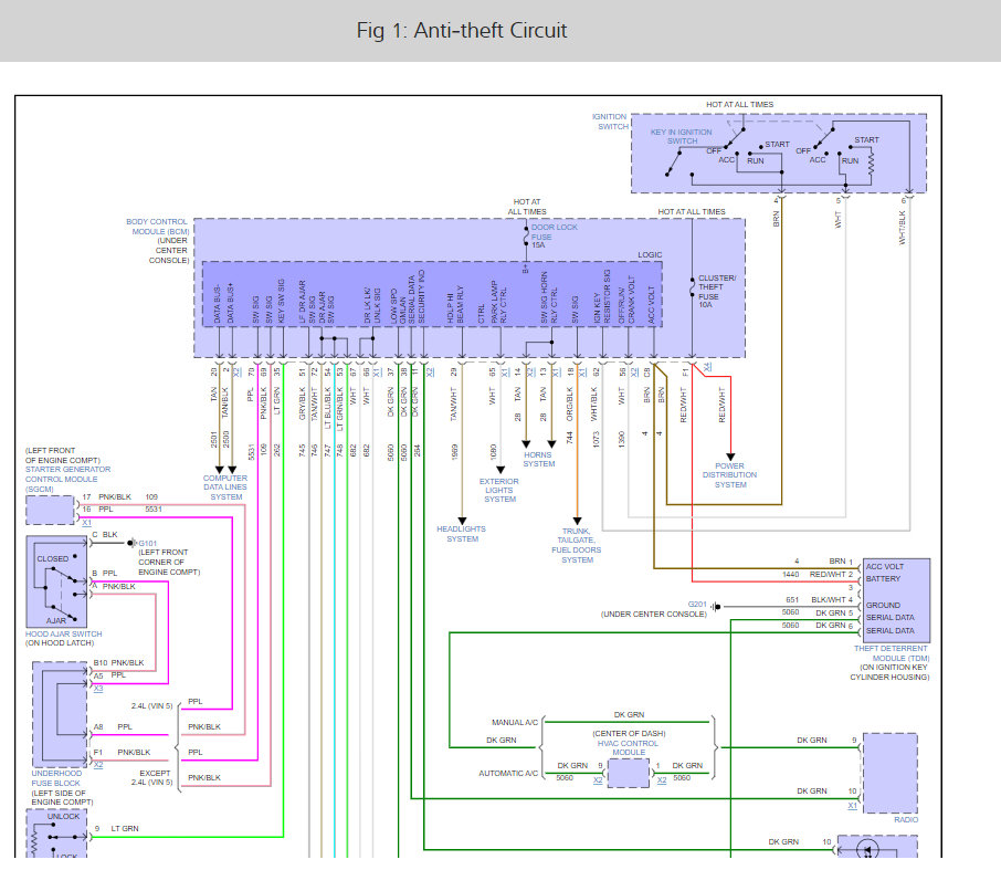

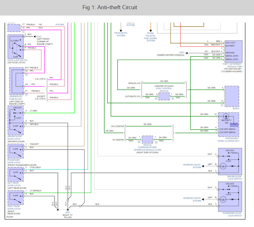

Thanks. would you have diagram for the pass lock 3 as well?
May 31, 2022 at 2:36 PM
  • 55,267 POSTS
Sure, here are the wiring diagrams for the pass lock as you have requested. Check out the diagrams (below). Please let us know if you need anything else to get the problem fixed.
