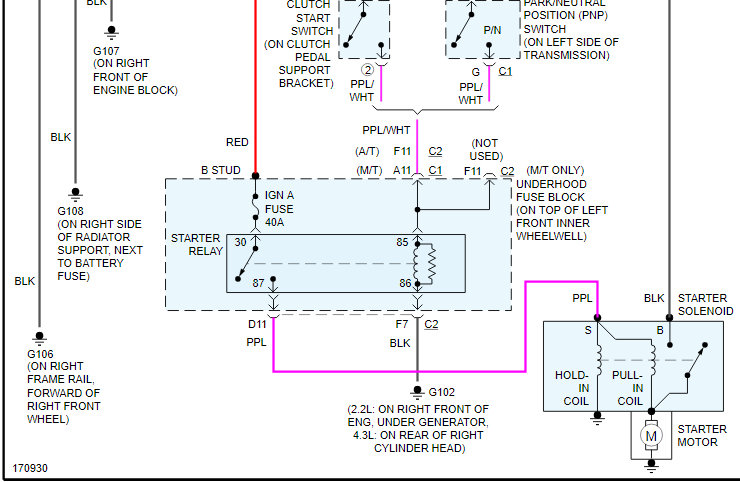

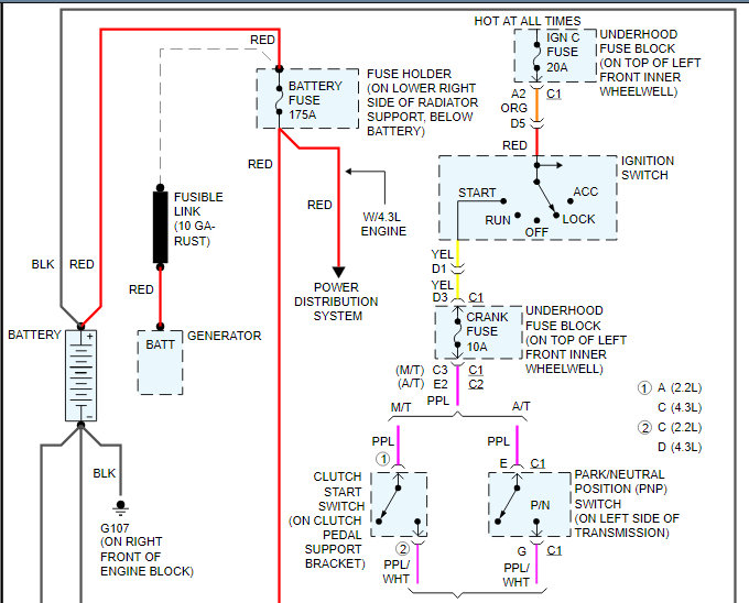

Someone tried to hot-wire my vehicle, now I have to hook wires back up but don't know where they go because they are ripped completely off of ignition. (All of them) please tell me which color of wire goes where.

Here is the starting system wiring diagram for your truck you've requested. I've cut the picture in 2 to make it a little bigger in size for you.Hope this helps and thanks for using 2CarPros.

Thanks, very helpful.
