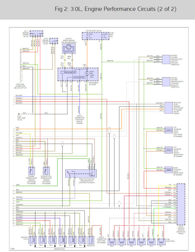

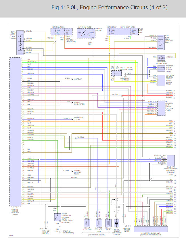

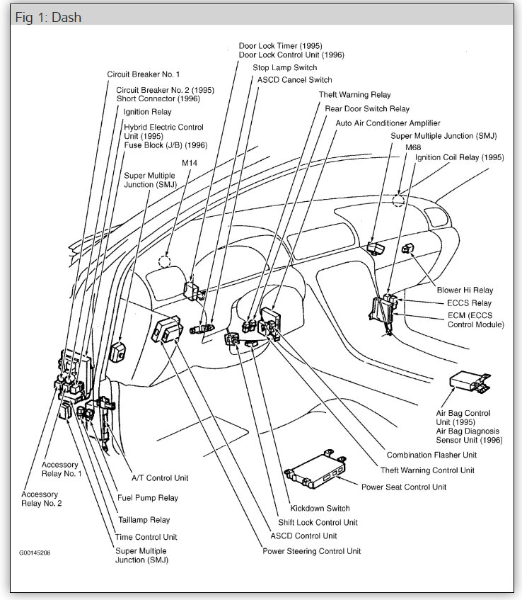

The car will not turn off by the ignition. The only way to turn it off is by pulling out the rear taillight fuse from the fuse box under the hood. If you put the fuse back in after it shut off, it is in the run position with as the dash warning lights show up just like turning on the key. Unplugging the ignition does not do anything to shut it off. When I turn the key to stop it still keeps running but shuts down like it is not getting the voltage it needs but will not shut off. Pulling the tail light fuse under the hood shuts it off.
Update:
I did not repair the problem but I guess I amputated it by disconnecting all three plugs from the remote unit in the trunk. All seems to be working fine (at least for the moment).
May 5, 2018 at 10:57 PM
  • 55,711 POSTS
It sounds like you have an ECCS relay that is sticking on. Here is an engine wiring diagram to show you how the system works and the location of the relay.
