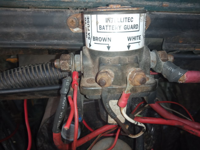

Ignition will not crank motor?
214,000 MILES • 5.8L • V8 • 2WD • AUTOMATIC
E150-94
Replaced:
Starter
Starter Solenoid-(FW)
Alternator
Ignition Switch- Keyed
Checked all fuses in Power Distribution Box
Inspected ignition Switch under the steering column
Vehicle has an anti-theft system and an Intellitec Battery Guard.
Working on:
Finishing testing all fuses under dash.
Replacing bearing in loose steering and clock spring. Air Bag light on. No horn etc.
Checking fusible links in wires running to starter solenoid.
Turning key will not crank the engine. I bypassed the solenoid by installing a push button switch directly to the battery and the starter post on the starter.
The last attempt at starting it with the key blew the number 8 fuse.

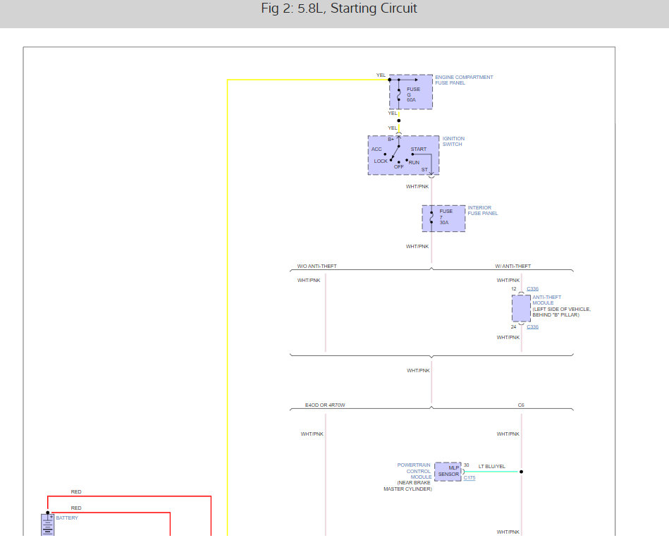

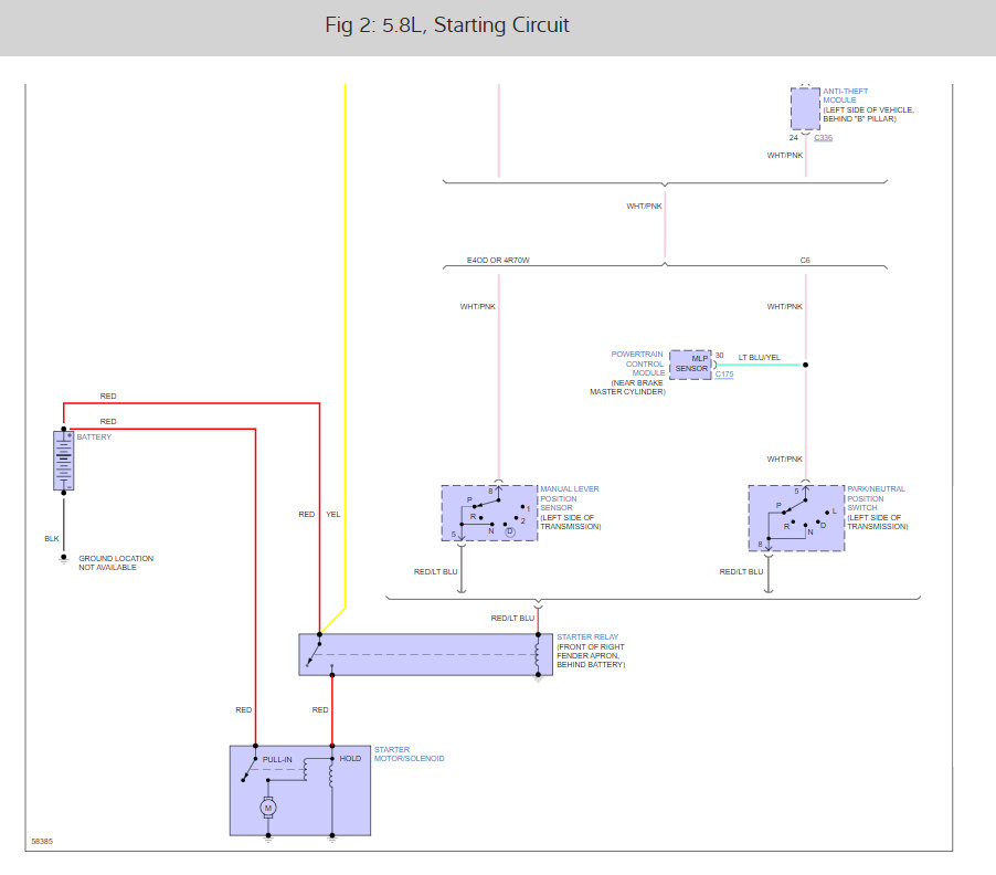

The first thing we need to do is put a breaker bar on the front of the engine (balancer) to see if the engine turns over to make sure it is not seized up. If the engine turns here is a guide to help you check for power and the starter wiring diagrams so you can see where it loses power from:
and
Check to see if you have power at fuse #7 when the key is in the crank position. Check out the diagrams (below). Please let us know what you find.

Hello Ken. Thanks for the information and the diagrams. The next time I am out, I will buy a test light.
I used my multimeter and started doing voltage tests to the starter relay. I stuck the probe in the red blue {S) wire that sends voltage to the starter. It only showed 10 volts when I turned the ignition key on and tried to start the van. I turned on my lights and tested the in going and outgoing terminals of the battery guard (with the load) and the outgoing only read 9 volts. Needless to say, I took the in and out and just joined them on the outgoing post and the E150 started right up with the key.
