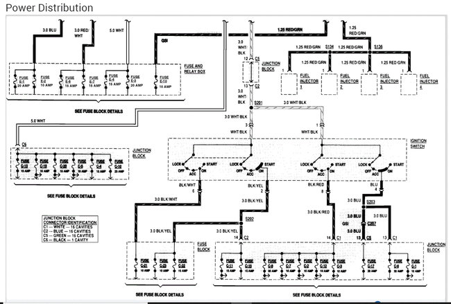

Ignition was torn out, wiring diagram needed
1991 GEO STORM
276,000 MILES
MARY KILLOUGH
So, I need to know what each colored wire is to wire a switch is and I don't have a voltmeter.

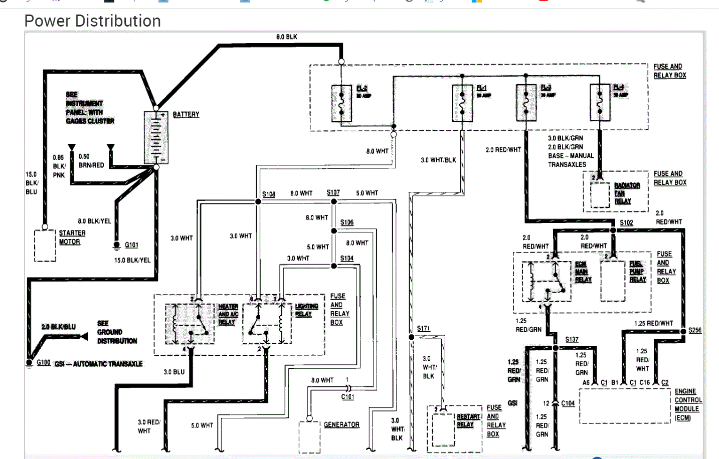

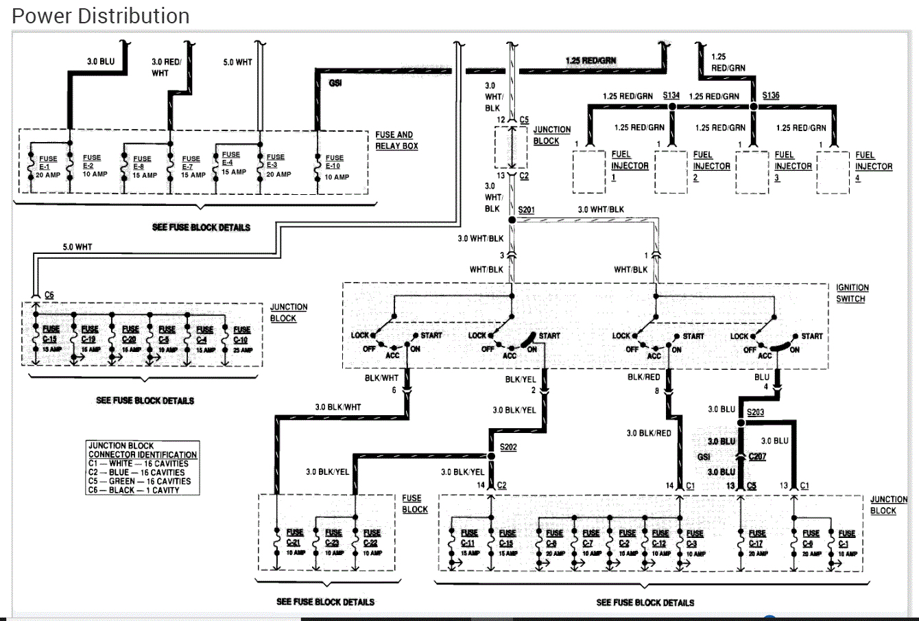

As far as the wiring is concerned, because of the model year, I only have the manufacturer schematics which are more difficult to follow. I did attach the power distribution schematics below.
If you look at the second picture, it contains the ignition switch. Take a look through it and let me know if it helps.
If you don't have a voltmeter, you can use a test light to determine if there is power present.
Take care and let me know if you have questions.
