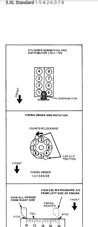

Timing diagram needed to find the correct throttle connection
84,000 MILES • 5.0L • V8 • 2WD • MANUAL
JR BRøWñ
I just bought a 650 speed Demon carburetor. If anyone could get back to me with some advice or places to look that would be great, thank you.
Jun 23, 2022 at 12:56 AM
  • 55,711 POSTS

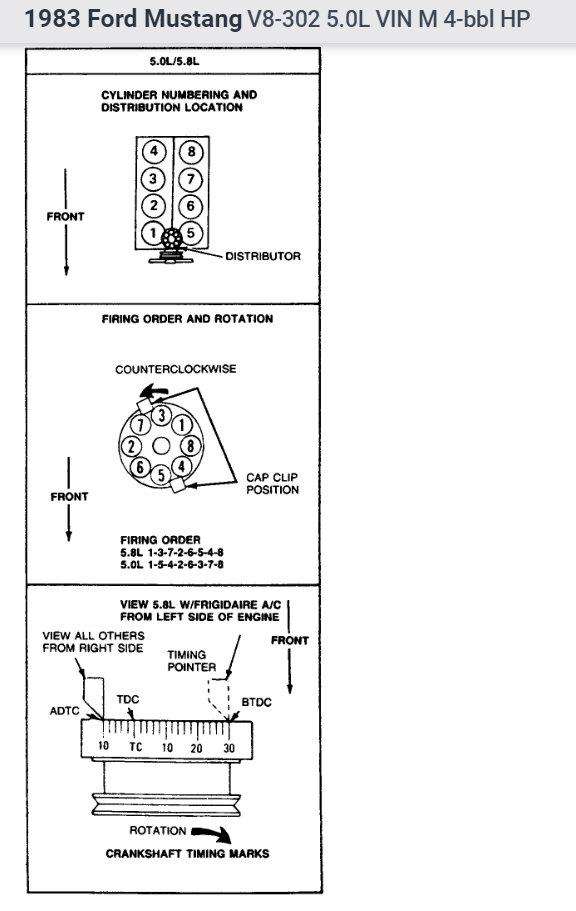

Can you upload some images or shoot a quick video of what you are trying to do? Do you need the firing order? Check out the diagrams (below). Let us know what happens and please upload pictures or videos of the problem.
