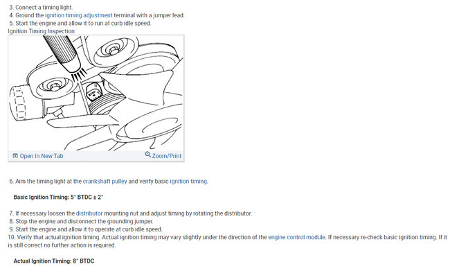

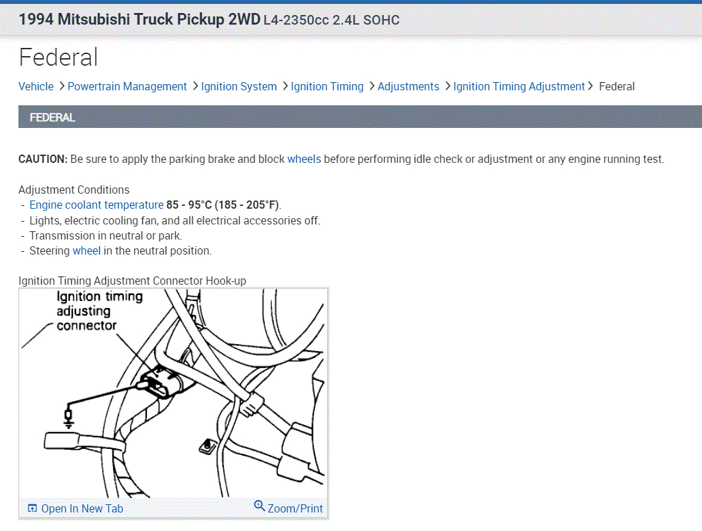

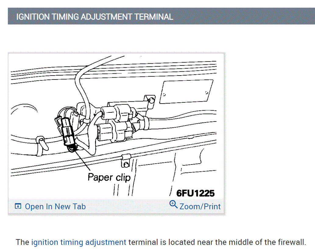

Can you give me where to ground the ignition timing adjustment terminal with a jumper lead?
Sep 21, 2021 at 4:56 PM
  • 110,244 POSTS

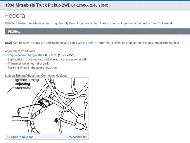

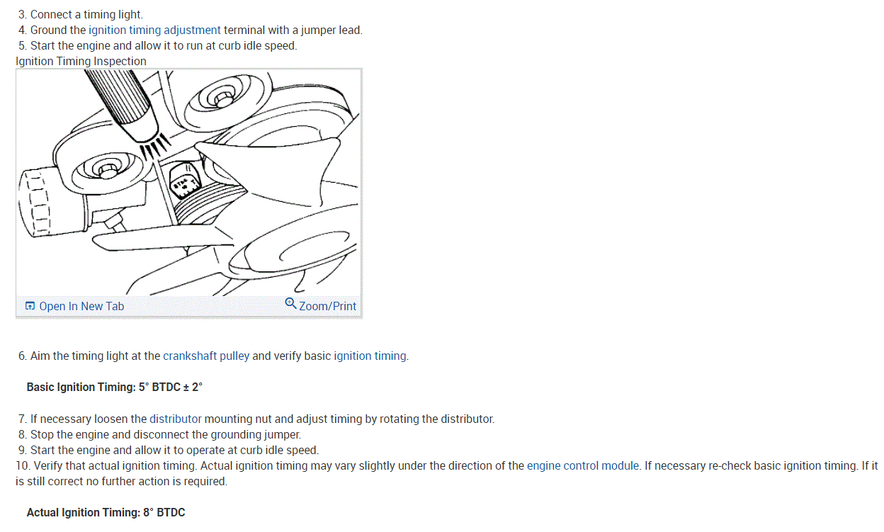

According to the manual, it just needs to be grounded to a known good ground. There isn't any specific place.
If you look at the directions below, they are the steps specific to your vehicle. Take a look through them and let me know if they helps.
Sep 22, 2021 at 10:14 AM
PACIFICISLANDER
  • 239 POSTS
Joe, it is right on the money got the timing adjusted and curb idle. Thank you my friend stay safe, have a nice day.

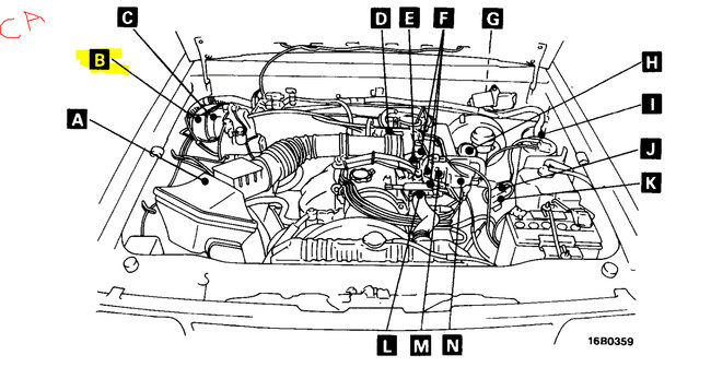

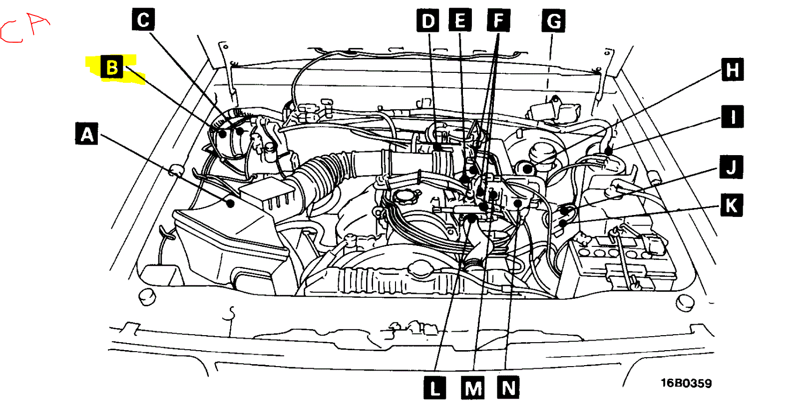

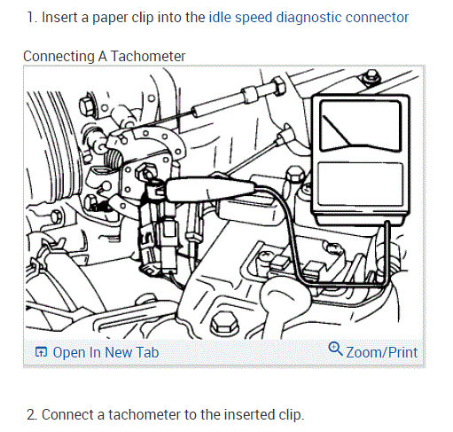

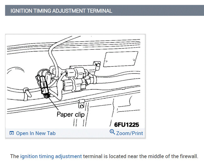

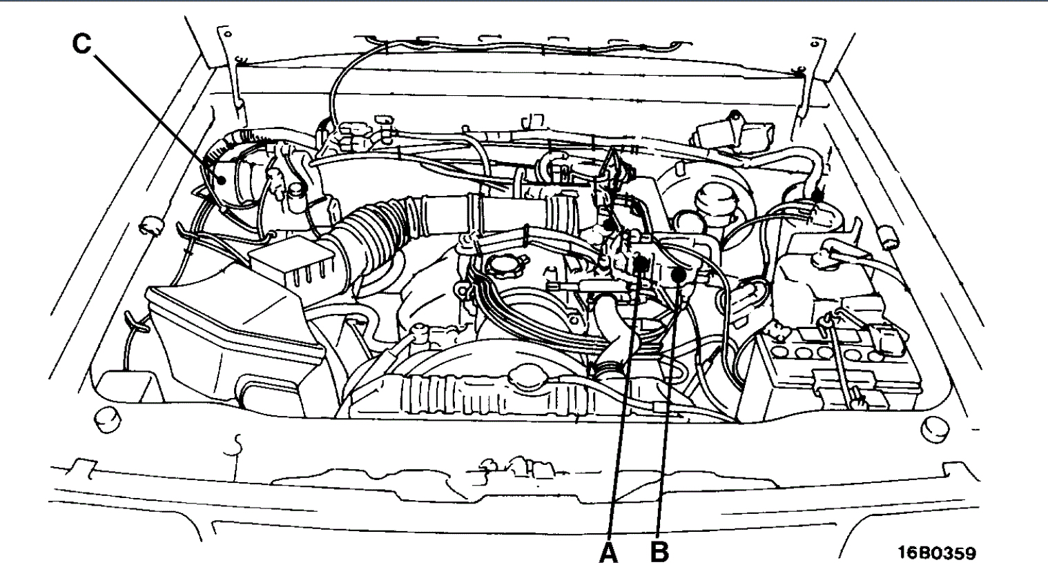

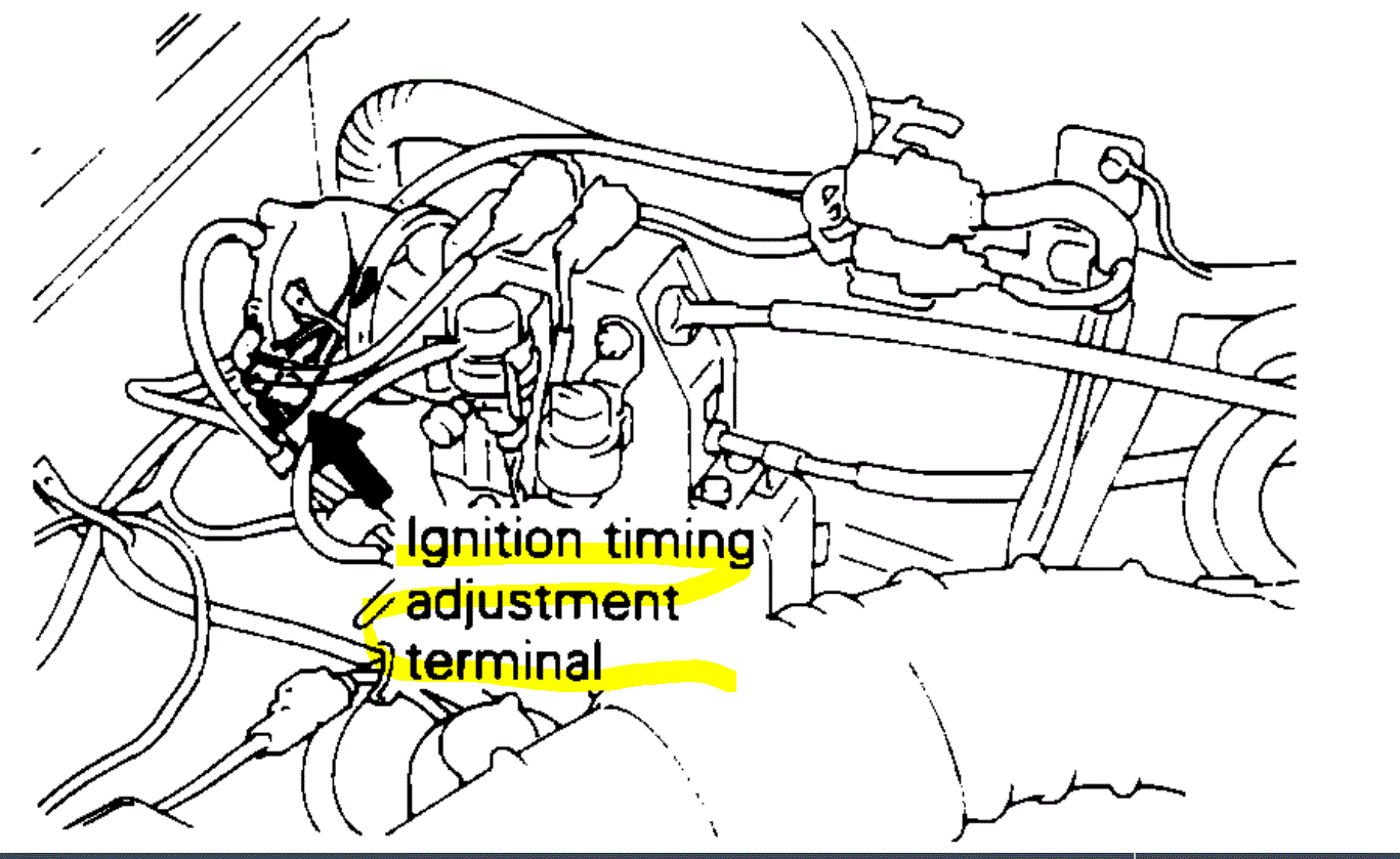

Once again can you provide me the exact location of the ignition timing adjustment terminal at? going nuts trying to find it.
Sep 24, 2021 at 8:38 AM
  • 110,244 POSTS
No problem. The first two pics show it from two different angles. Pic 3 shows it with CA emissions and pic 4 is federal emissions.
I hope this helps.
Sep 24, 2021 at 11:57 AM
PACIFICISLANDER
  • 239 POSTS
Perfect as usual my friend. pic #1 is the actual illustration, got it retime perfectly set. no problem, once again thank you for all your help, Joe Be seeing you in the near future.
