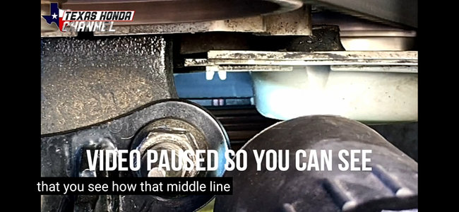

I the car listed above SE that hit the gas. now it acts like it want to stall at the stop sign. someone said the timing could be off. so I was going to check it and I found a video that is similar and I took a screenshot of it to see if that is correct.

This is what I found on YouTube:
Mar 11, 2021 at 7:45 AM
  • 110,241 POSTS
I'm not sure what I am seeing in the pic. It looks like the transmission pan.
As far as the issue, timing usually doesn't change unless something is left loose. And actually, it isn't adjustable on this vehicle.
Do me a favor. Let me know exactly what is happening, if anything happened to cause it, or anything you can think of that may help.
I have to be honest, it sounds like it could be an engine vacuum leak or even a fuel pressure issue.

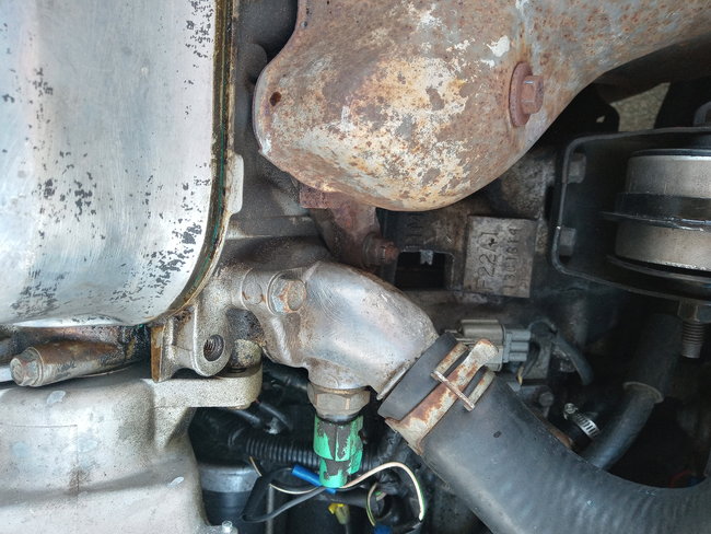

This is the one I'm messing with.
Mar 11, 2021 at 1:22 PM
  • 110,241 POSTS
I don't mean to be a pain, but I'm looking at an exhaust manifold and a thermostat housing. Neither one deals with timing. Also, the timing is not adjustable. It is controlled by the PCM.
If possible, record it cranking and running so I can hear it. If it is a timing issue, I should be able to tell when it is cranking.
