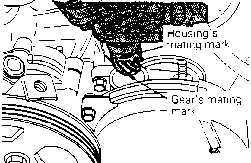

I replaced my head gaskets on my car 3.0l SOHC I got the timing marks lined up perfect for the engine timing and I lined the distributor rotor button to and the car fires right up but idles very high no matter how much I adjust it. I set the rotor button to point at the number one plug on the cap at TDC the car starts right up and runs, but misses really bad. when I take off and accelerate I replaced distributor exc. my question is, when you position the rotor button will it point directly at the number one point of contact inside the cap or will it be a hair offset from it? And my other question is, can the ignition timing not being right on cause it to miss like that? And the heat gauge will start to rise going up hill but go back down on the flat. can anyone help me figure this out?
Jan 17, 2020 at 3:11 PM
  • 110,241 POSTS
The rotor should be very close to pointing directly at cylinder 1 on the cap. Get it as close as possible and then you will need to turn it for adjusting ignition timing.
Here are the directions for installing the distributor. See if it helps. The attached pics correlate with the directions.

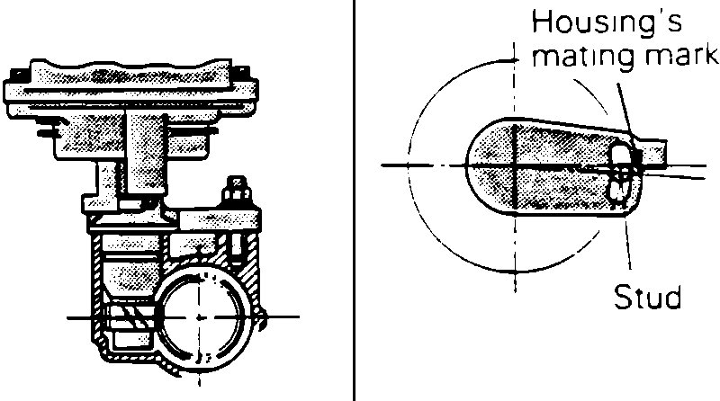

1. Turn the engine so that the piston of the number one cylinder is at top dead center of the compression stroke.
CAUTION: Care should be taken to insure that the number four cylinder is not used by mistake.
2. Align the distributor housing and gear mating marks.
3. Install the distributor into the engine while aligning the distributor's installation flange with the center of the distributor installation stud.

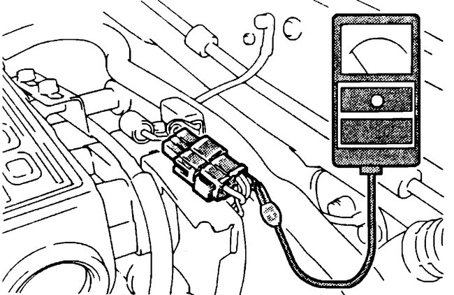

Tachometer Hookup
pic 3

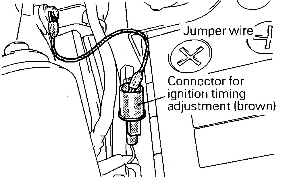

1. Install a paper clip into the tachometer check connector.
2. Connect a tachometer to the clip.

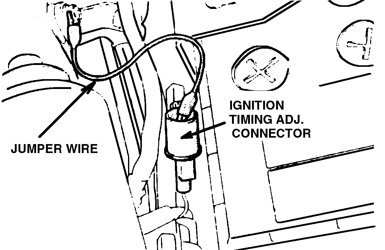

Ignition Timing Adjustment Connector
pic 4
3. With the engine OFF, ground the ignition timing adjustment terminal with a jumper lead.
4. Start the engine and allow it to run at curb idle speed.
5. Connect a timing light to the #1 spark plug wire and check the timing.
Basic Ignition Timing
5° ±2° BTDC.
6. If necessary loosen the distributor mounting nut and adjust timing by rotating the distributor.
7. Stop the engine.
8. Disconnect the ignition timing jumper wire and RE-START the engine.
9. Recheck the timing.
Actual Ignition Timing
15° BTDC.
NOTE: Actual ignition timing may vary slightly under the direction of the MPI controller. If necessary re-check Basic Ignition Timing. If it is still correct no further action is required.

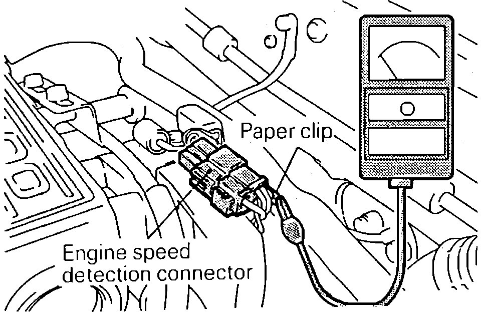

Tachometer Connection Using A Paper Clip
pic 5
1. Insert a paper clip into the 3-pin connector from the harness side of the connector. Do NOT disconnect the connector.
2. Connect a primary-voltage-detecting tachometer to the paper clip.
NOTE: The tachometer should indicate 1/3 of the actual engine speed. Multiply the tachometer reading by 3 for the actual engine speed.

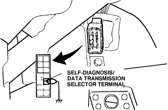

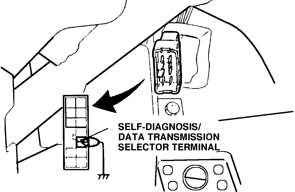

Self-Diagnostic Connector Grounded (under dash drivers side)
pic 6
3. Using a jumper wire, ground the # 10 terminal of the Self-Diagnosis connector.

The info definitely helps. I aligned the rotor to where it pointed directly at the number one point of contact inside the cap, but it still misfires bad when i accelerate. but it starts fine but idles high. should I move it just hair offset from where I have it now?
Jan 17, 2020 at 3:48 PM
LUKEMINDY
So when I align the the distributor marks up and fit the distributor down onto it's stud that's where the right position for the rotor is?
Jan 17, 2020 at 3:58 PM
  • 110,241 POSTS
As long as the engine is at TDC, the rotor should be pointing at number one on the cap. Once the cap is on and the engine is running, then you need to use a timing light to get the correct timing.

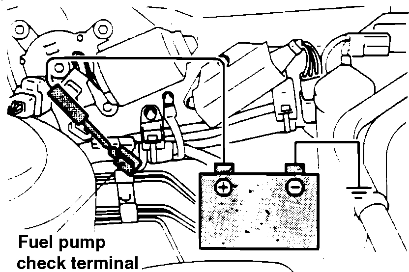

Fuel Pump Operational Test Hook-up
pic 1
2. Apply battery voltage to the fuel pump drive connector to power the fuel pump.
3. Pinch the fuel hose to check that fuel pressure is felt.
NOTE: The fuel pump is mounted in the fuel tank and it operates submerged in fuel, therefore its operating sound is hard to hear without removing the fuel filler cap.

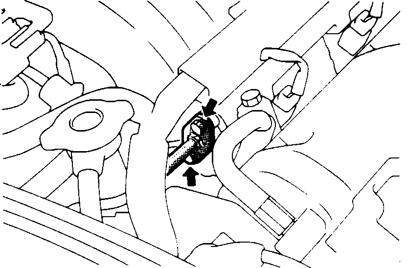

High Pressure Fuel Hose Connection
pic 2
2. Disconnect the high pressure fuel hose at the delivery end.
CAUTION: Cover the hose connector with a shop towel to prevent splashing of fuel caused by residual pressure in the fuel line.

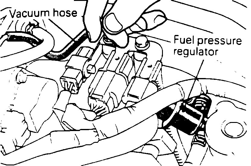

Fuel Pressure Gauge Installed
pic 3
3. Using the fuel pressure gauge adapter (MB998742) or equivalent, install the fuel-pressure gauge to the delivery pipe (fuel rail).
4. Connect the battery negative terminal.
5. Apply battery power to the fuel pump drive terminal to activate the fuel pump. With fuel pressure applied check that no fuel is leaking at any of the connections.

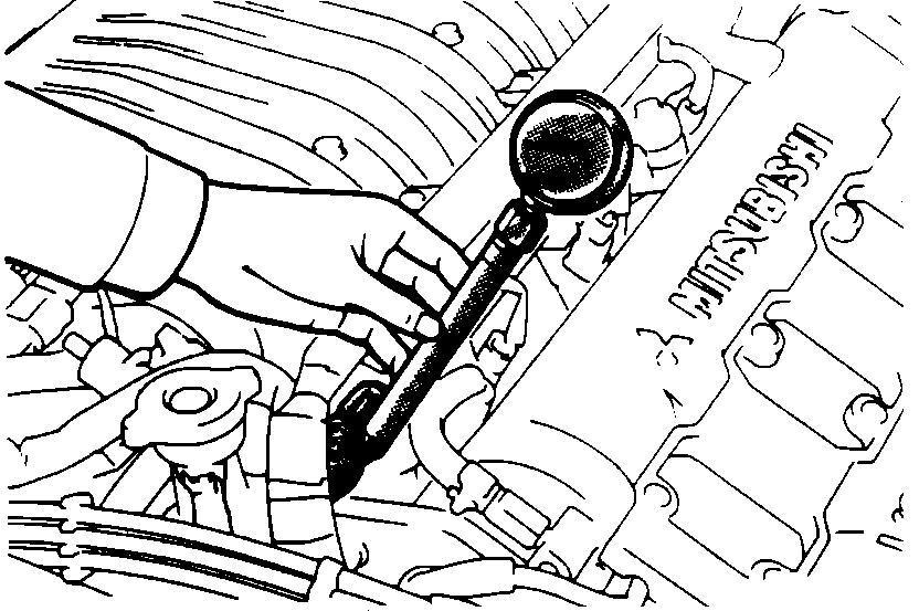

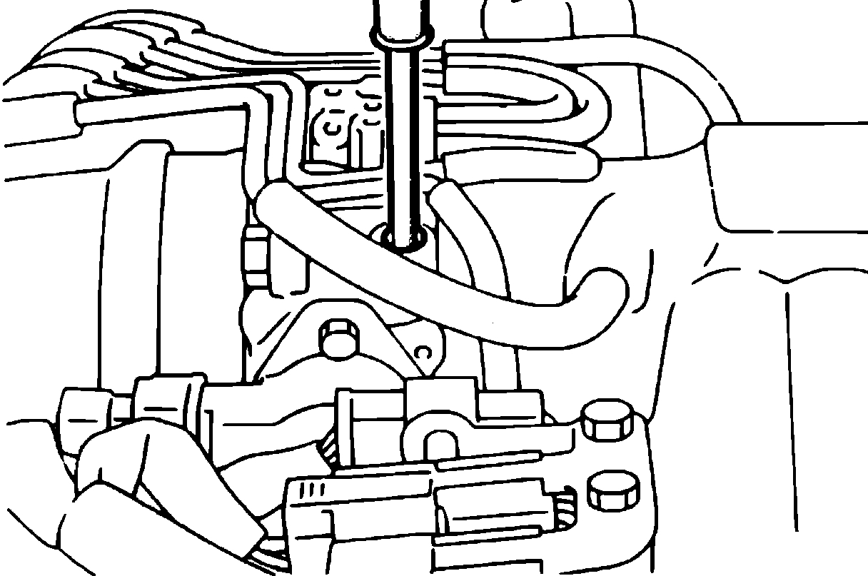

Fuel Pressure Regulator, Vacuum Control Line Removed
pic 4
6. Disconnect the vacuum hose from the pressure regulator, and plug the hose end. Measure the fuel pressure at idle.
Standard Value:
47 - 50 psi (330 - 350 kPa).
7. Measure the fuel pressure when the vacuum hose is connected to the pressure regulator.
Standard Value:
38 psi (270 kPa)
NOTE: At the completion of steps 5 thru 7, prior to turning the ignition off, disconnect the battery power to the fuel pump drive terminal. If the engine stops and NO fuel pressure is observed, refer to COMPUTERS AND CONTROL SYSTEMS to diagnose the fuel pump power supply problem.
8. If the results of the measurements made in steps 6 and 7 are not within the standard values, refer to the symptoms listed below to determine the probable cause and make the necessary repairs before re-testing.
