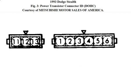

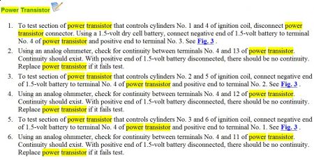

i have 3 sets of coil packs 1 set is not firing to 2 plugs could my power transistor be the problem? or is there something more that it could be?
Mar 17, 2010 at 7:38 AM
JDL
  • 16,098 POSTS
I found this info in the MOD database. For testing.
https://images.2carpros.com/forum/automotive_pictures/170934_30_dohc_1_1.jpg
https://images.2carpros.com/forum/automotive_pictures/170934_30_dohc_2_1.jpg

thanks jdl im going to go ahead and replace the transistor i switched coil packs and the one i put in its place doesnt fire neither so im ruling the transistor is bad i know for sure the coils are good but if that doesnt fix it what else could it be? ecm maybe even though the other 4 cylinders are firing correctly just power going to the one coil is not there?
Mar 17, 2010 at 10:21 AM
JDL
  • 16,098 POSTS
Maybe that will do the trick. The pcm does send a signal to each transistor.
